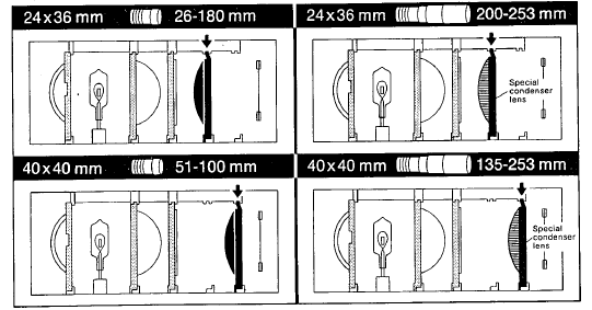

I assume most projectors from the 80s onwards will not illuminate 4x4cm images.
Worst case scenario is they tend to crop the corners off. Some require a slight adjustment, eg the 10xx and 20xx series of Kodak Carousels need you to reposition one of the condensers, which is clearly explained in the manual.
I remember them but I never used them.
But these multifunctional projectors are rare...
Though these sketches show that one might give a try at twisting a condenser-half in a given set.
