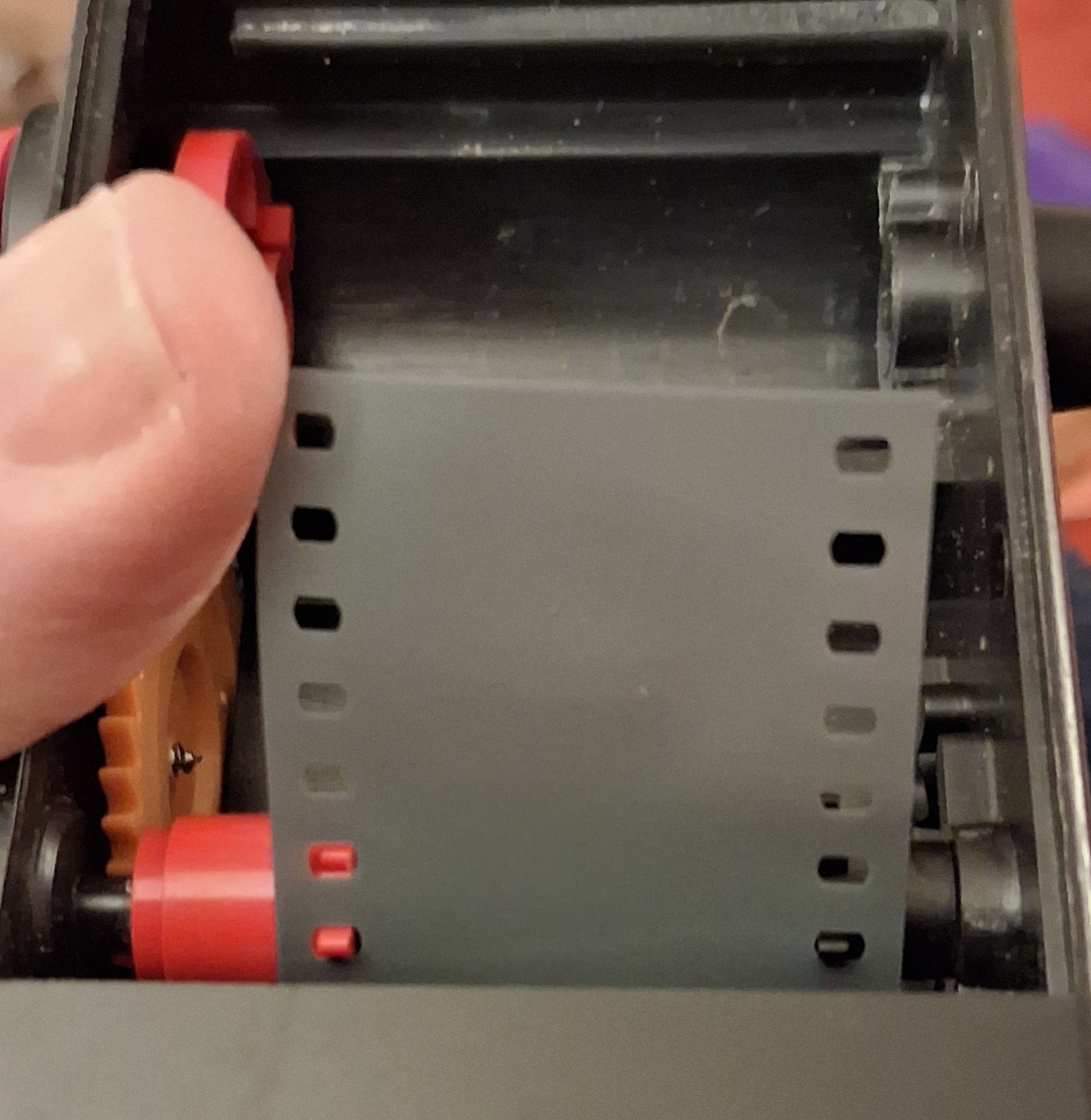

Those certainly look like B&H perforations designed for cine camera transport. It should be "short pitch" film; .1866 inches from top of one perf to the top of the next. Printing stock is .1870 inches and is usually KS perfs; the larger, more square perforations.
Kodak has been putting edge numbers and codes on their film since almost the very beginning, so i doubt it is Kodak. Might be old Dupont, or Ferannia negative. Does the unprocessed film have dark grey emulsion or a more creamy yellow look? It could also be a print or intermediate (finegrain) stock but at those exposure rates you used, that's probably unrealistic.
I agree, unlikely it's a release or print film if it gives images at EI 25, never mind 50. The fastest release positive films I know of are ISO equivalent 12, and most are slower than that.

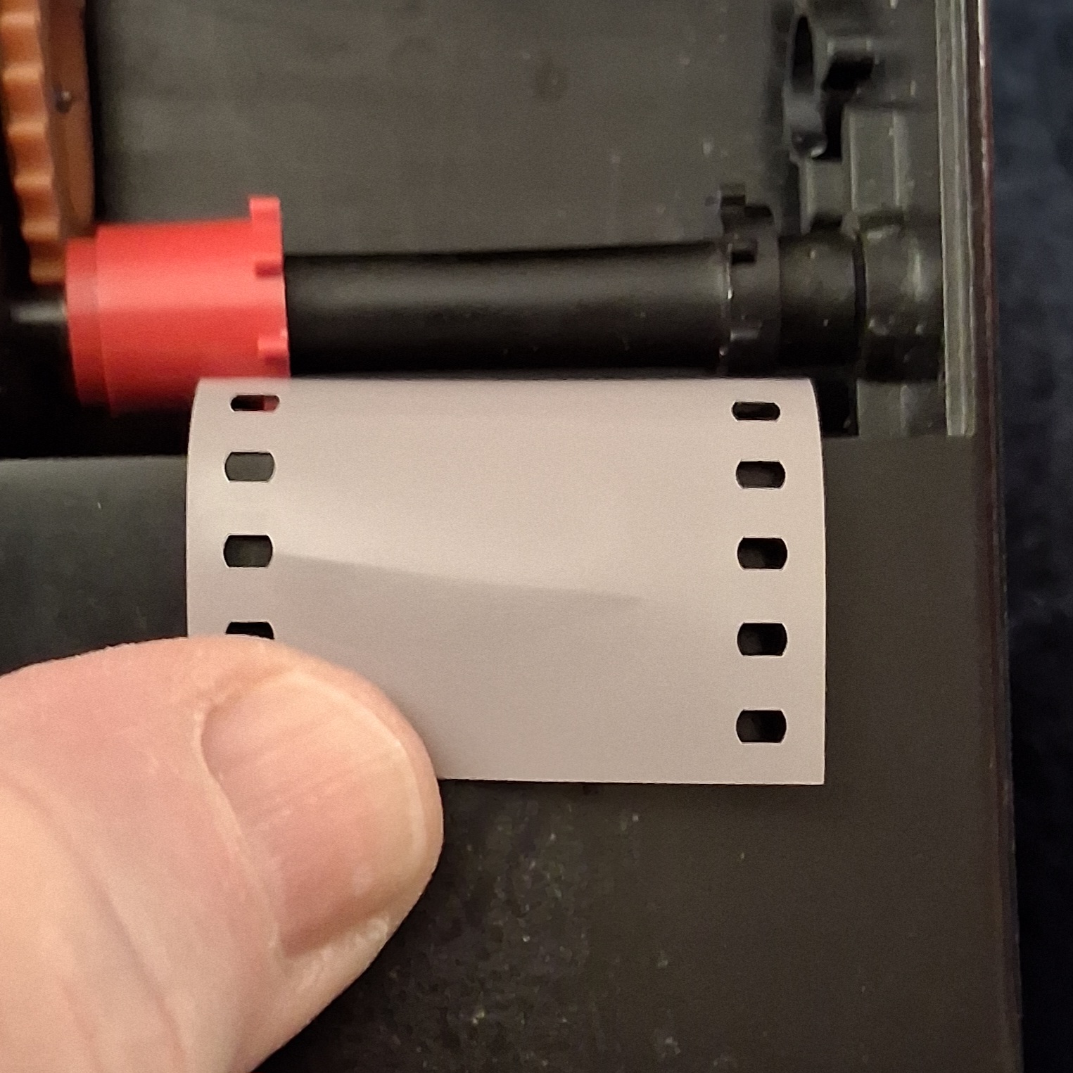

This is the unexposed film. Does that help?

Unfortunately, the emulsion color isn't conclusive beyond the fact that is probably not an intermediate stock with the integrated film dye to combat refraction.
Perhaps Tasma or Svema? Judging by the suggested date the film was placed in the bulk loader, it might have been one of the last runs from Svema and those tended to be sold here in the USA under generic names by places like Freestyle and independent film sellers. Stocks of Svema were sold long after the closing of the last coating line, so... Who knows?
The fact that it was initially wound wrong reinforces the idea of it being cinema film, as many cameras required the film to be wound EO (emulsion out) rather than EI (Emulsion In).
You will probably never be able to firmly establish who made it unless a stray edge marking suddenly appears somewhere in the roll.
