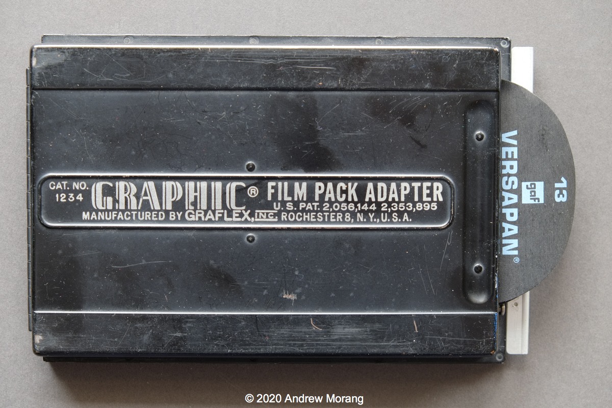

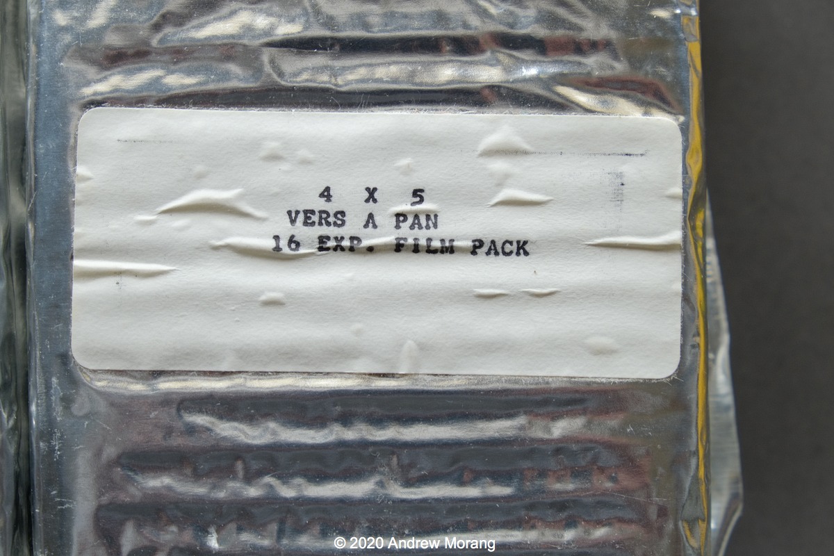

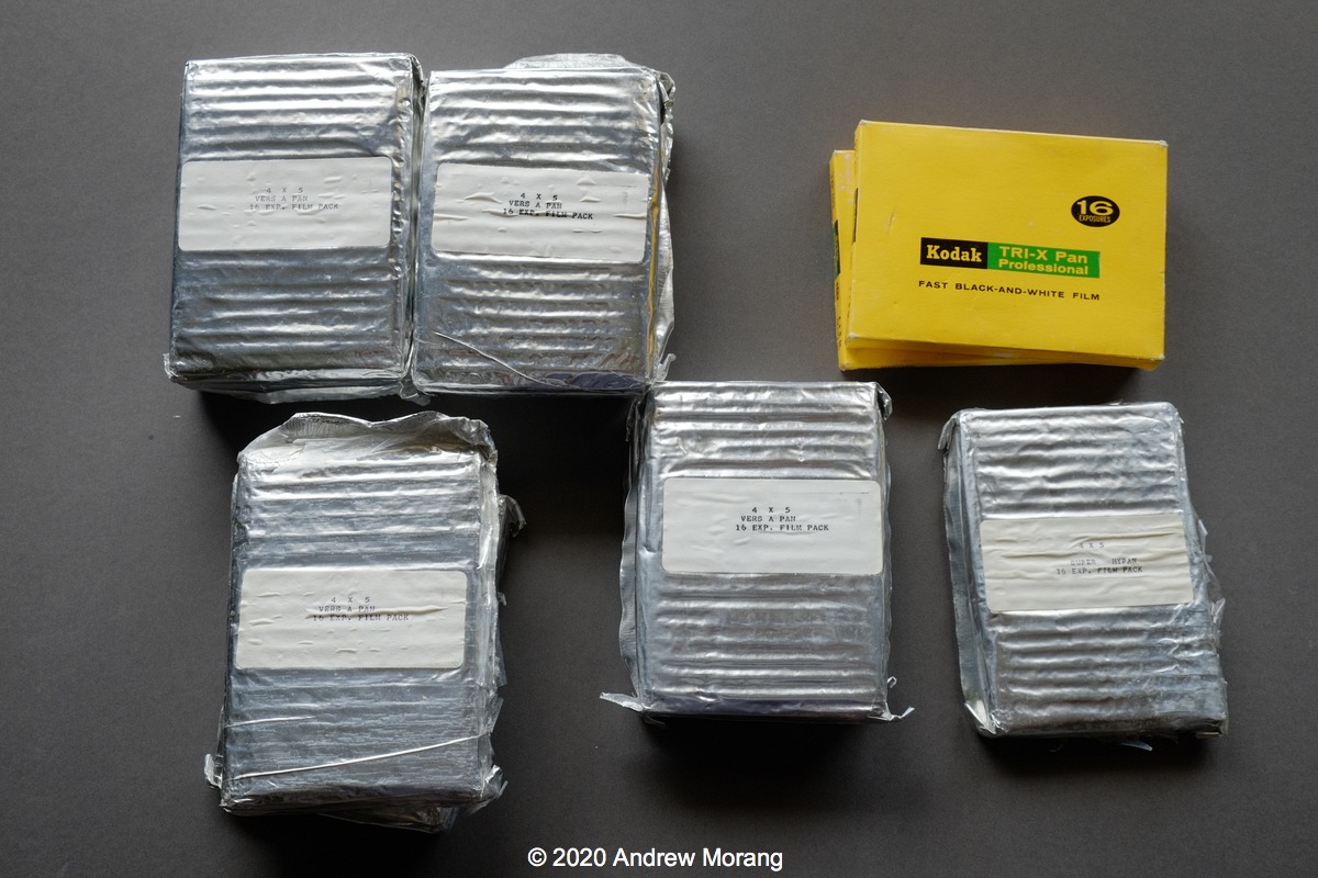

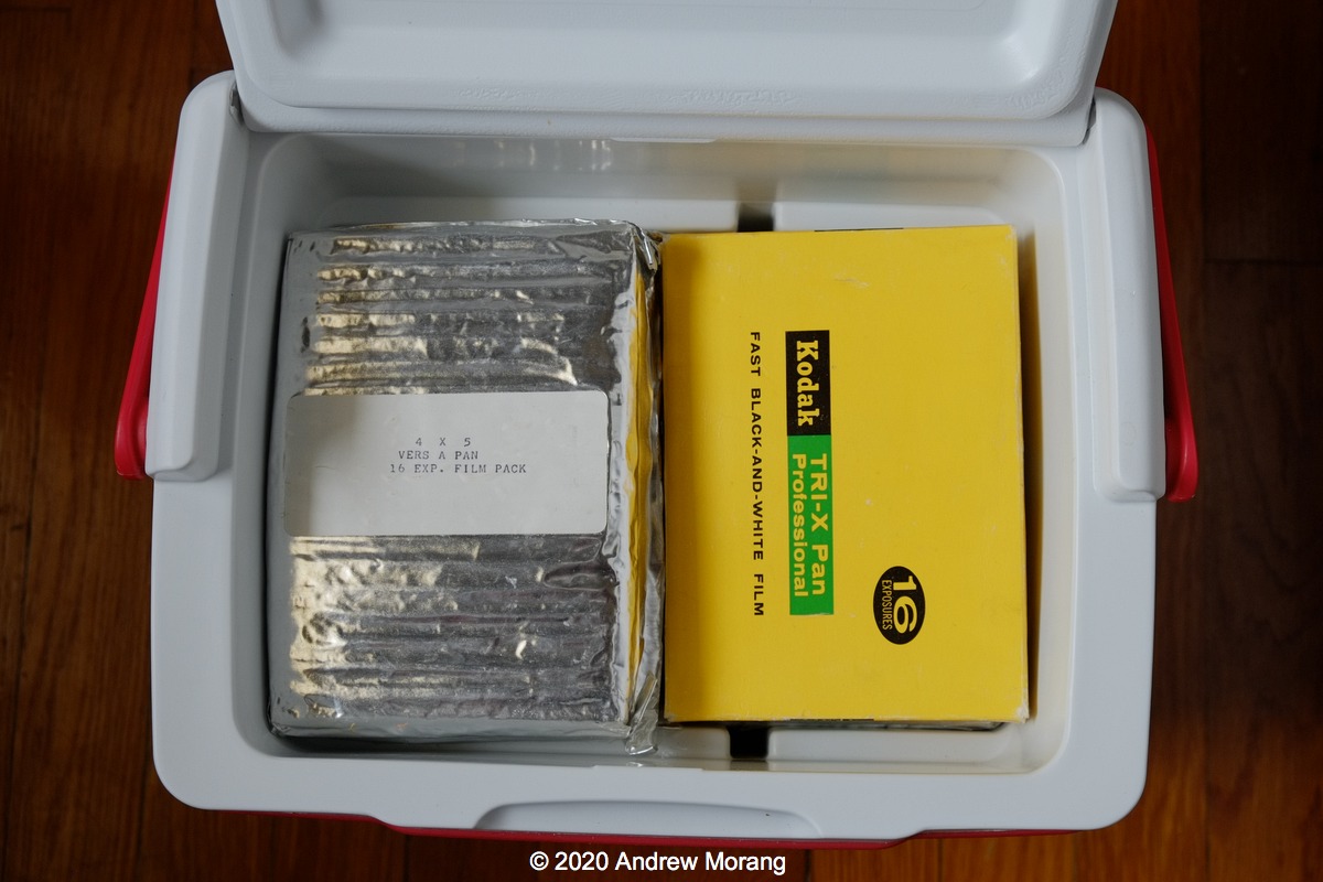

Hi Folks, this is really odd: A friend in town asked me if I wanted a few 4x5" filmpacks (very generous offer). Come to find out, a "few" meant an entire cooler. Most of the packs were GAF Versapan. He had frozen them for 4 decades. My friend said the last time he used any was about 15 years ago and it looked fine. He exposed at EI=125 and developed in D76, but did not remember the time.
Have any of you developed any Versapan recently? If yes, what EI and what developer and time? I saw an older thread where someone said, "I would try D-76 straight at 7 to 8 minutes, HC 110b at 5 minutes, or D-76 1+1 at about 11 minutes at 68f all." But I did not see a followup whether this worked. AgX wrote a detailed summary of the convoluted history of GAF photography products (Thanks). I vaguely remember GAF films from the 1970s but may not have ever used any.

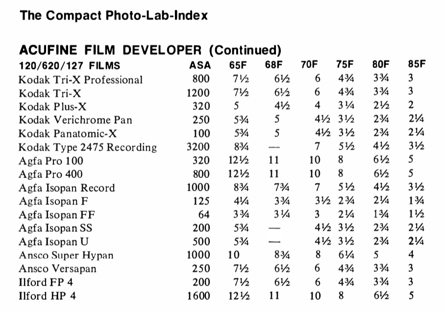

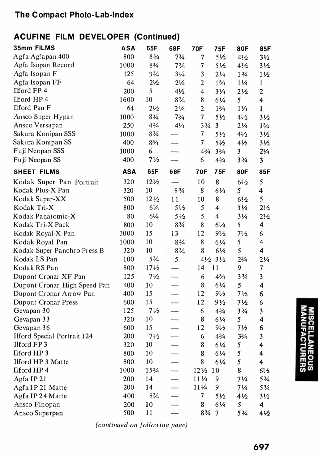

Somewhere on the internet I recently downloaded a copy of the Photo-Lab Index from 1979. That compiles a number of developer manufacturer's recommendations for various films, and a couple of the smaller developers list times for Ansco Versapan. In particular, Edwal FG7 and Acufine. You may not need/want to seek out these developers, but roughly speaking, their EI and times are like Ilford FP4 with a little shorter dev time. Obviously, I have no personal experience, but that could be a place to start. (The Acufine EI is likely optimistic, especially for old film - Acufine always claimed it was a speed boosting developer.) Here are two relevant pages, unfortunately they don't list Versapan sheet film. Click to enlarge.

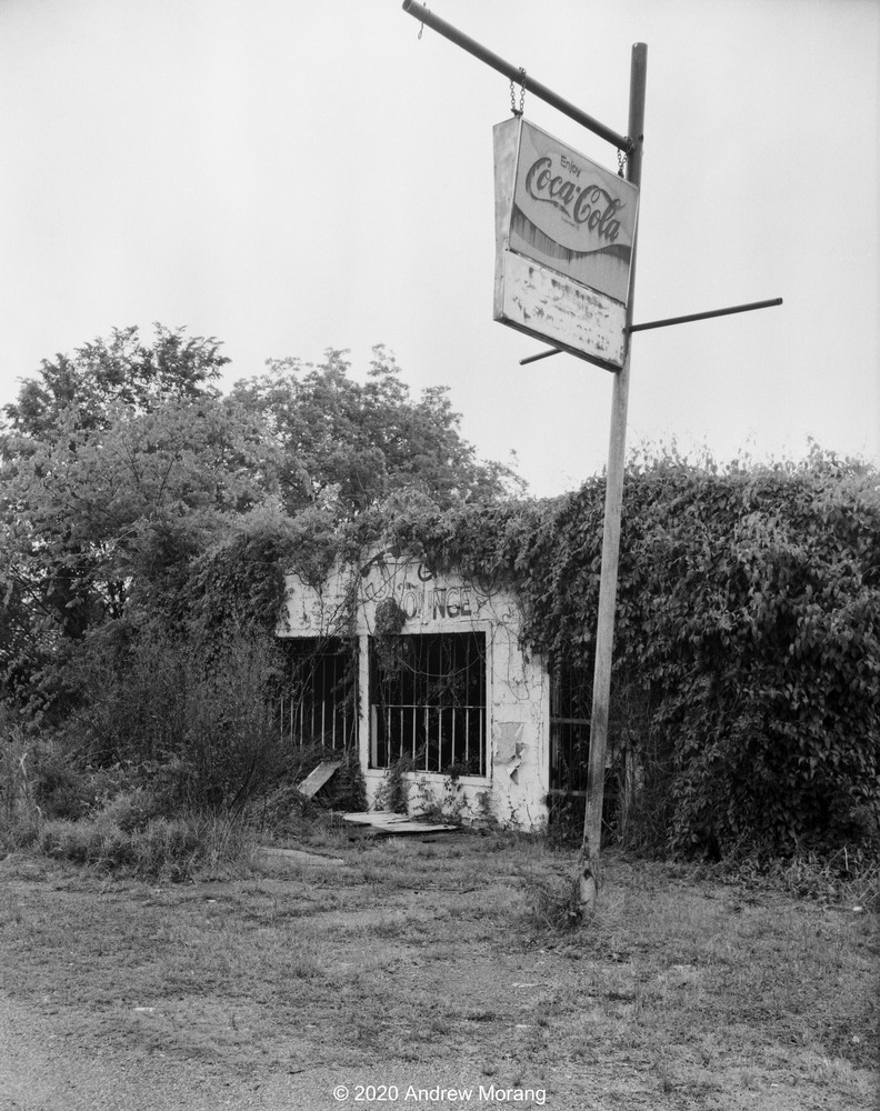

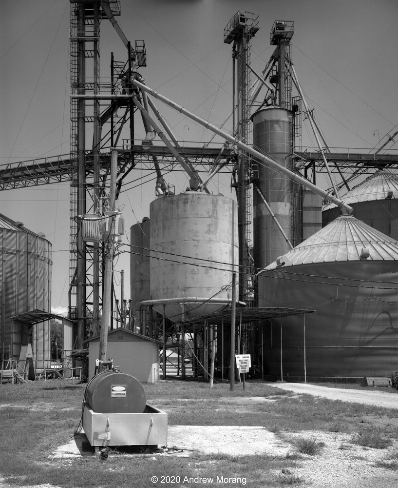

Hi Everyone, here is an update. Results: Amazing, especially for 40-year-old film. In fact, it is fine-grained and very nice.
I sent the filmpack to Northeast Photographic, one of the advertisers here. Mr. Sperry developed it in Xtol.
The film is just stiff enough to lie in the 4x5 holder on my Epson 3200 Photo scanner without sagging. The size is a bit larger than normal 4x5, so I trimmed each frame using two old 4x5 Tri-X sheets as a template. I used the Epson scanning software, which is not too sophisticated, and scanned at 2400 dpi 16-bit grayscale, saved as uncompressed TIFF files. Then I cleaned spots and lint with Photoshop CS5 and did minor adjustment with the curve tool. These examples are 1000 pixel jpeg files with minor sharpening.
For my next experiment, I will take frames in sunny conditions. I want to see how the sky reacts to yellow, orange, or polarizing filters. The examples below are from overcast days in the Mississippi Delta.

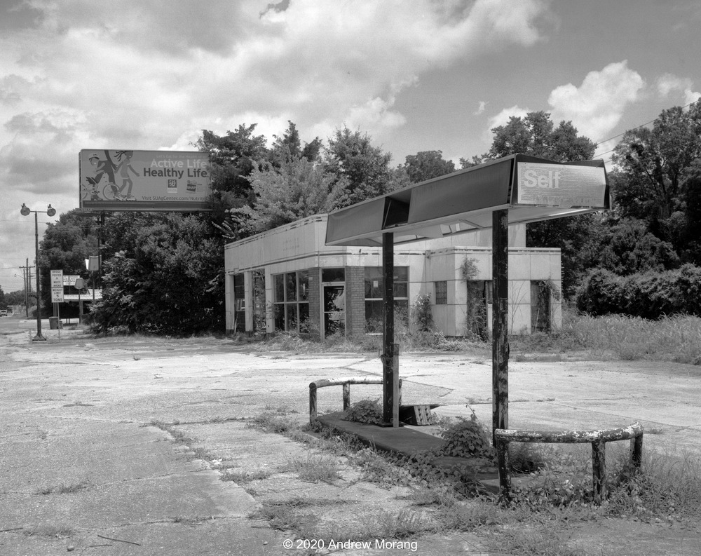

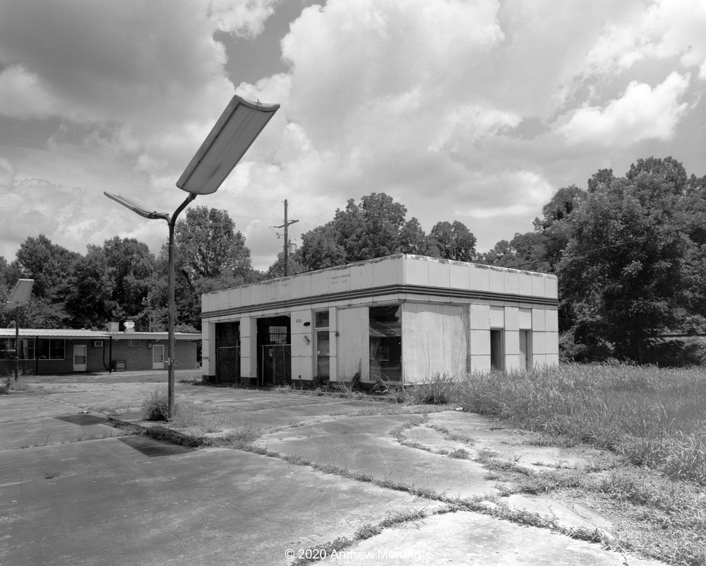

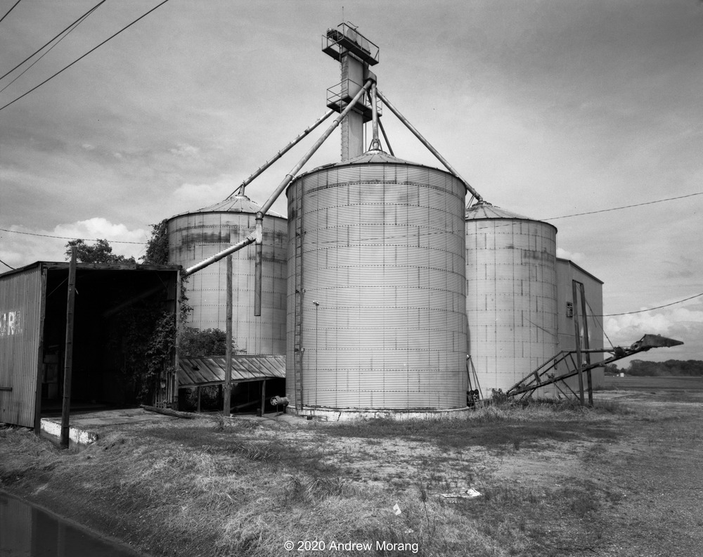

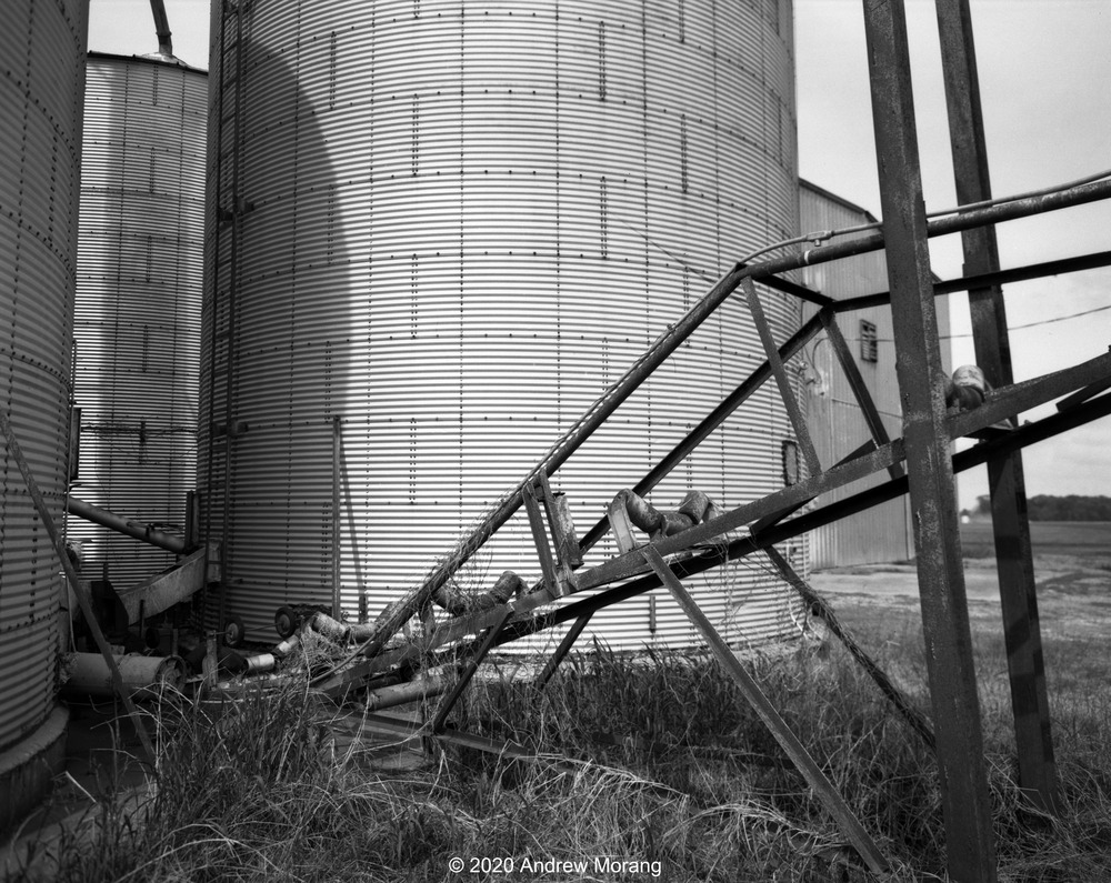

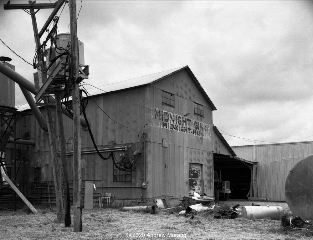

UPDATE August 2020: Film pack 2 came back from the lab. Again, I am pleased. Consider, this is 50-year-old film.
Here are two abandoned gas stations in Delhi (DEL-high) Louisiana.
Here is a silo complex in Waverly, Louisiana. It was 35 deg. C; it's a chore fiddling with a 4x5 in that heat. There was some irregular development near the top, so I had to crop a few mm of the frame.
Impressive results, really like the Gas stations in here pictured.
I come from another thread of the Kodak Film pack tank and today, after so many years of lurking around here and reading large format, I get to know about the existence of them. I was however, acquainted of Grafmatic.
16 4x5" exposures, just like the bygone 220 in 6x9 (or 2¼ x 3¼).
