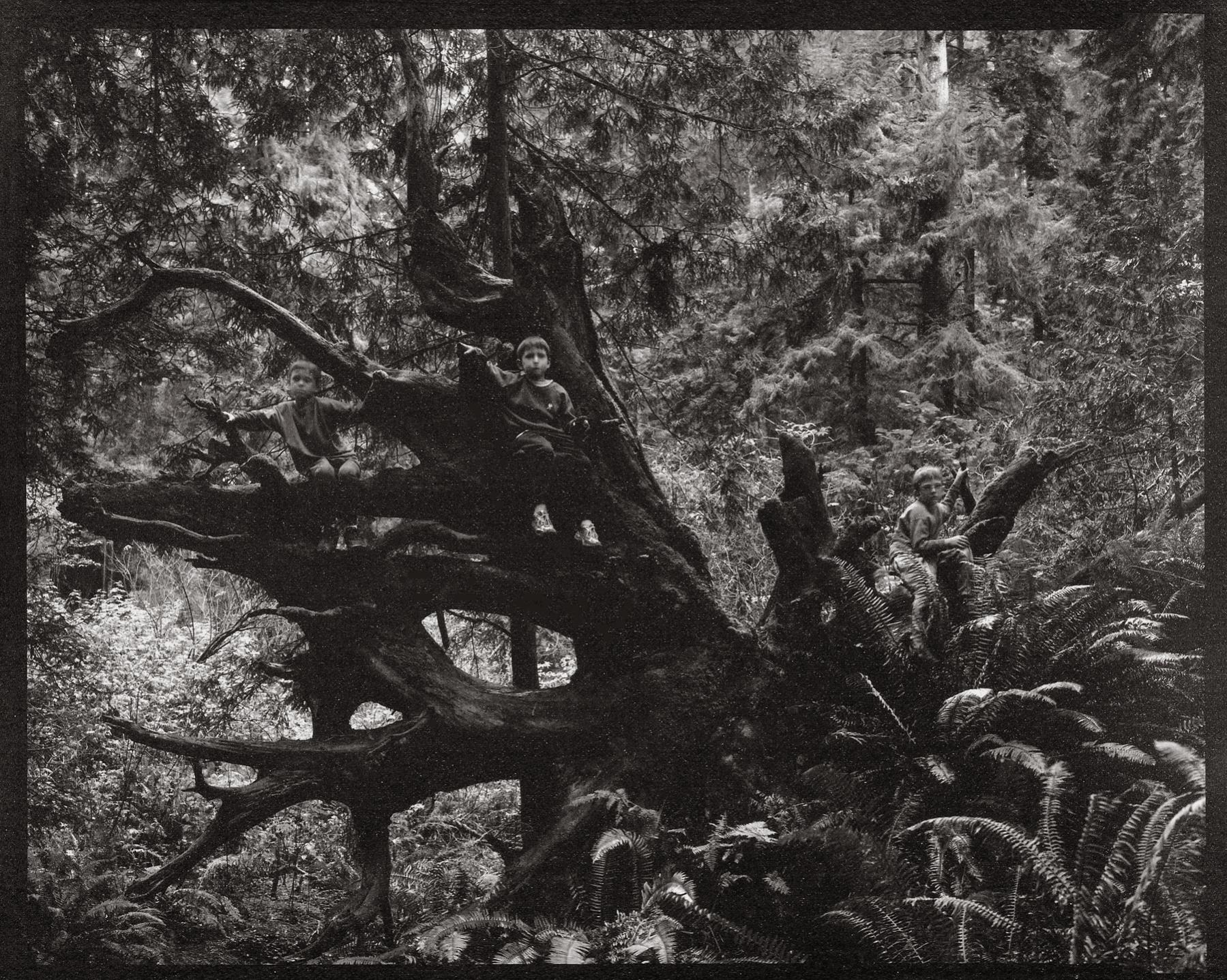

Bummer! I do have this image of some young Bigfeet (Bigfoots?)...8x10 platinum print
Nice print!
I do Ziatypes and I admire your skill. You've got your process dialed in. Is this a hybrid neg?
I use in-camera negatives. The beasties have to hold still for 30 seconds or more in the redwoods (the longest was a 2 minute exposure). If my memory is correct, the image was taken on Ilford FP4+ and developed in Ilford PQ Universal developer.
My negatives are exposed and developed for the particular process they'll be printed in. Negatives for platinum/palladium prints are processed to use no contrast boosters in the coating solution or in the developer. If I wanted to make a carbon print of this scene, I would have given the film more development to increase the contrast even more. Sometimes I blow it and give the film too much development for pt/pd -- those negs often can make fine carbon prints! LOL!

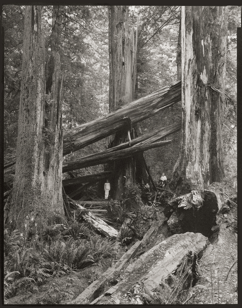

This is an 8x10 carbon print -- this is the one they had to hold still for two minutes...

You're just like those photographers that shoot and process for graded paper
I don't think I don't have my film process dialed in so I can print from my LF negs. I use my computer and make digital negs which is easier and cheating. It's amazing that you don't tweak the contrast of your PT emulsion to fit the contrast range of your neg. I've heard you can use different PT print developers to adjust your contrast. For Ziatypes, dichromates are used to adjust contrast and it's just too toxic for me. I'd rather use digital negs to tweak the contrast. Hat off to you!
That is why I was hoping I was not taking things off-topic. When I was teaching myself carbon printing it took about two years of making prints before I got the negative characteristics and the carbon printing process to a point where I was getting images I wanted. I might have done it in half the time if I did serious testing...but I do not like testing. Testing is great if you have an end result in mind, but since I had never seen a carbon print and did not know what they were 'suppose' to look like, I was just making carbons and judging the results from the qualities of the print. I found a raised relief in the wet carbon prints (that disappeared when dry) and started to tweak the negs and process to give me that relief in a dry print.
When my triplets were born I taught myself platinum printing because of the time-suck of carbon printing (I was a SAHD). I approached it the same way -- getting the negs and the process to line up to my vision. In any case, I have a lot of negatives that are not fit for printing and many many not-quite-good-enough prints. But every printing session was a learning experience, and one just has to get use to the fact that one might have several 12-hour printing sessions in a row and have no 'keepers' to show for it.
