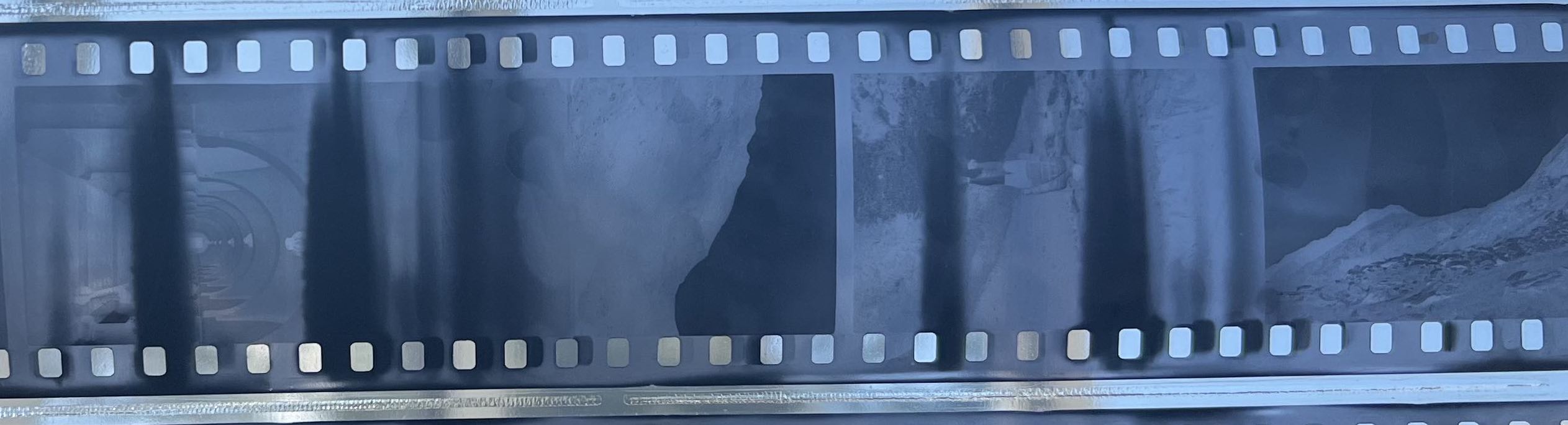

Anyone know what's worng with my film?

Those vertical "stress" marks are indicative of film being rewound backwards. I saw this hundreds of times when running a semi-pro lab on C41 film, although these were magenta on the film, thus printing as lovely green stripes. I've never been able to work out how users do this, but given I've witnessed it so many times during my mini-lab career, it's obviously easier to do than one might think.
The edges of the film look fogged - but I've never seen this with film that has been stressed, unless the can was leaking light, or a light leak in the camera - perhaps the film window foam is failing?

It's a Canon AE1P - no window.
It would be easy to rewind the film the wrong way. Just turn the crank the wrong direction - it's something anyone could do every now and then, if you're not paying attention.
I think I'll rewind a strip of HP5 backward in a Canon AE1 (if I can find one) as a simulation.

yeah that's i do. I've test it with some junk film and find to rewind i should turn clockvise but i turn counter clockwise
Um just let u guys know i just shoot another roll of film. Same camera, same tank, also hp5 and the same chemicals. nothing is wrong. I've just found out that i rewind the film in the wrong way, which explained the stress marks. Also, i would like to ask if the black marks is caused by the stress marks?
Some will say yes, some will say no. The black marks look to me like someone opened the camera back with the film not rewound.

Do you use fresh film or do you bulk load with reusable cassettes?
If the latter, I suspect the end caps are failing and not sealing well, thus letting some light in along the edges. I don't recall seeing this type of edge marking when we processed customer's C41 films, that were stressed, however, that's not to say it isn't the cause.
Given you've discovered incorrect handling has caused the major issue, I wouldn't worry about the edge issues. You have eliminated this when you processed the new roll, after rewinding correctly. Should it appear again at a later date, deal with it then. Life's too short to worry about something that didn't happen when the correct processes are followed.
You have learned something that I can guarantee you won't do again - just rewind in the direction of that little arrow on the rewind handle and that AE1P will continue to serve you well.

I vote that the black rectangles between sprocket holes are caused by light exposure.
When the film is wound the sprocket holes in the various layers of the wrap may not (or may) line up. Light exposure on the outside of the wound film goes through the sprocket holes on the outside wrap and exposes the area between sprockets in the wrap below. If the wraps kinda line up then the light will go through both sprocket holes in the outer wraps and expose the film in the third wrap - this causes the black rectangles to shift in size. Eventually the black marks disappear as the light is eventually blocked. Inner wraps where the light is only blocked by one layer of film may have grey marks - depending on the film transparency and sensitivity, of course.
There should be frames with stress bands across the film but without the black rectangles.

This was a leaky cassette of home-rolled film. It doesn't need to be bulk-rolled for the cassette to leak, though (the bar-coding makes me thing of factory processing).
Above, you see the sprocket ghosting, streaks, I think this is bad felt, the edges are not particularly fogged.
