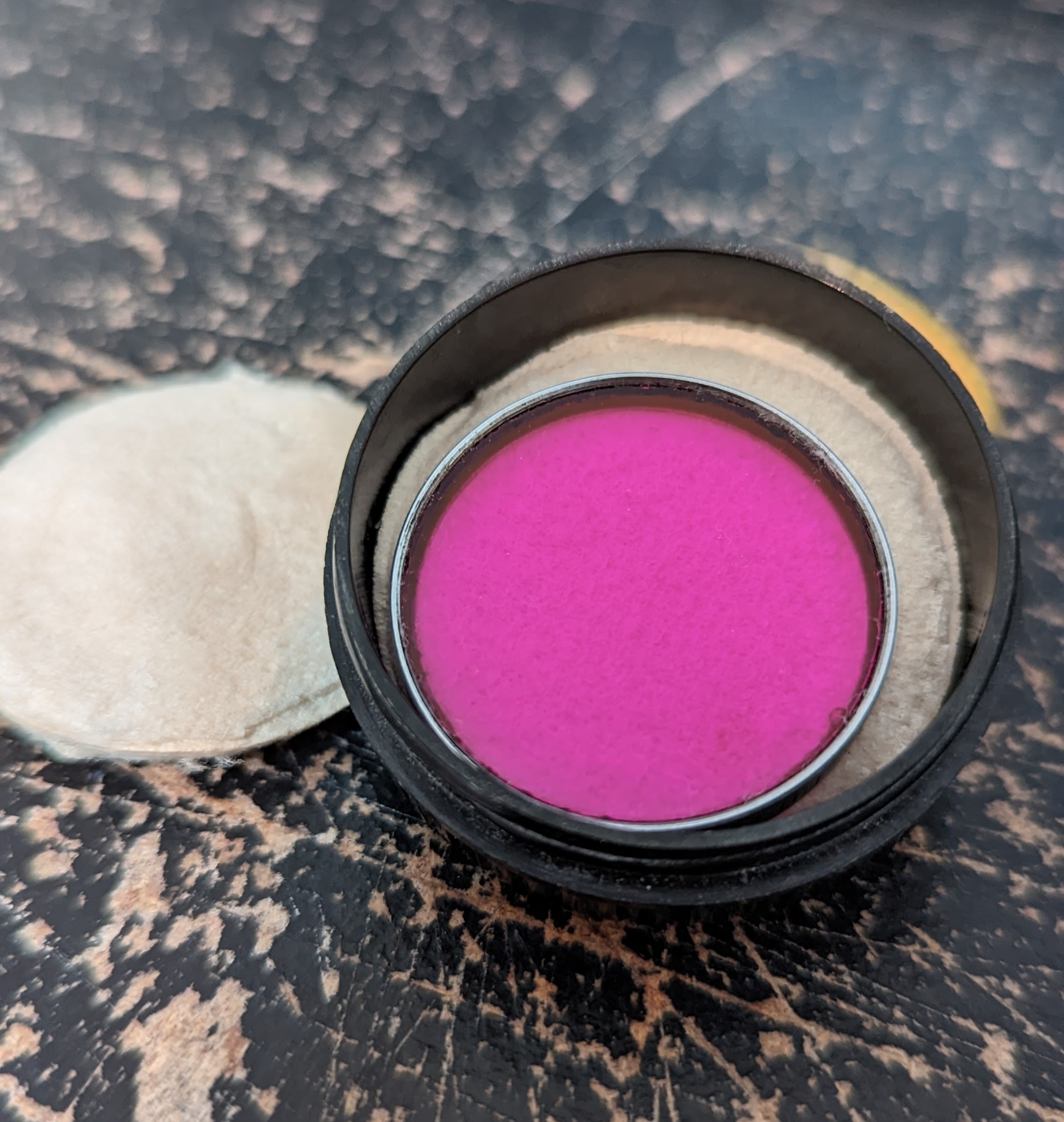

I bought this filter some time ago at a garage sale, its the "Kodak Series V MC1" filter. Does anyone know what it's for and the filter factor? I attached an image of the filter, its pretty darn pink, so I'm thinking it might be for some sort of contrast effect?

It is, of course, a Series V filter, which means it is the correct size to fit in a Series V holder.
If you are not familiar with the Series approach to sizing of and fitting filter, this article will give you an idea: http://camera-wiki.org/wiki/Series_filters

Yes, that article did come up during my search online, but I have yet to find any information regarding this specific filter and its intended effect on film.

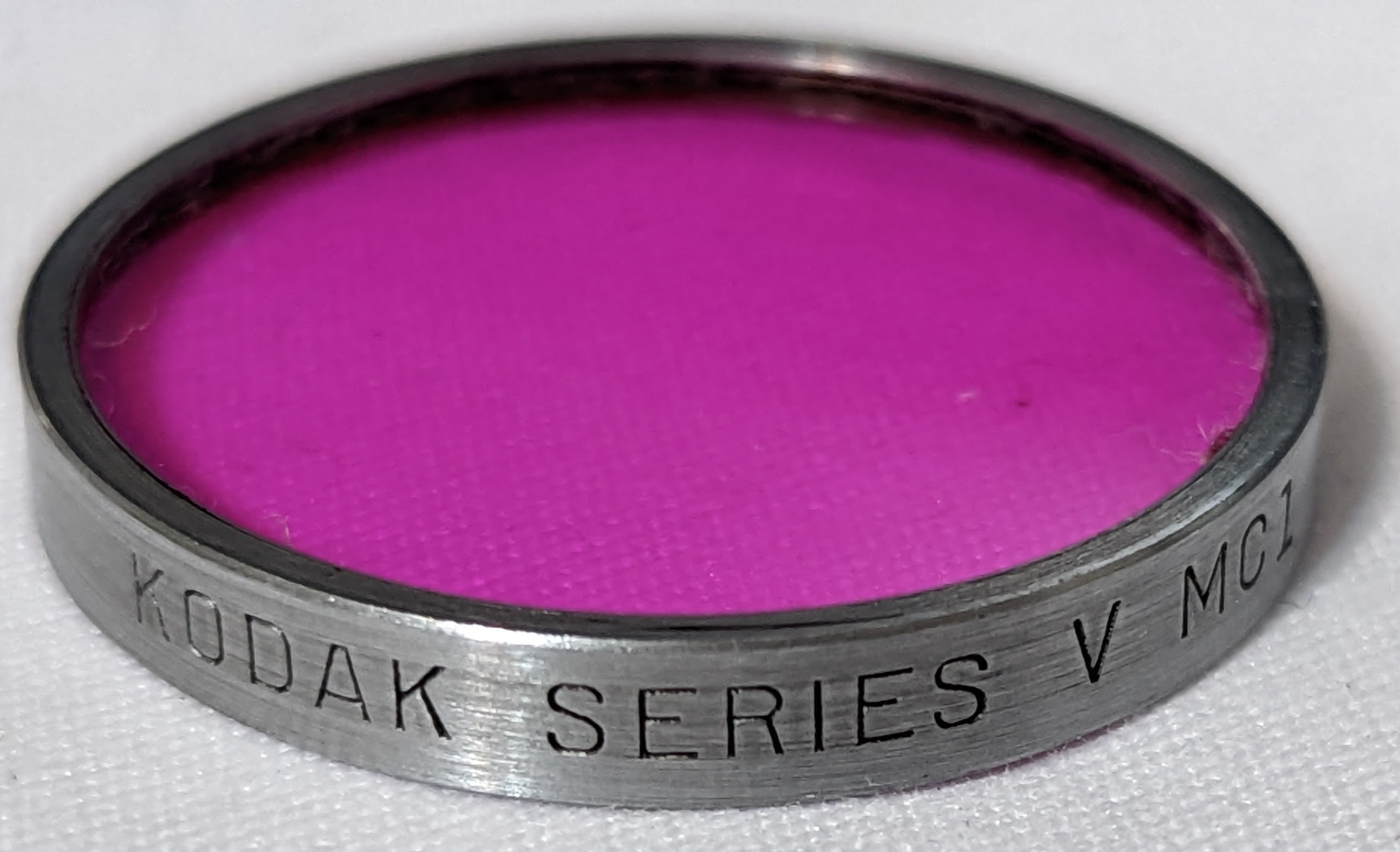

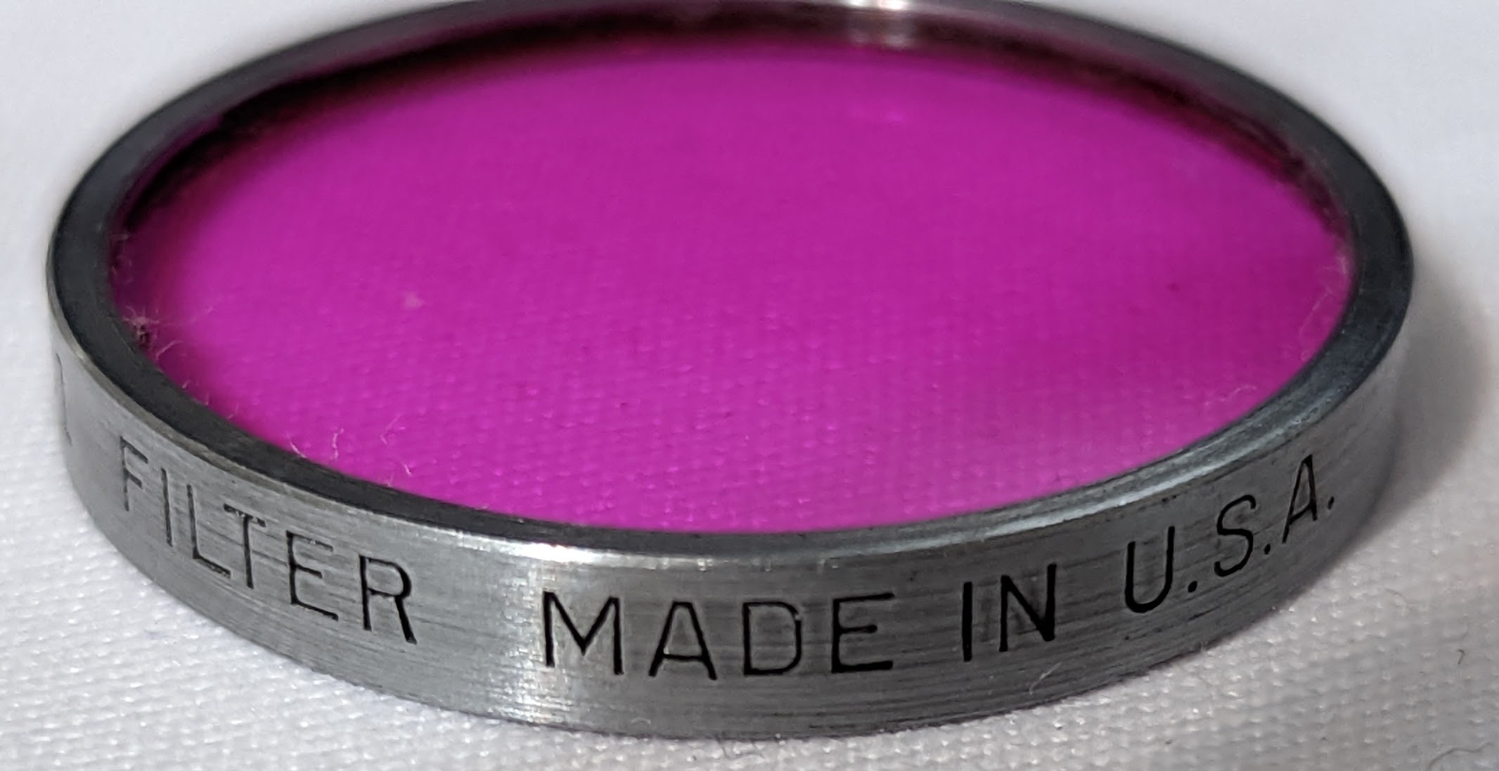

May we see the edge writing or other insignia on it?

Yes, of course. Attached are the only edge writings on the filter.

It's a Multi-Contrast filter. That's what the MC stands for -- for Kodak MC paper.
