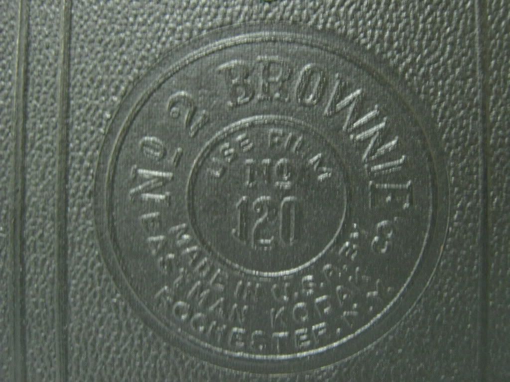

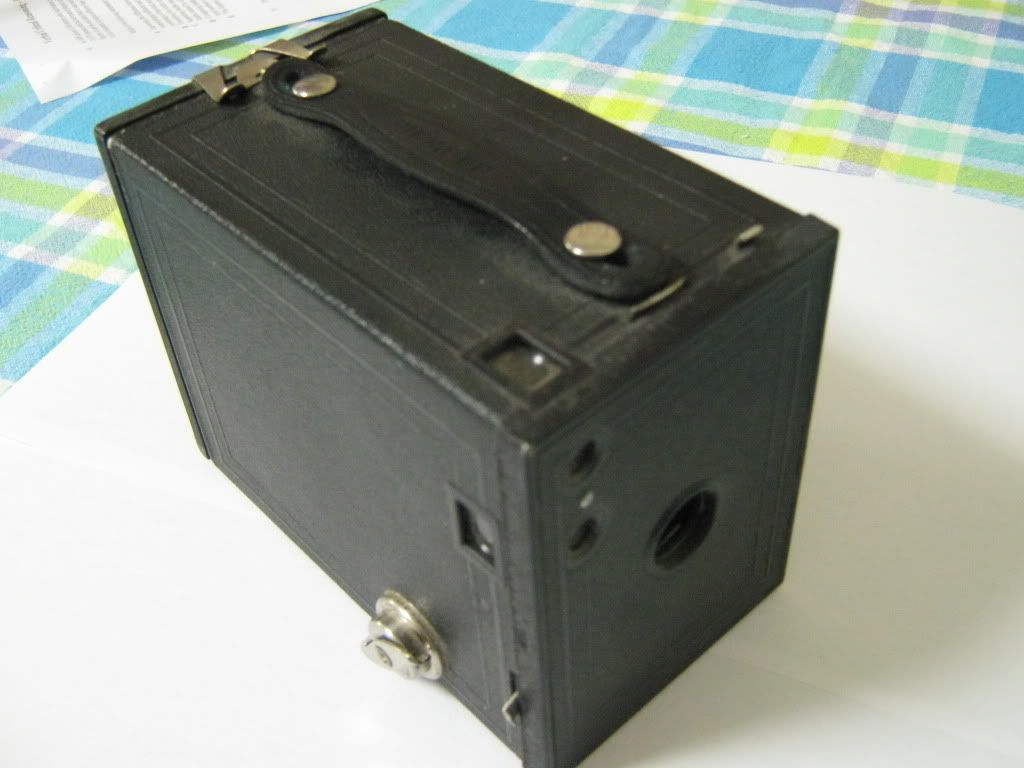

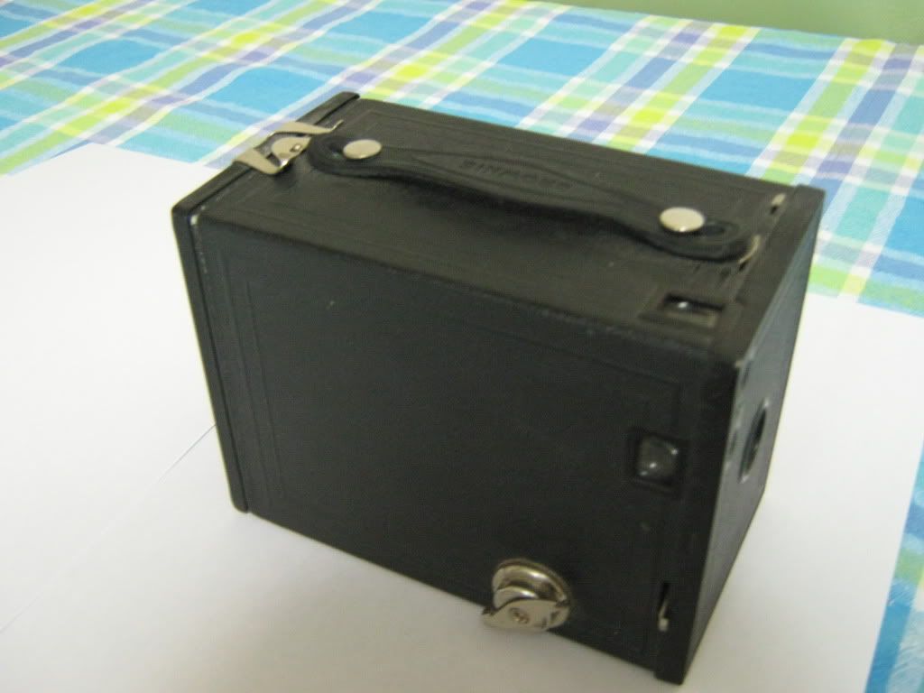

Hey....my dad found this at his mothers place.... it looks pretty old.
Anyone know what year it was produced?
Its a box brownie apprently. Takes 120 film. Anyone know how to work it.
Its a number 2 Brownie, model F.
Is it worth anything?

McKeowns says $1-$10. Made from 1901 to 1933. Since yours has the grainy covering it was not one of the early models. Shots 2x3; If it would have had the colored cover it would be worth about $40. From the pics, it looks like a nice example.

As you mentioned, this is the No. 1 Brownie Model F. It should have an aluminum body covered with imitation lever. This model was made between 1924 and 1933 and cost $2.75. Cameras with removable backs were made from 1924 to 1925, and those with hinged backs were made from 1927 to 1933. Not sure what happened between 1925 and 1926 -- my book doesn't explain that.
Earlier No. 2 Brownies were made of cardboard, and later cameras were offered in blue, brown, gray, green or red.
There's not a lot to using this camera. Load the film, wind to No. 1 in the red window. The shutter release is the small lever on the side.
There is no focusing. To frame your photo, use the little viewfinder on the top for portraits and on the side for landscapes.
Take your photo and wind to the next frame.
This was part of Kodak's effort: "You press the shutter release. We do the rest."
