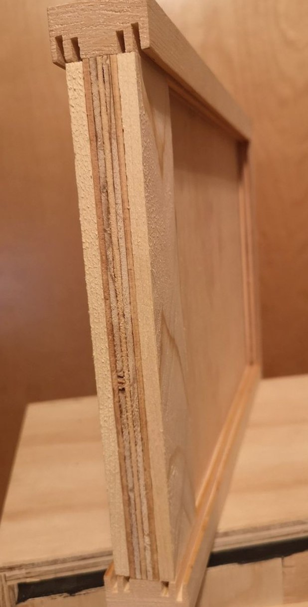

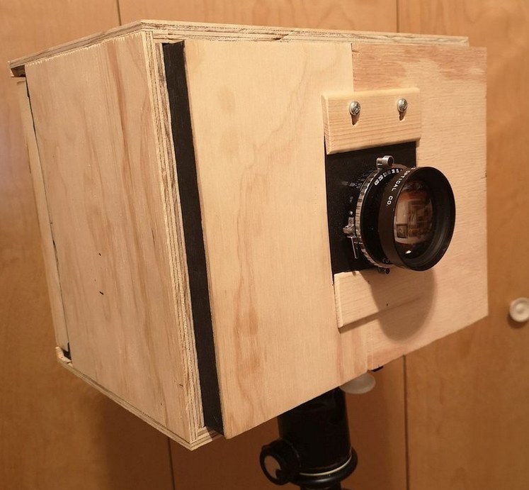

Here's how I built my sliding box 8x10 camera. It cost around $10 or so.
You'll need: 1/2" plywood, a 2x4, white glue, clamps, and a table saw.​

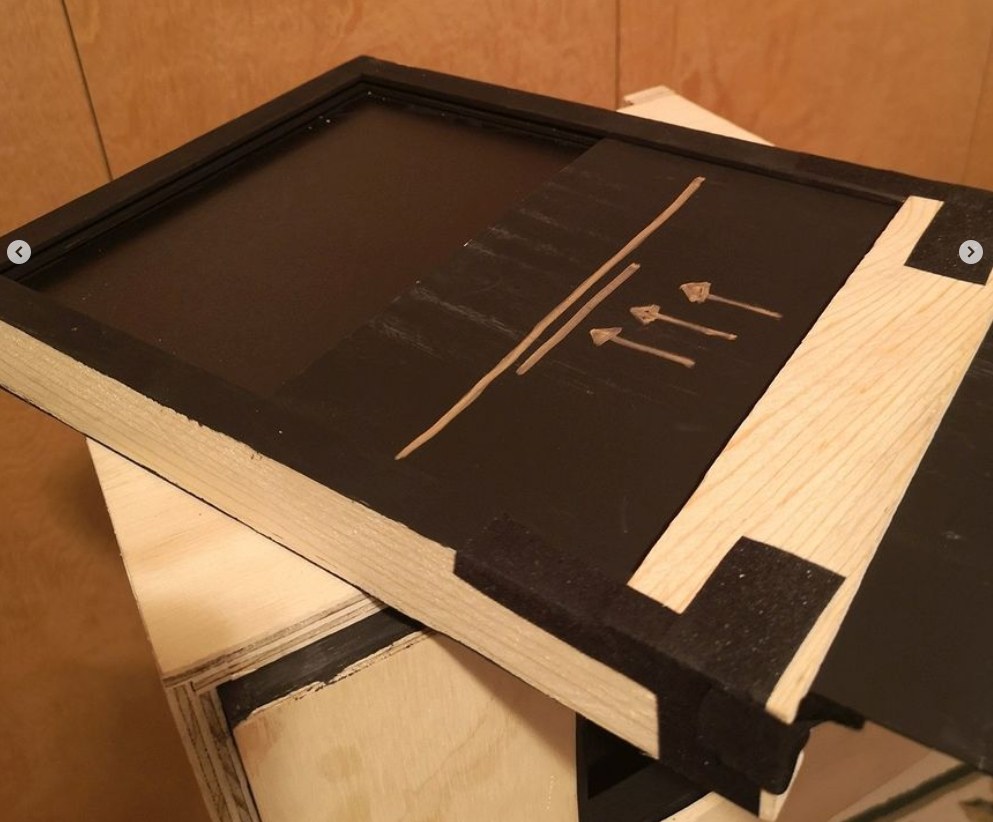

I made the film holder first, so the box could be built around it. It ended up being 9 1/8" wide (standard is 9 1/4") because of the way I chopped up the 2x4 wood. I used a table saw to cut 1/4" grooves into the wood around 1/16" apart with a 1/2" space between for the film holder body. I cut grooves on both sides of the wood top and bottom, then cut the rail off, then cut that in half to get 2 rails, plus the ones on the other side gave the total of 4 rails. Then, I cut the body of the film holder out of 1/2" plywood (7 1/2" x 11 1/2") and clamped/glued the rails around it, along with some pieces at the film entrance.​
I used mat board for the dark slide, then shimmed the paper well with mat board so the film will be spaced precisely at the top of the 2nd groove. Some cloth tape was placed at the opening along with some felt for light sealing, and a pressure plate was installed on top. This was probably the most difficult part of making the camera.​

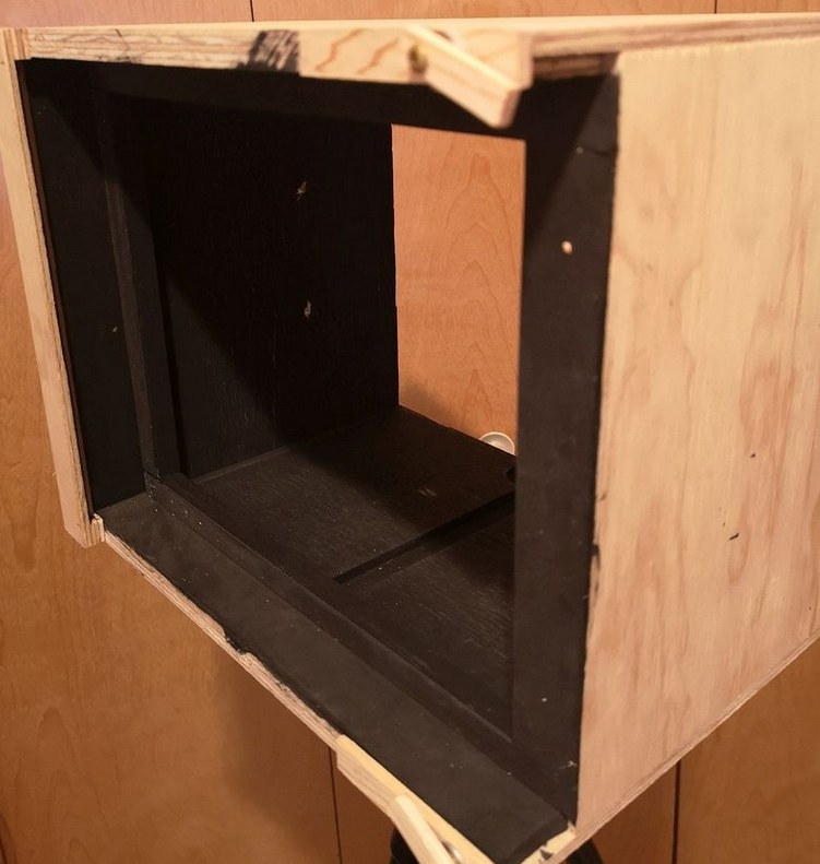

The outer box was cut to fit the film holder (ID 9 1/8" x 10 1/2") and the edges routed to prevent light leaks. The depth of the box is 8 1/2" since it'll be used with a 210mm lens. A 5/8" film holder ridge was glued inside the box at 7" from the front. A retainer was glued to the left side, and retaining levers to the right.​
The inside box was made 1" smaller than the outer and 2" less deep. The lens hole was lined with wood stops on both sides, and a lens retainer on top.​

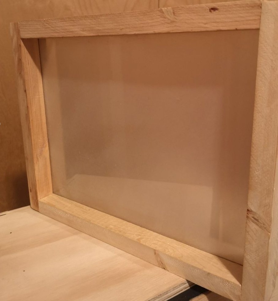

A frame was built the same size as the film holder to hold the "ground glass": 400 grit sanded plastic sheet cover backed with glass.​
I made this to take paper negatives and do b&w as well as RA-4 reversals. It's not a versatile camera--no movements, set focal length, doesn't fold down, but it works and gives me the ability to shoot 8x10. Works fine for portraits, though the 210mm lens means the subject needs to be around 3 feet away from the camera.
You don't need a router--you can cut the corners square and seal the edges when assembling. If I had an existing film holder, I would simply build the outer box around the film holder. You don't have to glue it together--screws would work fine.
