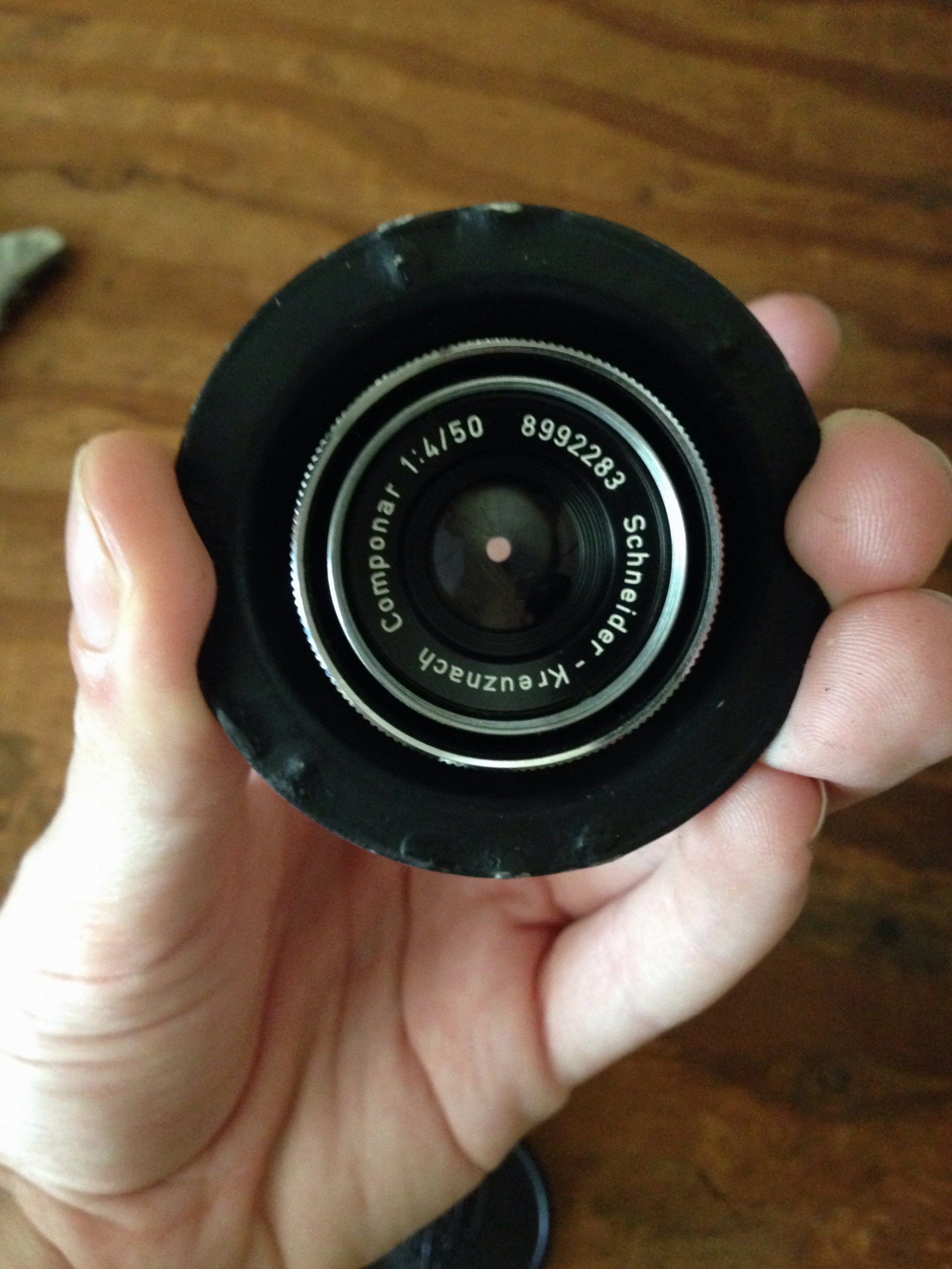

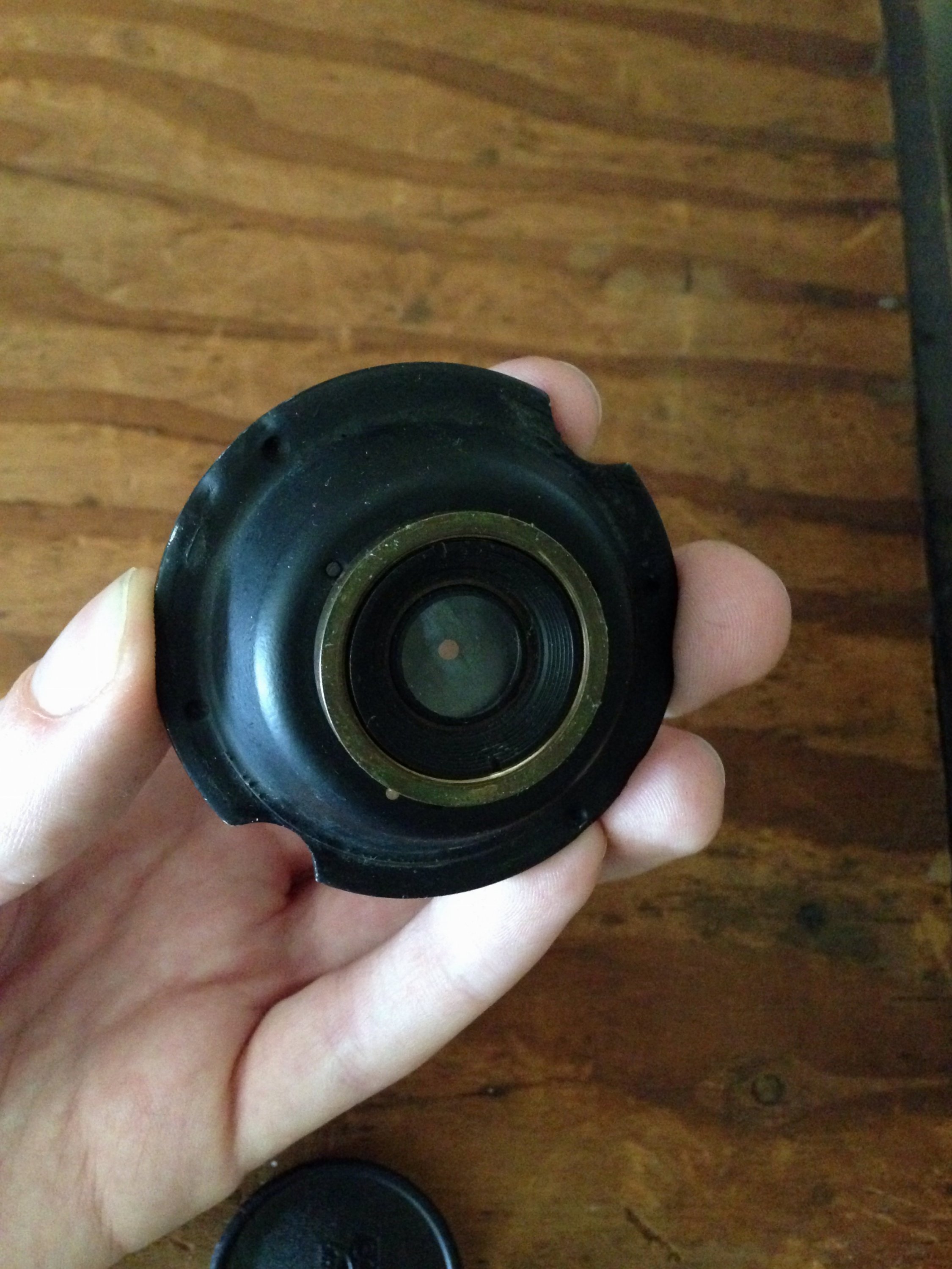

So I won't be able to print mf negs without another condenser? I don't recall seeing another condenser lens at the estate sale, but then again I wasn't looking for one. Do you suppose I could just buy a larger condenser, or would it have to be specific to my enlarger? Could I replace the head entirely?
Lastly, I was looking at the lens and I realized it's a 25mm thread mount. Would I be able to mount M39 lenses onto it? The piece it's mounted to is fit for a M25 lens.

You could find a larger condenser, many Schneider lenses were small thread than 39mm originally, I think 25mm some of mine use adapters to 39mm.
However you'll find a better enlarger for peanuts, don't spend money on this old one. I've had enlargers from our local tip (dump) virtually brand new - I gave them to a couple of Irishmen who run workshops.
An LED head could be made very cheaply.
