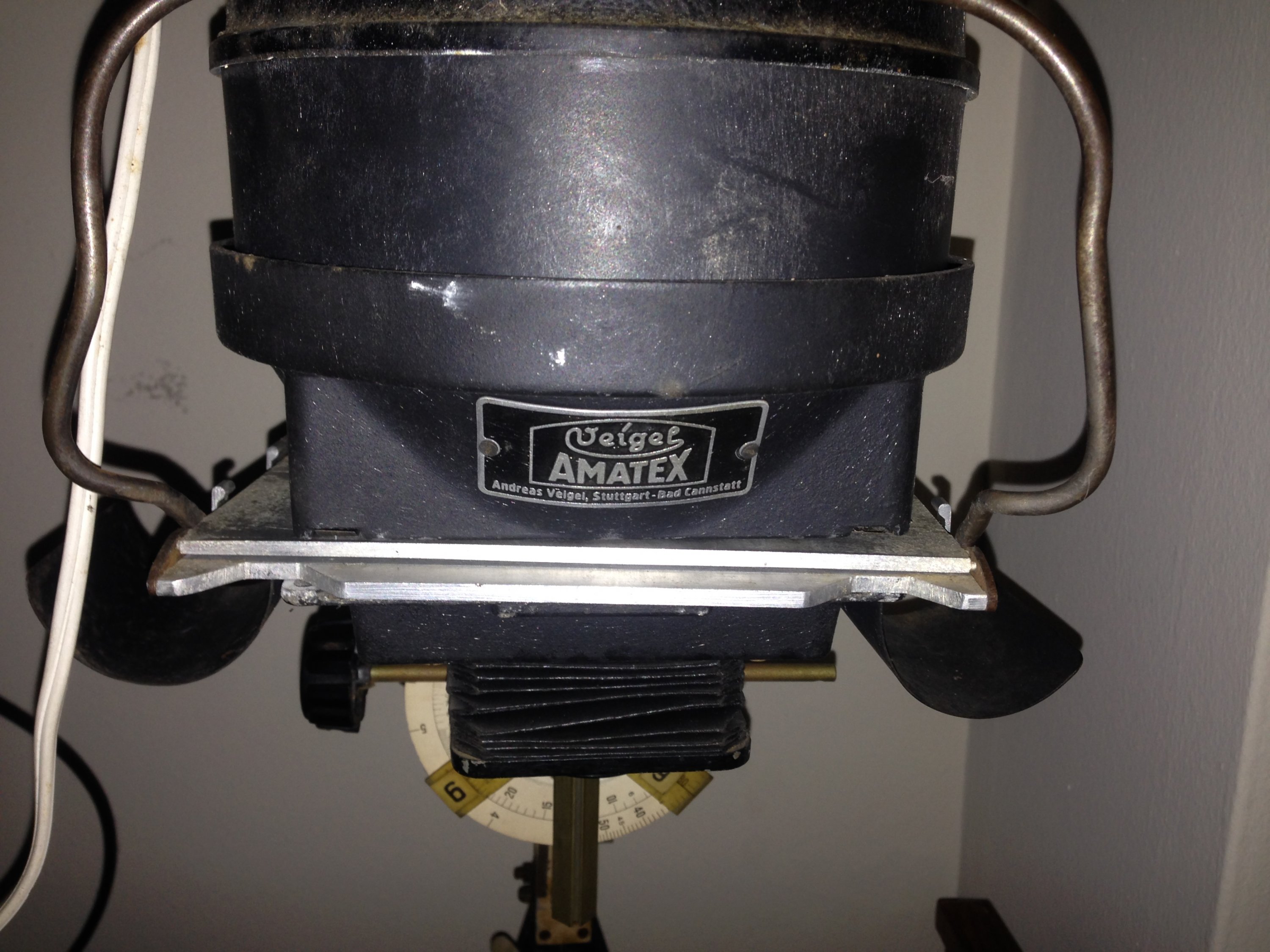

I just bought this enlarger today at an estate sale. It works fine, but the only reference I could find about it online was in Polish, and it didn't say much. The person I bought it from didn't know much about it either, and I don't think it's been used for a long time.
Inside the enlarger was a 35mm negative carrier. I also bought a 6x9 negative carrier which I found in a box that says, "Old sroka neg plate for enlarger." I have no idea what "sroka" refers to. The negative carrier does fit into the enlarger, but does anyone know if it actually can print 6x9 negatives? I don't have a long enough lens to test. Or anything else about the enlarger really. Thanks! I've included a picture.

[QUOTE="graciemansion, post: 1913724, member: 80488. I also bought a 6x9 negative carrier does fit into the enlarger, but does anyone know if it actually can print 6x9 negatives? I don't have a long enough lens to test. Or anything else about the enlarger really. Thanks! I've included a picture.[/QUOTE]
Put a 6x9 negative or similar and see what is projected. It is the internal structure of the enlarger housing and bellows that limits the projection - not the lens. Assuming that the enlarger structure has a 'hole' greater than 6x9 then you should be able to see the full 6x9 projected image using (say) a 50mm lens.
regards
Tony

The hole underneath the condenser lens is the size of a 6x9 negative. Would that be an indication that it could print them? By the way I hope I'm explaining this correctly. I'm not too familiar with enlargers.
AgX
Apr 5, 2007
29,973
Germany
In theory there still could be a condenser installed that would not cover that format.
But to my knowledge in that period MF enlargers only had one condenser system.
Thus your assumption seems valid to me.

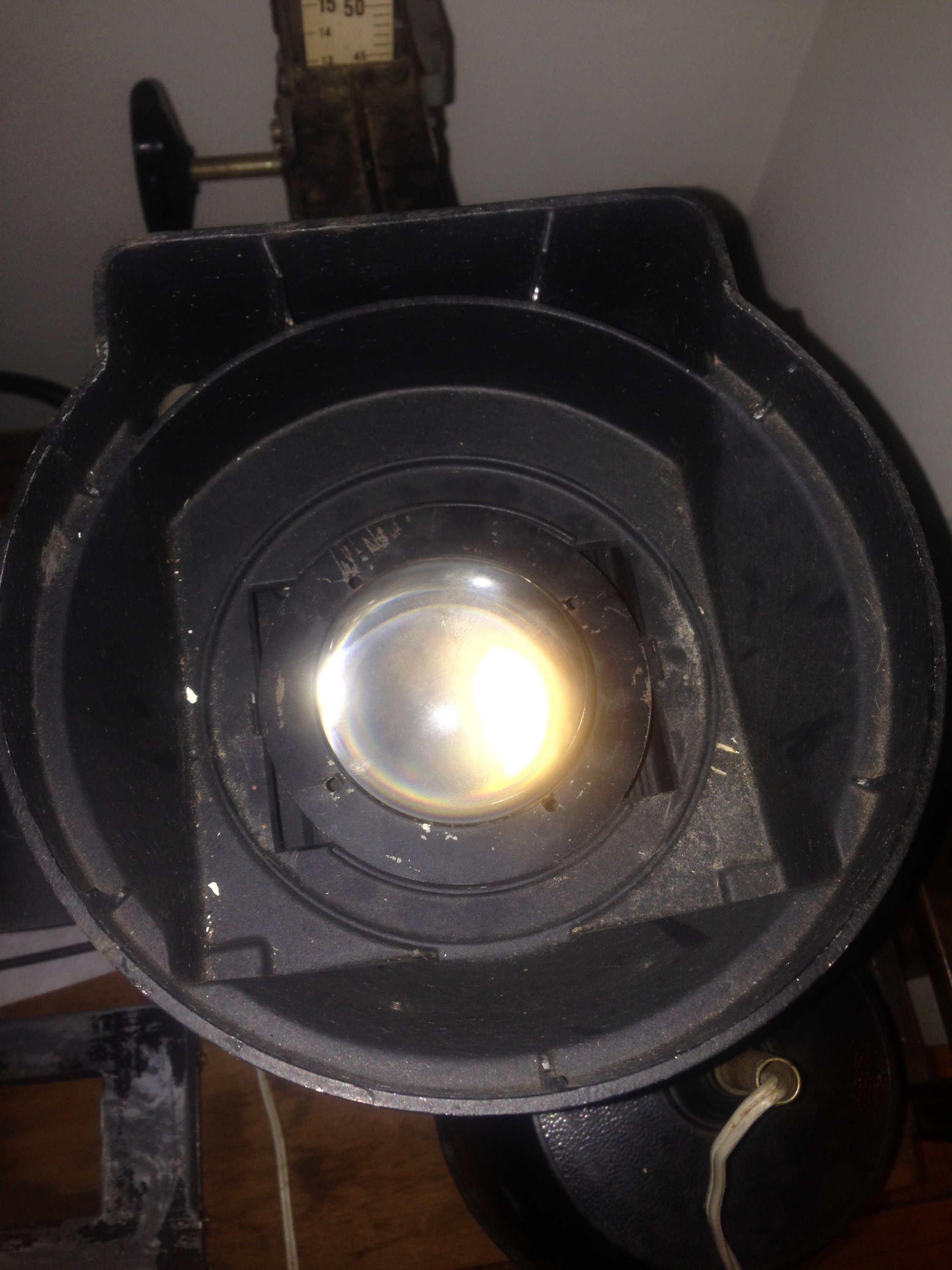

I tried to project a 6x9 negative but since it didn't fill the whole circle I looked inside and realized that the condenser lens doesn't cover the hole. The lens has a ring around it, preventing the 6x9 image from being projected completely. Does this mean I'd have to buy another lens to project a 6x9 image? I don't think I saw another one inside the home.
By the way, the condenser consists of only one lens. Is that correct? I mean the enlarger definitely works, but I've done a lot of research and everything I've read says the condenser is supposed to consist of two lenses.
AgX
Apr 5, 2007
29,973
Germany
There are different condenser designs. A single lens-element condenser is not uncommon for 6x9.
However the light passing the film-image must still reach the enlarging lens. If the condenser is smaller that than the image the enlarging lens lens must have a rear opening that is larger than the image. This is typically not the case.
Maybe you show us more photos of your enlarger.
You also did not tell us what lens you are using.

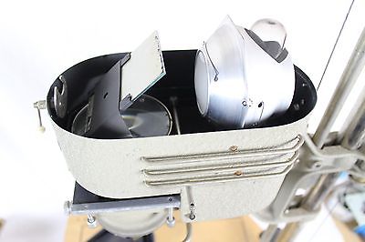

For example, does it look like this?

That Exact 66 pictured above is also from Veigel in Stuttgart-Bad Cannstatt. I don't own the Exact 66, but am familiar with its light source because it is similar in design to the light source on the Philips 150 that I do own.

The lens is a 50mm f4 Componar. I've attached a picture of the inside of head. The bulb is simply suspended above the condenser.

It looks like the condenser can be swapped for a larger one for MF. I assumed that was the enlarger's configuration, I looked in relevant BJP Almanacs but only the later enlarger is listed, imports prior to that(just after WWII) were heavily restricted into the UK.
Ian
