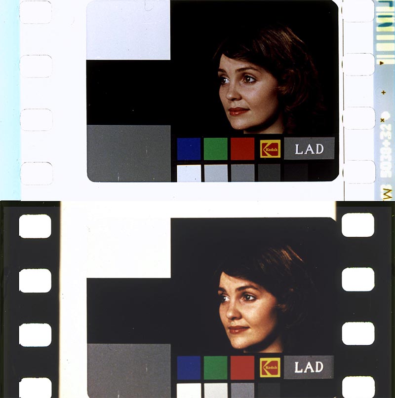

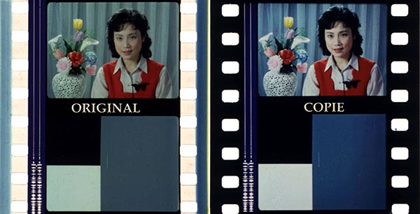

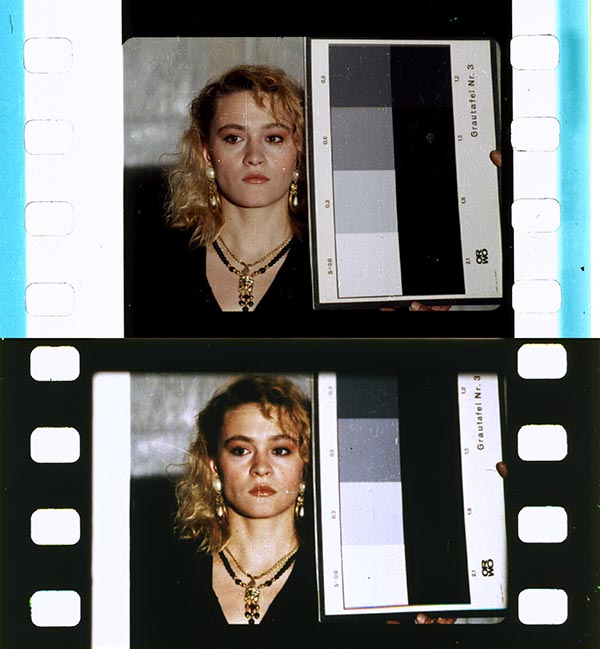

I found only scans with the color tests of color contact print.
They are presented in comparison with the original image obtained copy in the reversible color process.
The images are scanned in ~ 1998.
George
