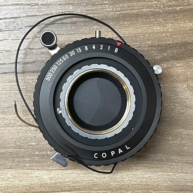

I have just purchased (accidentally) brand new shutter replacement for GX617. I thought it is generic mechanical copal 0 but it has two wires sticking out from it.
I found this post searching for some datasheet, but I am going to return it. I payed $200 on ebay. You should be able to find it easily if you are interested. The seller is located in Miami. Took 5 days to ship it but Miami runs on Cuban Standard Time so it is expected :wink:

I have one of those on order. It has two wires sticking out? They don't mention that in the posting and the photo doesn't show that either. Is it the flash synch? That's the only think I can think it would be, but on my GX617 lenses (I have the 90, 105, 180) they all have the normal flash synch jack on the side of the shutter.
I don't have GX617, but from my understanding the camera is electronically controlling the shutter. There is a mechanical release lever but without the cable holder. It also lacks the option to open the shutter for focusing on the ground glass. The lens cone has electrical connectors passed through between the camera and the shutter.

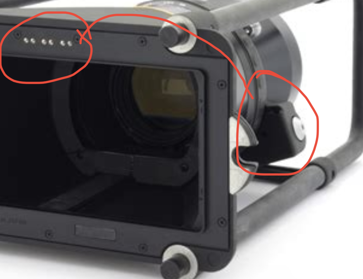

I attached picture showing where the wires mist be concealed.

I don't think that wire is for actuating the shutter. On the GX617, there is an external solenoid that does that and it is a bolt-on part and not internal to the Copal shutter, so there's no reason for the wires to be part of the shutter.
I'll see once I have one in hand here, but I suspect it is for flash synch. However, I don't know why they would have that since the GX617 dosn't have a hotshoe on the camera anywhere.
Yes, the shutters don't have the "preview" lever on them. I suspect that is so that you don't accidentally flip the shutter open while the camera is loaded. It takes deliberate effort to do that by using the Bulb setting.

Actually, I think it is for the GX617... looking over the details of the one I just got (and peering into the gap between the solenoid and the shutter), I think there is a pair of wires coming out of there to go to the solenoid. I don't yet know what the electrical connections are for (maybe to alert the solenoid that the shutter is cocked and ready to fire? That's my guess...).
Plus, everything else I can verify matches, but I don't have the old one out of the lens cone yet. I'm going to need to fabricate a decent spanner to unscrew the rear cell as it's pretty tight in there. I don't want to destroy the cell by slipping the spanner.
