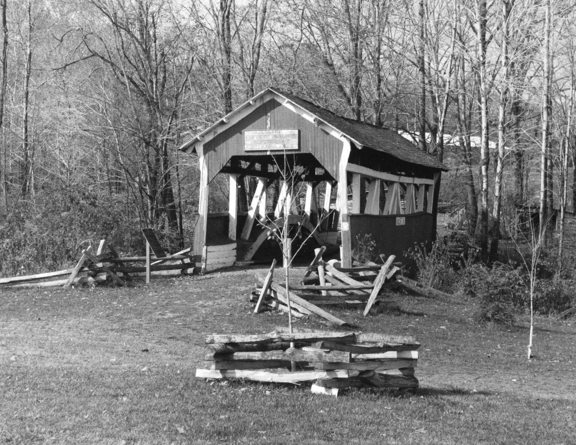

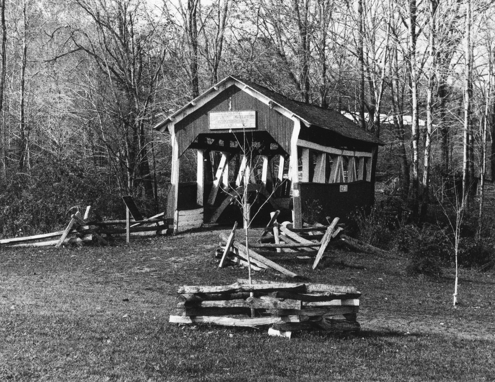

Here is a comparison of the same negative (probably Kodacolor VR100) printed on:
1. Panalure single weight fiber (before graded Panalure Select)
2. More recent print on Ilford Multigrade IV Fiber (filter grade unrecorded)
The difference is obvious. Might this shed some (enlarging) light on the subject?
