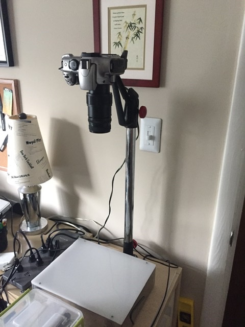

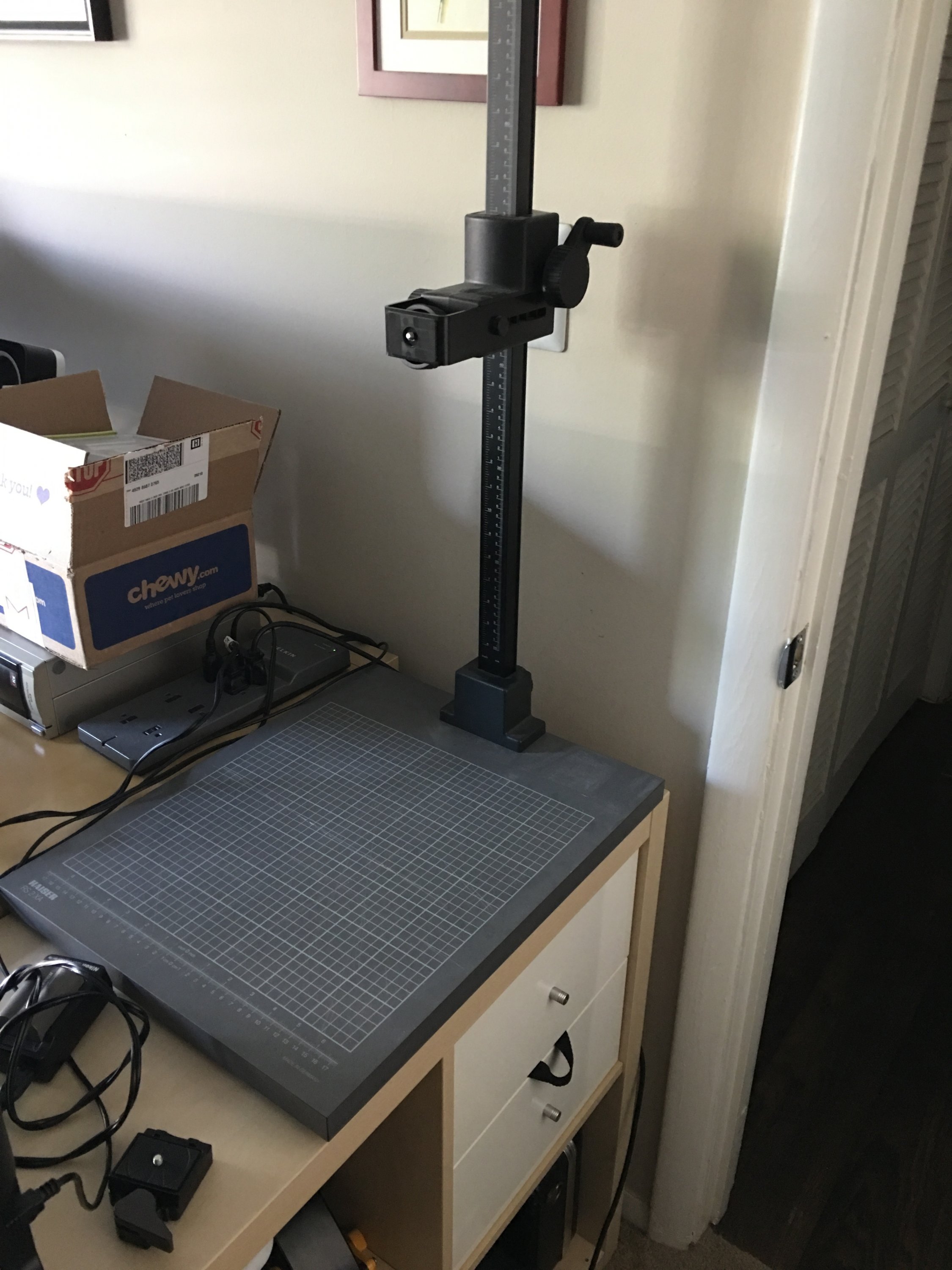

I use a copy stand. It doesn’t have to be big or expensive. Basic controls to level the camera are nice, but not necessary as you really want to be able to do that at your light source/negatives holder down on the copy stand table. So that the film is parallel with the camera sensor.
8EAD3220-BF07-49B7-81D5-9CB8DEE4AB59.jpeg 33F6A04F-9B06-4663-8CD3-5E5DDF125E65.jpeg
I use a copy stand, a Kaiser that someone I know was literally throwing out, along with an 8x10” Porta-Trace light box. Works great.

Yes I use a copy stand. The Kaiser RS2 XA to be exact.
