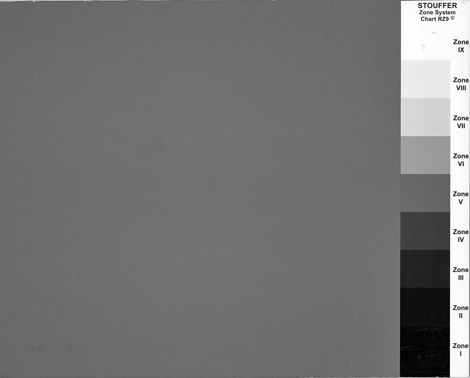

In most conditions I shoot FP4+ at 64 ASA and develop in Pyrogallol.
I usually have more film in a camera than I will be apt to quickly use and try to take a frame of a Kodak Gray Card with a Stouffer RZ9 zone strip attached. It's an easy way to catch something in my technique, metering or materials going off. Just a glance at the separation at the extremes usually is a good indicator of things being in balance for me. I also have a large enough gray zone then to measure on a densitometer.
