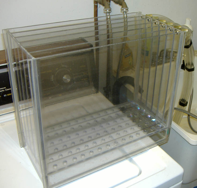

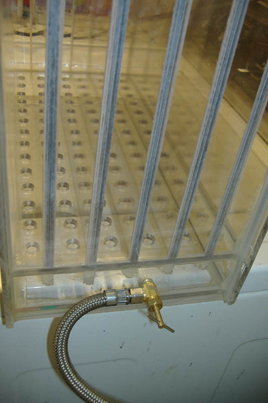

Material cost can be the deciding factor. This place has great prices. I built this using scrap 1/4" Lexan using a table saw with a dado blade and a home drill press. The center panels slide out for cleaning and it is held together with clear RTV labeled for aquarium use.
Good luck,

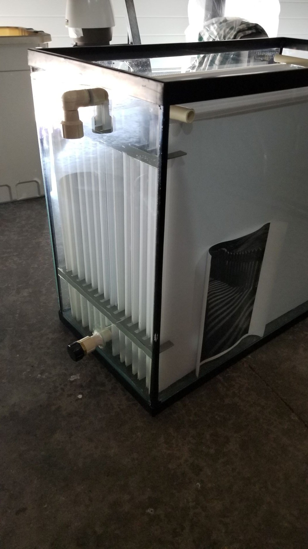

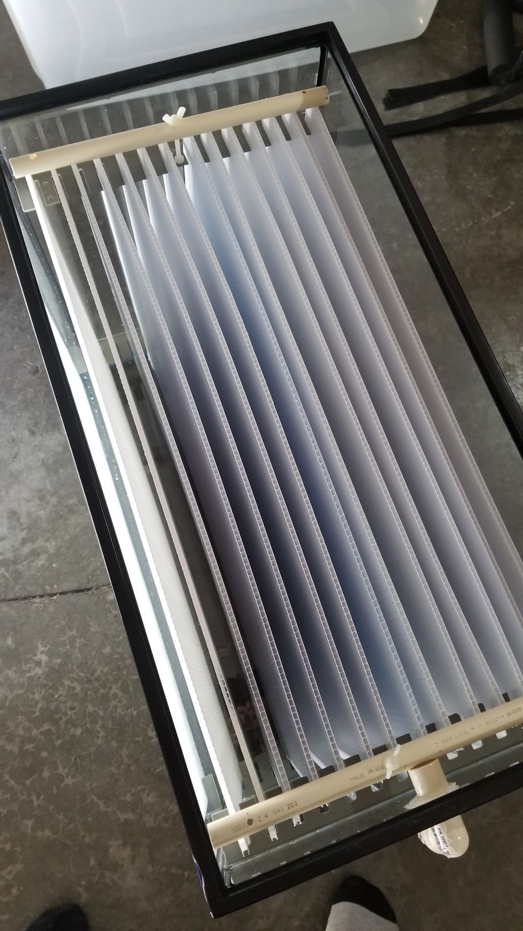

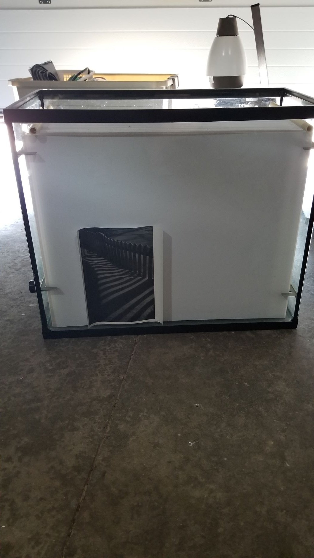

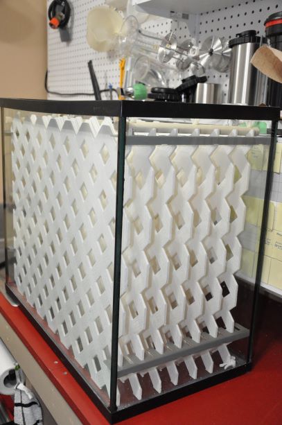

Yes, I have built a couple different versions....
The Tank:
  • I struggled to find an appropriate tank (big enough with vertical walls and made of plastic for easy drilling of holes for inlet and outlets)
  • The idea of using a fish tank came from Fine Art Photo Supply who had advertised a Water Saver Print Washer using an aquarium for the tank.
  • Here is a link to my flickr page showing my first 11x14 version: https://www.flickr.com/photos/c330shadowcatcher/albums/72157629185153709
  • I like the Versa Lab unit tank but the cost with exchange to CDN and the cost of shipping to Canada is too much, however I think I found the source of the tanks they use: https://www.usplastic.com/catalog/item.aspx?itemid=26177&catid=960
  • Shipping cost for this tank to you may be more reasonable.
  • I used a standard off the shelf aquarium for both the 11x14 and 16x20 Vertical Print Washer (VPW) with no reinforcements
  • In the 16x20 version in my post I had drilled two holes - I no longer bother with that and use standard washing machine hoses from Home Depot and a Little Giant pump to circulate water, drain and or add water.

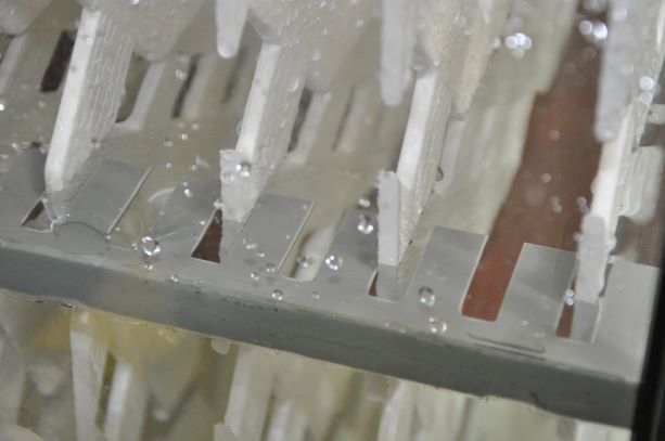

The "Fingers" to keep the dividers separated and in place:
  • I am lucky to have a table saw so I am able to cut down the Wire Duct to make the "fingers" that hold the slot dividers in place: https://ca-en.alliedelec.com/product/panduit/g2x2wh6/70333534/
  • I cut in two along the length of the duct and then trim off the ends of the fingers before cutting to the width of the tank.
  • I recommend using clear silicone to hold then in place as the white silicone looked messy.
The Slot Dividers
16x20 Vertical Print Washer:
  • Uses a 24"L x 12.5"D x 16"H, 20 gallon tank
  • Has 15 slots to hold up 15 16x20 photographic prints
  • Footprint 12.5"x24"
11x14 Vertical Print Washer:
  • Uses a 20"L x 10"D x 12"H 10 gallon tank
  • Has 12 slots to hold up 12 11x14 (24 8X10) photographic prints
  • Footprint 10"x20"
Let me know if you have further questions or if you would like more details.
All the best
Todd

I'm looking to build the aquarium based print washer described in your post. What size water pump did you use or think necessary
Thanks
