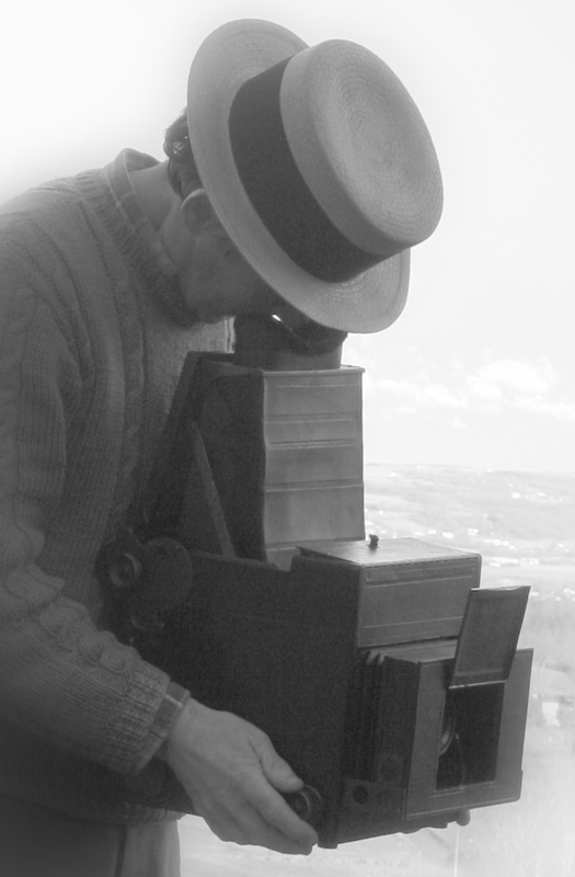

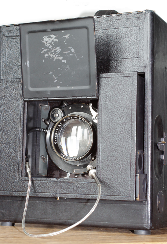

Hello,
A friend took and gave me a pic when I was with my Press Graflex.
I don't remember when and where, but I am sure I never used it handholded ; I think it was for the fun...
The rear shutter worked (and works) well, but I often used the camera with a front shutter.
Now it's too heavy...
