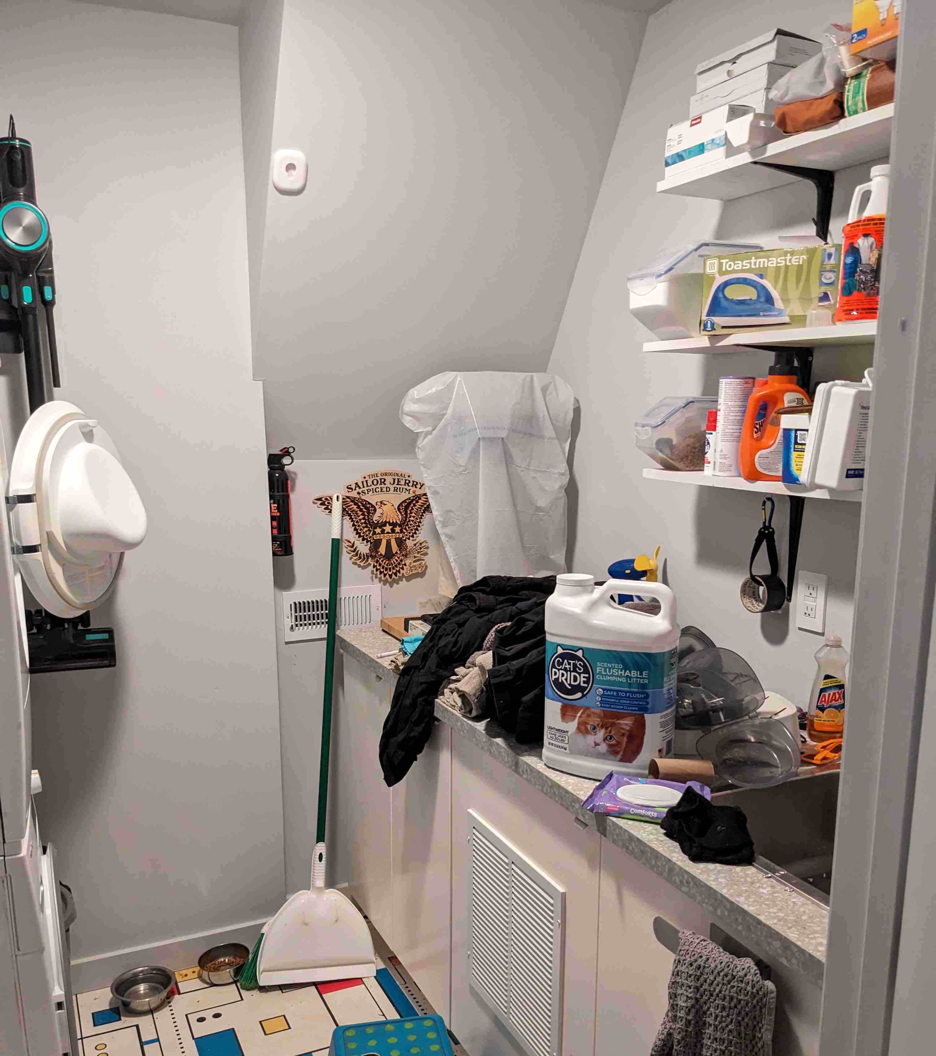

I have what you call a "dual purpose darkroom". As in it's purpose is to wash kids clothes and I get a little bit of a bonus by having my enlarger in there. I live in an A-frame and my durst just barely clears the wall all the way up. I know it is mess now, but cleans up nicely when I want to use it.
