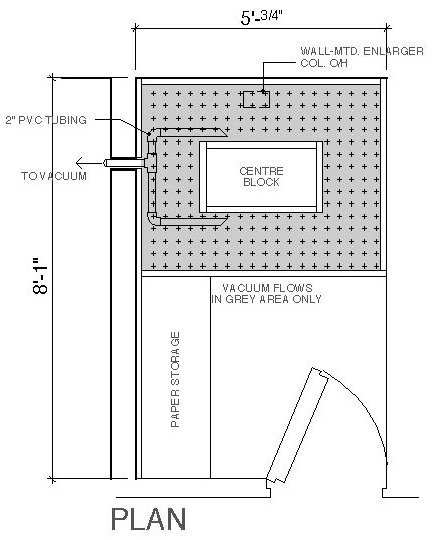

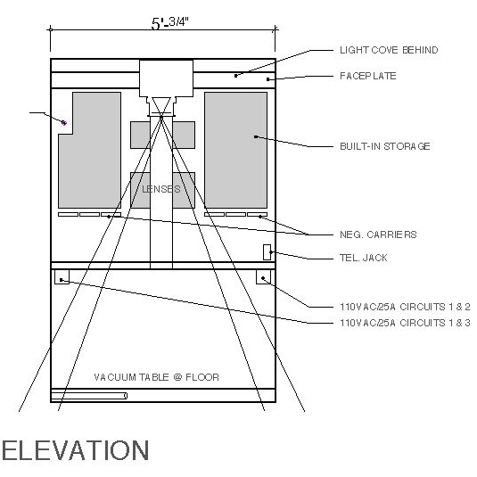

Well - I don't know how ideal it is - but it seems like a pretty good compromise... it's what I came up with last night and built. I blocked out the whole center area - thinking that the suction would be more effective at the perimeter, in case of loss in the system. Everything's pretty well sealed with silicone and caulking. I think that the centre should stay pretty flat anyway.

Sparky -- The requirements for graphic arts printing frames are far more stringent than those for a vacuum enlarging easel. Depth of field is generous at your easel. Blocking off the center area isn't necessary. If the edges draw down tightly, that will sealed off the center, and there is no loss of vacuum at the center. As the paper is drawn down onto the easel, the vacuum increases and the air flow diminishes. This causes the vacuum to be evenly distributed without the need for any ducting within the easel.
On the home-made 11x14 vacuum easel I used long ago, double weight paper that was cupped due to storage and dry air sometimes wouldn't draw down at the edges until temporarily pressed down. Strips of thin paper to seal off part of the easel for small prints weren't elegant, but they worked.

All the vacum easels I work with have channels Or blocks of wood that support the metal surface so that when the vacumn is turned on the middle dosen't collapse,. If this is in your design sorry.*internal ribs that channel the flow of suction.*
As well I would put the whole easel on a floating platform so that the easel can be aligned properly. It looks like this can be easily done.
I have seen multiple port vacumn systems to evenly distribute the suction and for the size you are doing you may want to have two ports. As well do not mount the vacumn on the base area to reduce vibration.
To hold a large sheet of paper is tough with only vacumn, we always combined magnets with the vacumn for the best overall suction.

Yes - I hadn't really considered that effect in the design, Bob! Though I wanted it to have SOME rigidity anyway - there would be times I'd definitely need to stand on it! So - the way it's built - the longest open span of unsupported hardwood ply is only about 14"! So - it would have even less flex than a normal floor under even the worst conditions! So - we're good there.
The whole thing is bolted and glued to a concrete floor... so - alignment is pretty much up to altering things at the projection stage (wall mounted devere 504).
As for the vibration issue. The vacuum source is a large model home depot shop vac on wheels attached to the wall inlet (or is it considered an OUTLET if it's a vacuum??). And that's via a shortened 3" hose. So - shouldn't be an issue that I can think of.
