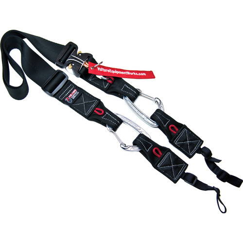

... On the other hand, there is always this strap for the paranoid:
With that a fire extinguisher would also be in the right place. Thanks for link.
