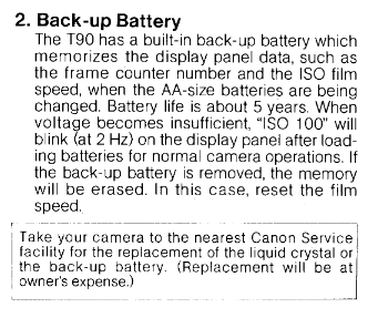

"Mythical"!? Maybe not. It definitely exists. Some batteries have been known to go 20+ years. Just like a lot of watches, and the tiny CR2025 in my Canon E-1 intervalometer, which is dated 1991.
In my friend's tattered T90 manual emailed last night, the internal battery reference is on page 108:
AFAIK this battery is resident on the wraparound flexboard inside the prism.
You can look for it on the circuit here on the mir.com.my image:

The internal lithium battery is only to maintain the memory contents while the main batteries are not in the camera or are being changed. The memory data includes the ISO that has been set and the frame count for the current film. The worst that can happen without lithium power is that you will have to reset the ISO on the camera to ensure accurate metering. The drive motors will detect the end of the film regardless of the frame counter. How else can you use unmarked bulk loaded cassettes?

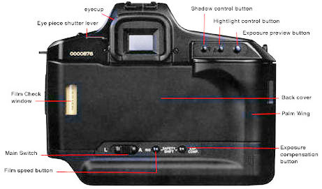

Now for Spot HS / Multi spot metering. I only use spot metering with the Highlight / Shadow adjustment as follows:
1. For scenes of average contrast just meter a mid-tone, grass or worn asphalt, and leave it at that. (Why even use spot metering?).
2. For caucasian faces etc, one spot reading on face and open up a stop with Hightlight button.
3. When metering for shadow detail, one spot reading and close down two or more stops with Shadow button.
