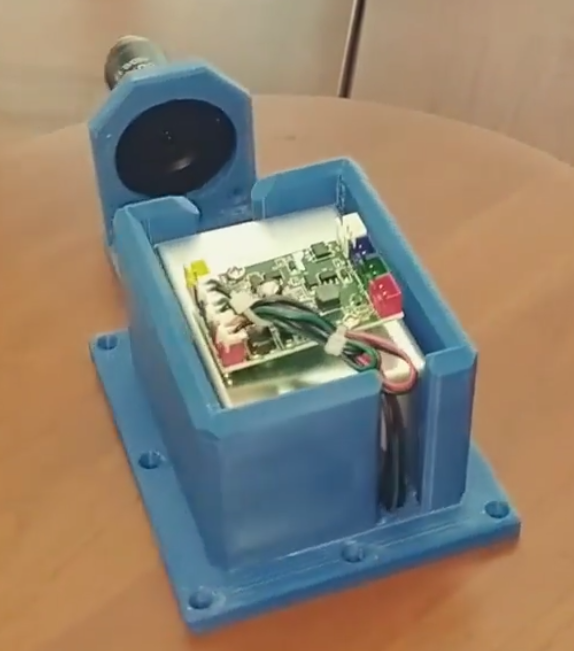

I am using a microscope lens as my diverging lens, I 3D printed a mount to hold the lens directly in line with the beam. I have not yet tried to power the beam as its way too powerful un-diverged. I need to make a metal cover to cover up the beam portion.

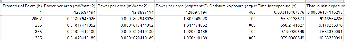

My math teacher helped me put the formula in a sheet, and I was able to figure out the erg/s*cm^2 of the laser to cover an 8x10 plate. Its not that much, about 2? the book I have, holography handbook, states that around 55-100 are needed for lower res plates, up too 400-100 and going into the thousands. That puts me at a minute for the best speed, which the Lippmann are probably not. I am still not certain if this is even right at all.
From what I understand, most lasers used for holography are sub 100mw. This has a combined mw of 1010 total, (R & G 180mw, B 650mw) (not sure if blue being so much higher is gonna affect things, do the low sensitivity of blue counter it? or should I TTL the blue off? (im not even sure how to do that)) Anyways, I think it should be quite a lot faster than normal holography lasers, so I am going to bracket on the first plate from half a second to around 20 min.

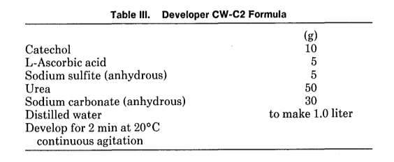

Anyways, I plan to develop in this

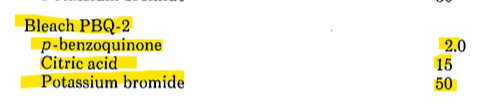

stop it, and then bleach in this
https://sci-hub.hkvisa.net/10.1364/AO.23.000934
From what I understand, its one of the best recipes.

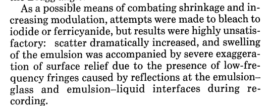

I have ferricyanide bleach, but from what I read I dont think it works that well

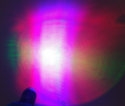

As for my laser, its not as good as I hoped. I powered it on today and I can only use about 1/8th of the total size because the lasers only combine over a small portion. And that portion is also overwhelmingly blue! I will have to keep blue off for 2/3ish of the time since its 3.5 times more powerful. Not a huge deal. Green has terrible spread, why is it oriented horizontal?
final result will probably be very messy, I should be able to rid most of the major lens spots, but there isnt anything I can do about the interference patterns? maybe a pinhole?
The green channel may be a NIR laser with a KDP (potassium dihydrogen phosphate) crystal that doubles the frequency, turning a 1064nm beam into a 532nm beam. This is the approach taken in green laser pointers. There is a lot of really horrid Chinese KDP out there, expect all sorts of strange distortions to the beam shape. Polishing is a major manufacturing cost for KDP crystals - however even a roughly polished and non-parallel KDP crystal will frequency double. The doubled beam requires a filter to remove the remnants of the original NIR beam, and many cheap green lasers employ ineffective IR filters.
