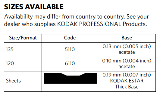

The large format film has a thicker base than the small format film.
I'm wondering where you got your information. And is Shanghai then ORWO's film or is ORWO's film actually made by Shanghai?
Is that so? I thought (sorry, no good reference) that 135 and sheet film are generally poured on the same base, but that 120 roll film uses a thinner base.
I was referring to 120 as one of the small format films. It's pretty small compared to 8x10. I don't think I have any 35mm film as stiff as 8x10 Shanghai.
The large format Shanghai is probably not the same emulsion as the 135 - which seems to be maybe from big rolls of 35mm UN54. Maybe the larger format film is still made by the original manufacturer? But then - maybe that's now rebranded Foma.
Yeah. Just note that 120 and 135 are different in terms of substrate thickness. Well, at least that's the case with the major, photographic film manufacturers. What happens in the muddy margins is a different story.
Possibly; I've only used it in 4x5. The stuff I used was definitely not Fomapan as it aged differently (and very poorly, at that), but I purchased it probably 2-3 years ago, so this says nothing about what may be sold today. The substrate on that film was of a typical sheet film thickness.
The original manufacturer may or may not be making photographic film. They are likely still making photosensitive materials for industry - that's more lucrative. But who knows?
Or:
I have just measured 3 different rolls of Kodak and Ilford 35mm film and I get 0.15mm or 5 mils plus a tad.
I measured 2 rolls of Kodak 120 and get the same values.
I measured 1 sheet of Kodak 4 x 5 and get 0.2mm or 7 mils plus a tad.
I measured the large 42" roll of uncoated estar and get 7 mils.
Hope this helps.
I used a combo metric/english micrometer.
PE
So it's different than I thought, but it looks like it varies a bit. E.g. from the present Kodak Ektar datasheet:
The TriX datasheet only mentions the 7 mil Estar base for the 320 sheet film but no base thickness or material for the roll formats. Are these also coated on acetate? In that case I would expec them to be on a 5 resp. 4 mil base as well.
Ilford's FP4+ datasheet gives exactly the same information as the Ektar snippet shown above; 5mil and 4 mil acetate for 135 resp. 120, 7 mil polyester for sheet films.

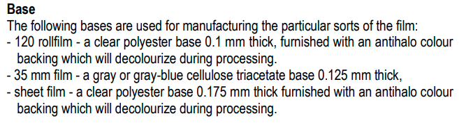

This is Fomapan 100:
The thickness pattern is always the same, apparently. A thin 120 base, a thick sheet film base and 135 is somewhere in-between.
