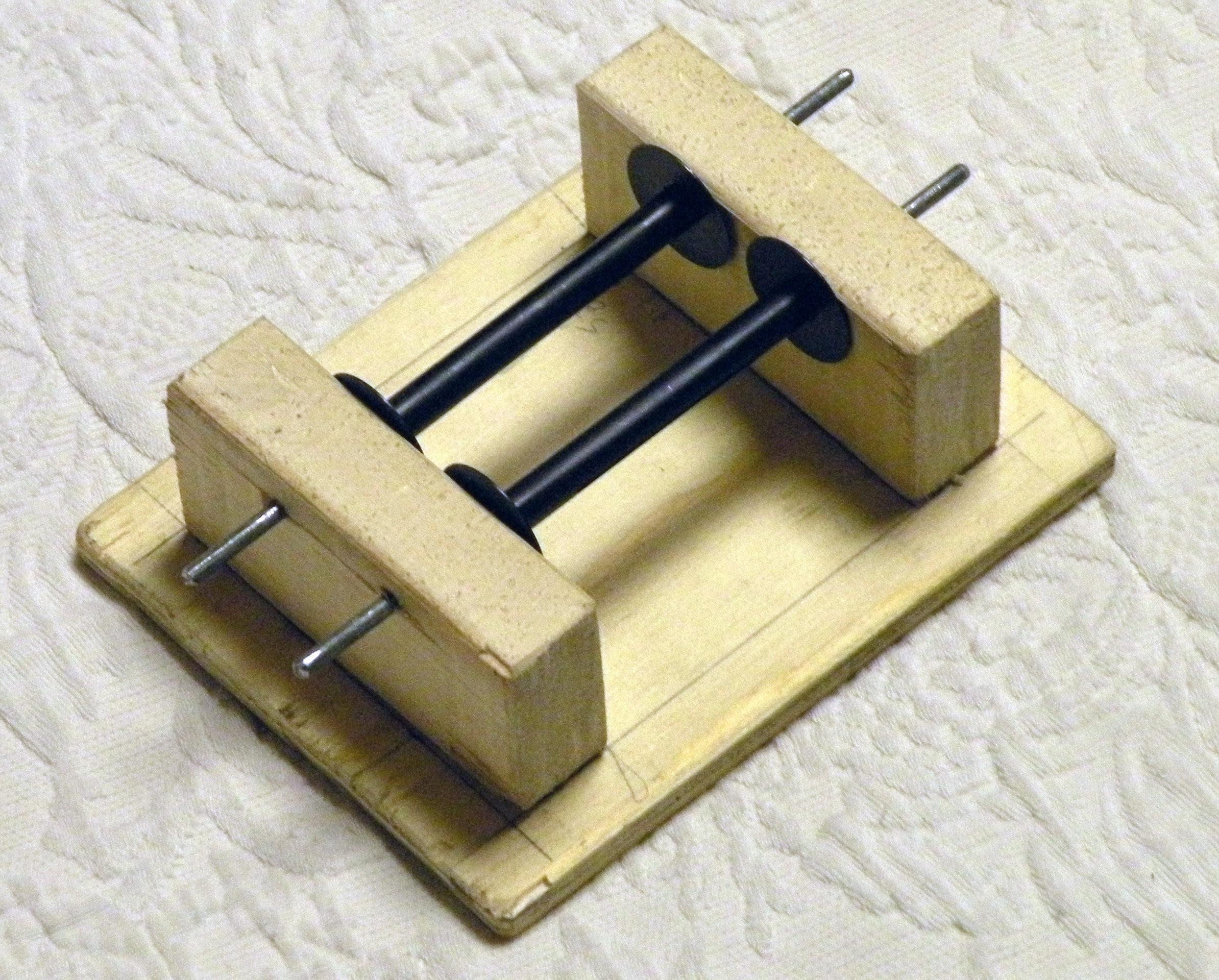

I stumbled on to this thread, & wondered if this would help in respooling. I find it easier to respool with this little tool. It keeps the film/paper straight, & I find that the film 'bump' is minimal, if it exists at all. 120 spool to a 620spool, then 620 to 620.
