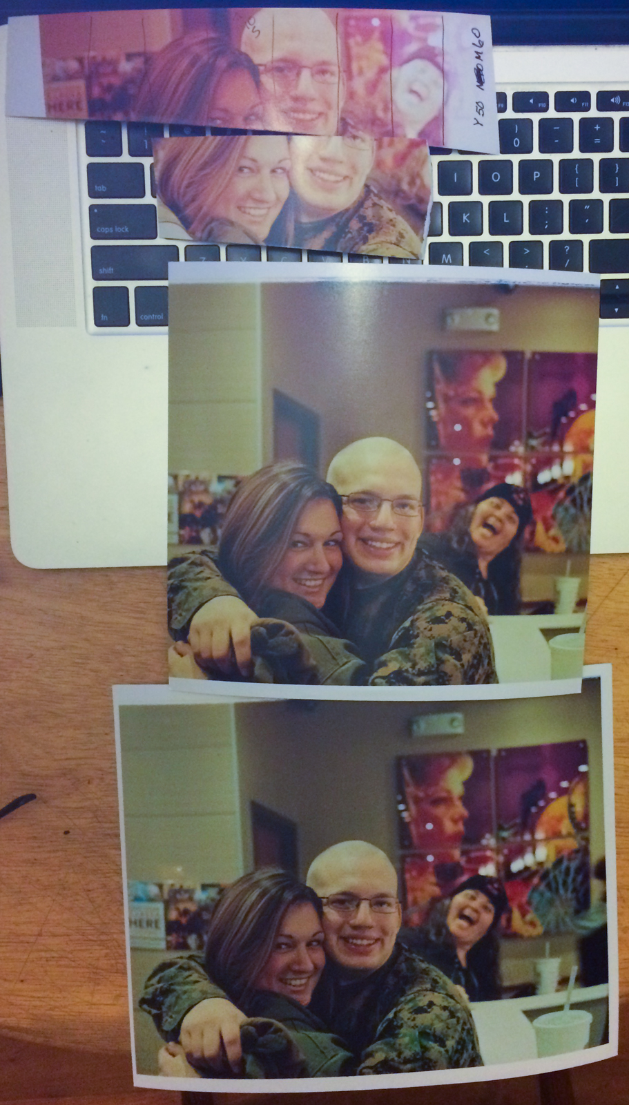

So I started printing color a few days ago and after my first success (relatively speaking) I hit the darkroom to go at it again and was underwhelmed with my results. I think I just hit on a more difficult negative than the first time so I had an exaggerated sense of how balancing the color would go.
I'm using the Kodak viewing filters for reference.
Example.
I had a keepsake negative from when my stepson shipped out to Europe and tried printing it. It was VERY orange/yellow. I started increasing the M and Y filters and got to a point where I thought I nailed it as well as I could but in getting up this morning and seeing the results, I definitely overshot it...it's too green. Skin tones look sickly.
Most of the time my images are family snap shots so elaborate set ups like shooting a grey reference card every time isn't feasible.
Just looking for folks who've been through it and have tips to ease my pain :smile:
From top to bottom is the sequence. The pictures don't look exactly like they do in real life. In real life they are more reddish and the second to last one is not as green as it looks here. The last one is greenish.

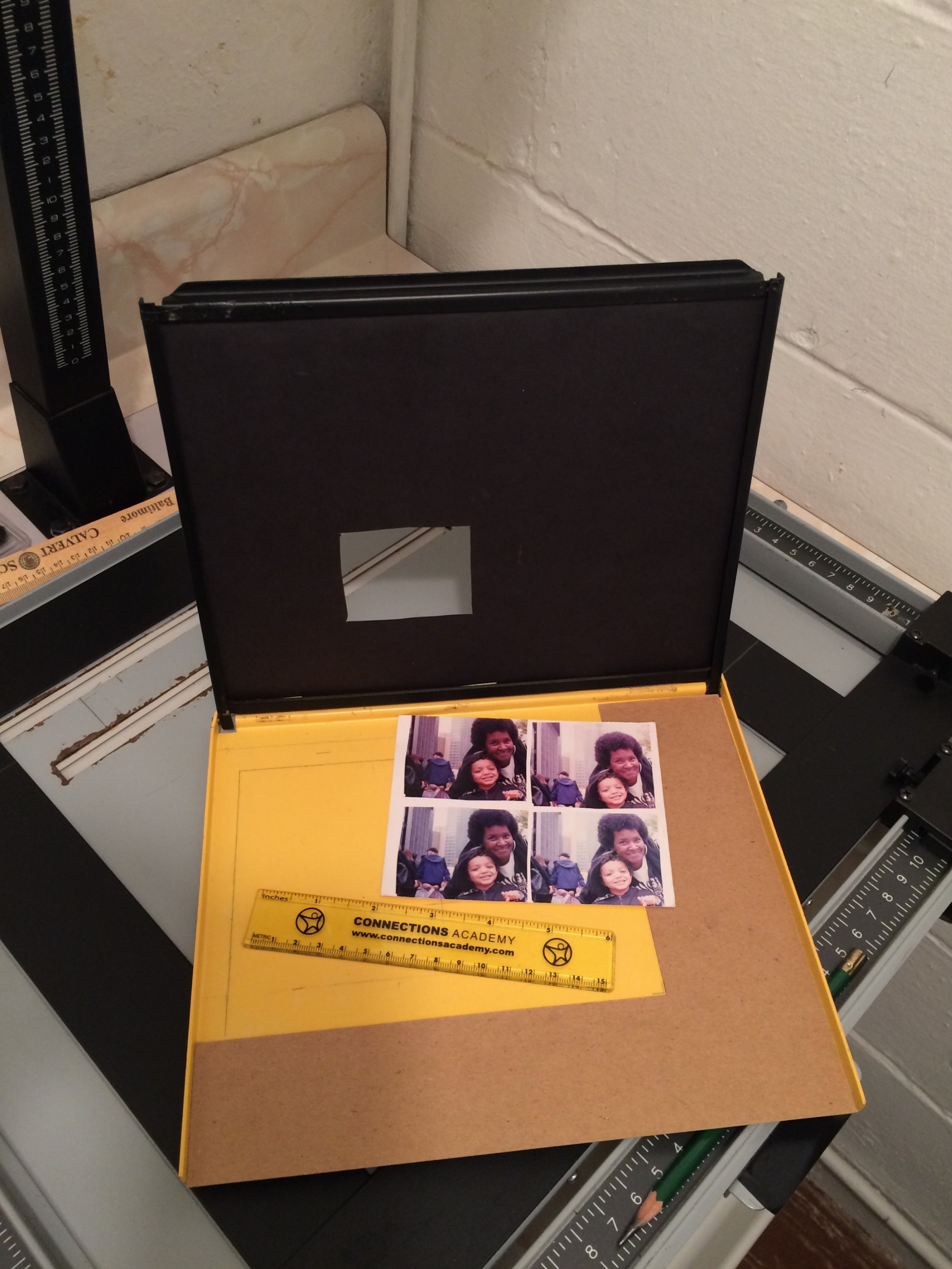

What helped me a lot was a multi test print easel. I decided to make my own because I wanted to see the SAME area of the print under different filtrations. Say I'm color balancing off of a known white object, like a T-shirt (I don't always shoot gray cards, but it would still apply in this case). Then I want to see the T-shirt under every filtration that I'm testing. That could be tricky if I'm blocking off portions of the frame say with an 8x10 mask with a 4x5 quadrant removed (as described above). The contraption here lets me make four exposures of the same small area of the print onto a single sheet of 4x5 sheet paper. The L-shaped cardboard guide lets me move the paper around a 6x7.5 area, and the mask has a 2x2.5 rectangle cut out that comes down right in the middle. I place the paper in the top left, expose using filtration 1, move it to the right, filtration 2, down, 3, left, 4. And it's easy to do in the dark. So suppose I started with 50M+50Y and decided there's too much blue in the print. Or is it cyan? I might make exposures of 50M+45Y, 50M+40Y, 45M+45Y and 45M+40Y in that order. Large adjustments (especially of magenta) will require corresponding changes of exposure.
By the way, this is an old 8x10 easel that I repurposed. The mask is black construction paper taped to a hinged frame that comes down over the paper. By itself, it creates a thin border around an 8x10 print. I plan to make a larger one that will allow me to expose four 4x5 areas to a full 8x10 sheet of paper.

Well, I tried one last print and so I lessened the greenish tint slightly; almost like the previous print. I tried a test print first, and then an 8X10. I got a good test print, and then exposed the 8x10 and put it in the drum backwards...whoops! It's ..."interesting"..
Then I did one last 8x10 and it came out nice. A keeper.
