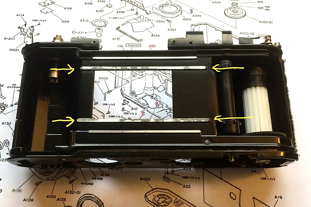

I guess this camera has sat for a while with film loaded.
Any tips or tricks for cleaning the film residue off the inner guide rails (yellow arrows) ?
You could try using a needle and then isopropyl alcohol or acetone (be careful with plastics see the film winding spool on the right). Even water could do. Or an eraser. The edge of a knife could also work. The film guide there should be made of metal and not scratch. Try carefully, of course.
Thanks ic-racer and Andreas, That's this afternoon's entertainment taken care of!
I had that in a camera; scraping with a wooden edge got it down to the metal surface, but that had corroded very slightly. IIRC I polished the rails with some metal polish wad. Intended for brass, but it seems to do something to aluminium; clean it off well after. Their appearance doesn't matter as long as they're smooth and don't resist the film moving.

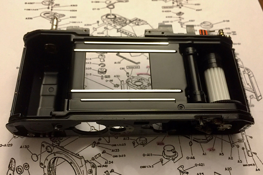

Yes, there is a bit of corrosion on mine as well, so I haven't been able to completely remove the marking but it's looking much more presentable. The rubber worked best, I had an old ink rubber, and with the shutter already removed (I need to clean it as goo from disintegrating foam seals is on a couple of the blades) I didn’t have to worry about bits of rubber flying around. I had masked either side of the rails with tape to protect the paint and finished off with a very gentle polish with Simichrome polish.

Thanks Dustin and ic-racer. The photo looks better than it actually is as there are still a couple of areas where the film residue has eaten into the metal slightly but it was difficult to photograph in the dull Scottish winter light!

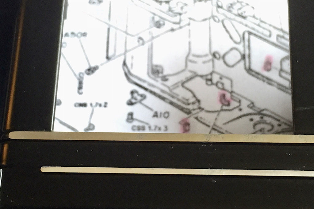

This picture hopefully gives a better idea as to the residual effects of the corrosion.
I wouldn't worry about it, as long as there isn't a huge amount of friction. These rails are only in contact with the film outside the image area after all.
Nice job! A cotton bud with a tiny bit of Flitz metal polish and some elbow grease helps mirror-finish the guides, but be sure to thoroughly clean off any residue with alcohol.
