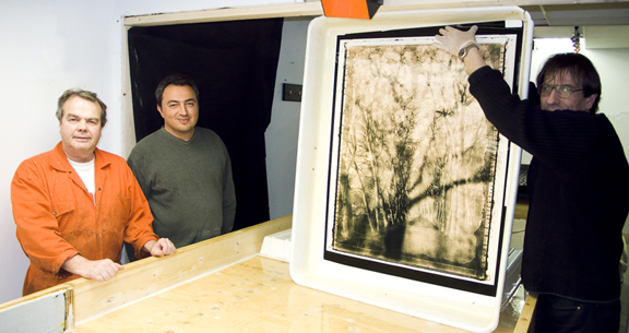

Just finishing up with Guilliume today some prints on the Emak, with a bit of toning to boot,,,, really lovely paper with fantastic tonalities and opportunities for lith as well.. here is a pic of one of the prints we did yesterday.. I am the handsome guy in the orange jumpsuit.

Beautiful. Really stunning.
Where can I get a suit like that?

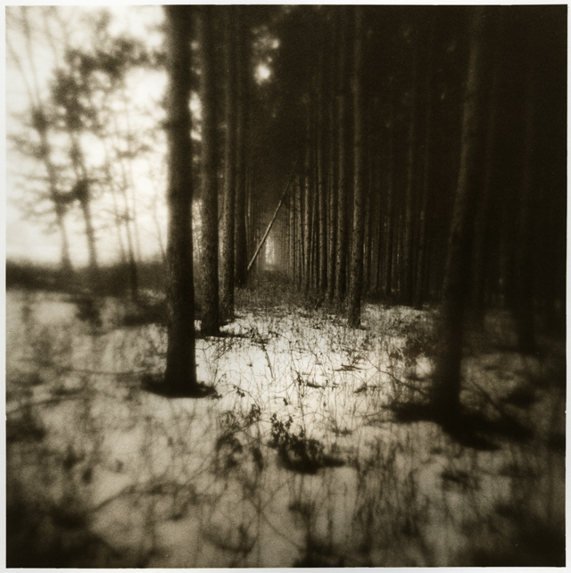

Matti, I'm using the developer sold by Freestyle Photo in California. Arista Lith. It's similar to Maco and Fotospeed in the colors and tonalities I'm able to achieve, but requires a slightly higher temperature to get there.
The dilution is 1+1+30, and I use it at around 75-80*F. (24-26*C).
Here is a link to the APUG gallery with an example. I think only subscribers can view it. This is a short exposure and about 14 minute development time. You get warmer brown tone with longer exposure time with development times at around 10-11 minutes, and less contrast of course.
I've pasted the image below for those that can't go to the gallery to view. It's the Grade 3 version. I love this paper in both lith, Ansco 130, and Amidol. Exceptional stuff.
Thanks,
- Thomas

Thank you Thomas.
Great Holga-stuff. 1+1+30... I was doing 1+1+19, maybe I will try it again. With the Moersch-developer, Wolfgang suggests 15+25+1000 ml for Forte graded papers. Maybe I will try something like that here for more color. I really like the surface of emaks. Even better than forte. And I need a way of heating the stuff for lith as well.
