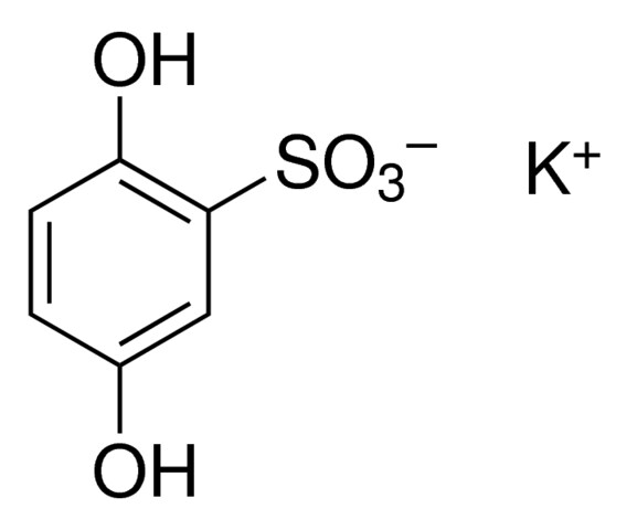

When I read about a good warm tone paper developer, I look up the MSDS to see if there's any information that might help me in my DIY mixing. I notice that in the Moersch 4812 there is "1,4 dihydroxybenzene potassium salt"
1,4 dihydroxybenzene is hydroquinone, but I've never come across a potassium salt of it. Could this be the secret to its long life?
Attempting to answer my own question. Looking up the CAS number from the Moersch web site for this compound, it is not simply hydroquinone plus K+ but something else. Probably not easily available for hobbyists. Not often we come across a new developing agent.
