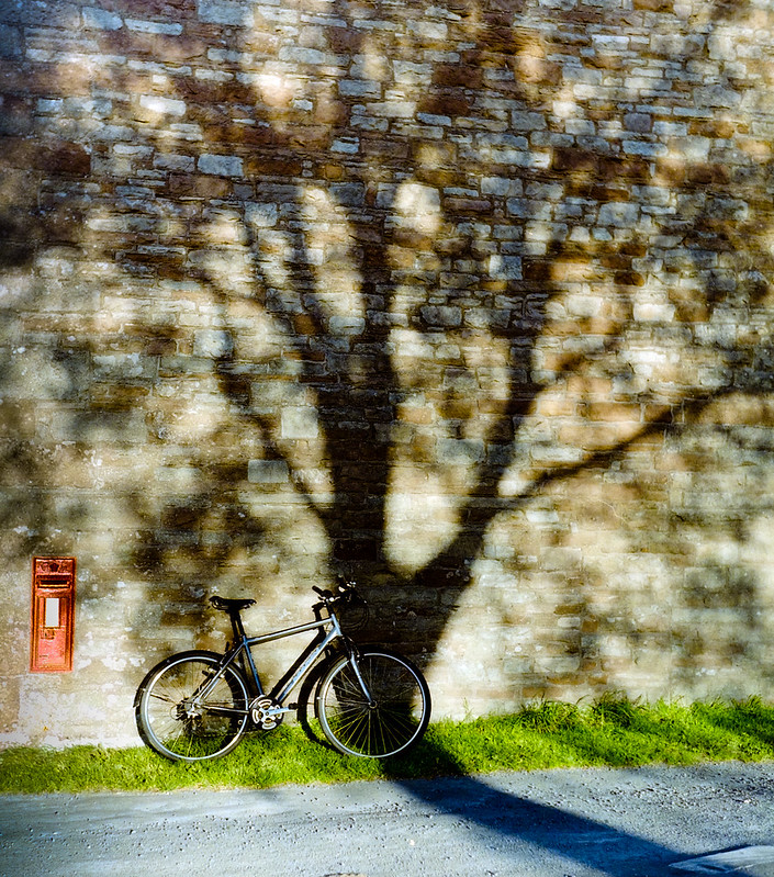

Would the subjective effect of crossover be the reason why the spokes on my bicycle have taken on the colour of the grass behind them? This was developed at 30C.
The Bike Against The Wall by Russell W Barnes, on Flickr
Just green reflected off of the grass.
Actual crossover is not subjective.
