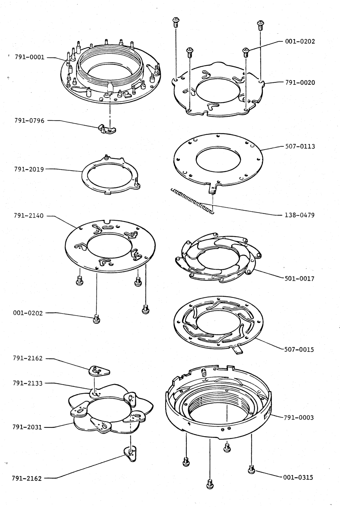

Here is a good video. At the 1 hour mark he has the shutter out, from there usually one removes the mechanism (791-0001) from the shell (791-003), revealing the shutter blades, (which will fallout) and the aperture mechanism, which can be disassembled and cleaned.
If the aperture blades are oily then you really need to think about how that happened. Cleaning them might not be all that is needed.
Since the aperture blades are the last thing left after the entire rest of the lens is disassembled, usually any other issue will be addressed on re-assembly.
