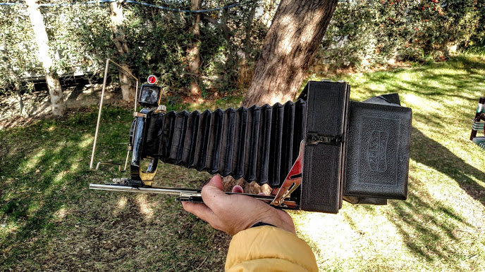

Sadly enough my folder died today after I finished shooting a roll of HP5 :sad:. Got to return back to the shop tomorrow afternoon.
Update: I found that I can trigger the shutter without the locked shutter button on top by hitting a side lever to the right which actuates the shutter. I may go that route even though it isn't easy like pressing the regular shutter :D.

The double-exposure prevention mechanism is not too hard to clean on the Zeiss (Super) Ikontas. I've come across sample were someone had actually disabled it by inserting a small section of a match stick so it wouldn't lock anymore.
It involves taking the central screw out and then lift off the knob. The housing itself is clamped on which can be removed by wedging a sharp object under the edge. That'll give you full access to the mechanism for cleaning.

If that's an Ikonta with a frame counter (like my Super Ikonta B) it may simply not unlock the body release until the advance has locked at the next frame -- try restarting the counter and see if the body release becomes free again. WARNING: you will then have to cycle through the rest of the virtual "roll" to get the counter back to the free-wind state of "roll finished".

Yep, good to know where that second shutter release is. I assume that Zeiss knew this full well, as at least the ones I have seen have a few ridges for a finger as if they were expecting this usage.
A common problem with these cameras is that the shutter lock mechanism kicks in before the shutter is actually fired. If you wind forward (no need for film) and get the red dot to show, slowly press the release. You'll probably find that the shutter lock mechanism kicks over before the shutter fires. If you don't let up and continue pressing, the shutter will fire. But if you let up and then try to fire the shutter, no good, you are locked out. So if I am planning to take a photo and fiddling with the shutter release and change my mind, well... time for the secondary release.
If anyone knows how to adjust the sync of these two things- the shutter lock and the actual shutter firing- on these Zeisses, I'd love to know. I've looked all over for adjustment points, either threaded or just bending, and can't find one.
