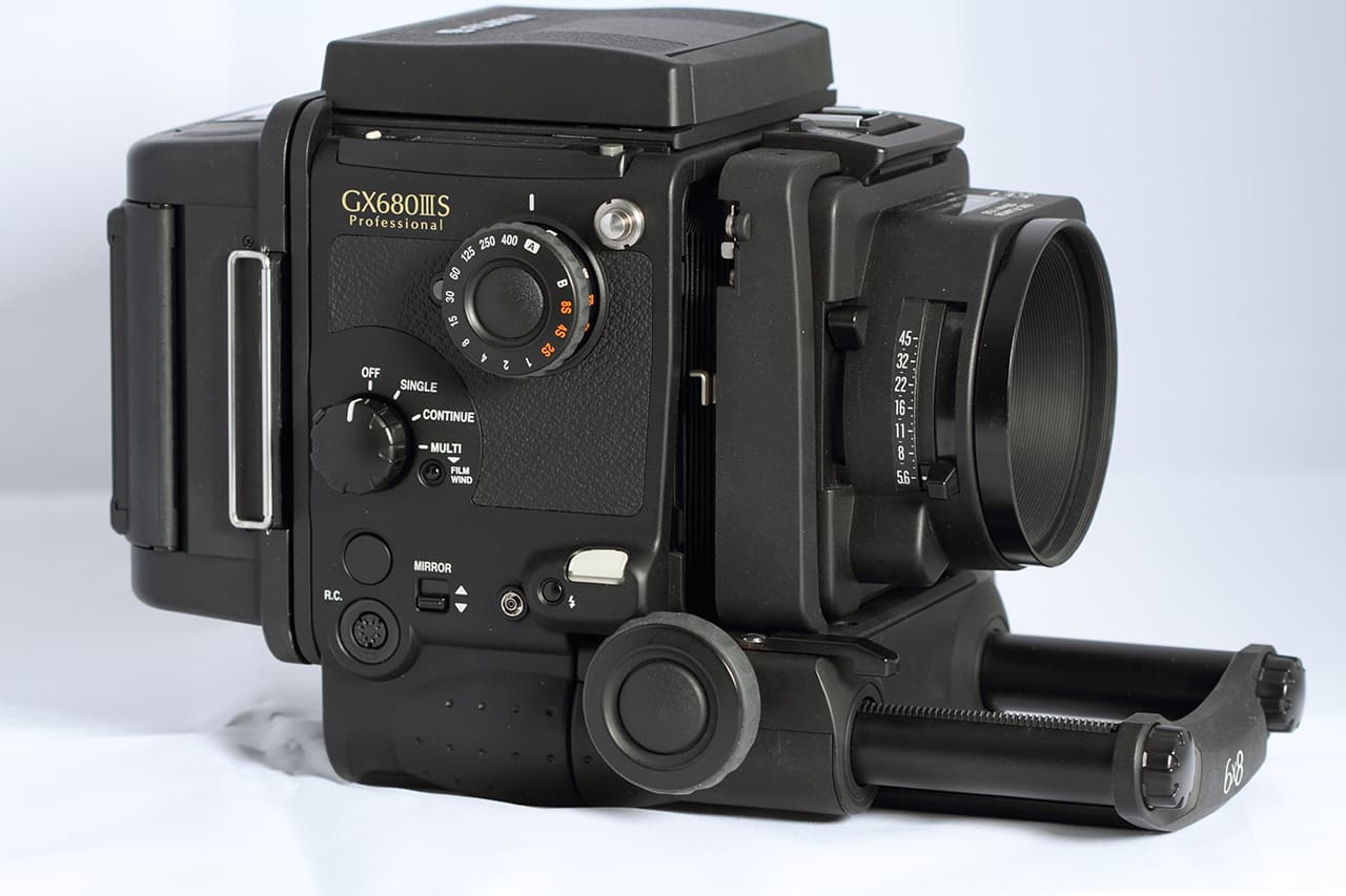

Try this with a Fuji GX 680....:laugh: !

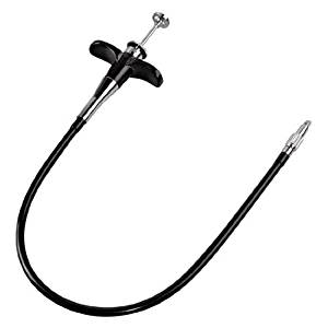

PS : For 100% sharpness you ALLWAYS have the need oft 3things :
1) a realy good stabile tripod from massive design/construction
2) a mirror lockup (also with 35mm camera don't be naive)
3) this fine tool :
If you are missing just one of these fundamental things you better should not prove how sharp
your negatives you have shot during all the decades realy are.....:wink:
3) this fine tool :

So again : Try to shot hendheld with this here :
......and Trendland will wish you "Bon Chance" (even without tele lenses)...:D!
