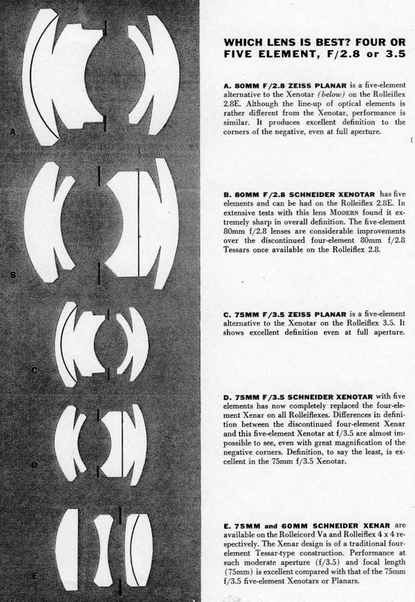

Do you have a schematic you can show us? As far as I can remember, the xenotar doesn’t have the front group cemented and the decementing really plagues the planars. This is my general rule for the F line. Even the tele-rollei planars, they almost all suffer decementing.
I can’t say it’s a planar cell but this, to me, looks like lenses 1 and 2 decementing... I am not an expert but just an amateur so take what I say lightly.

I’m looking at Large Format lenses?
The 80/2.8 and 100/2.8 are medium format lenses for nominal 6x6 and 6x9 respectively. The 150/2.8 whose cross-section is figured is indeed an LF lens. All three are to the same prescription.
