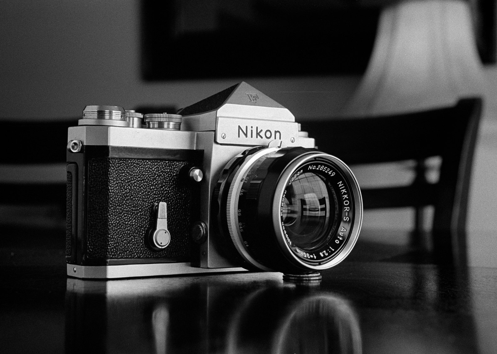

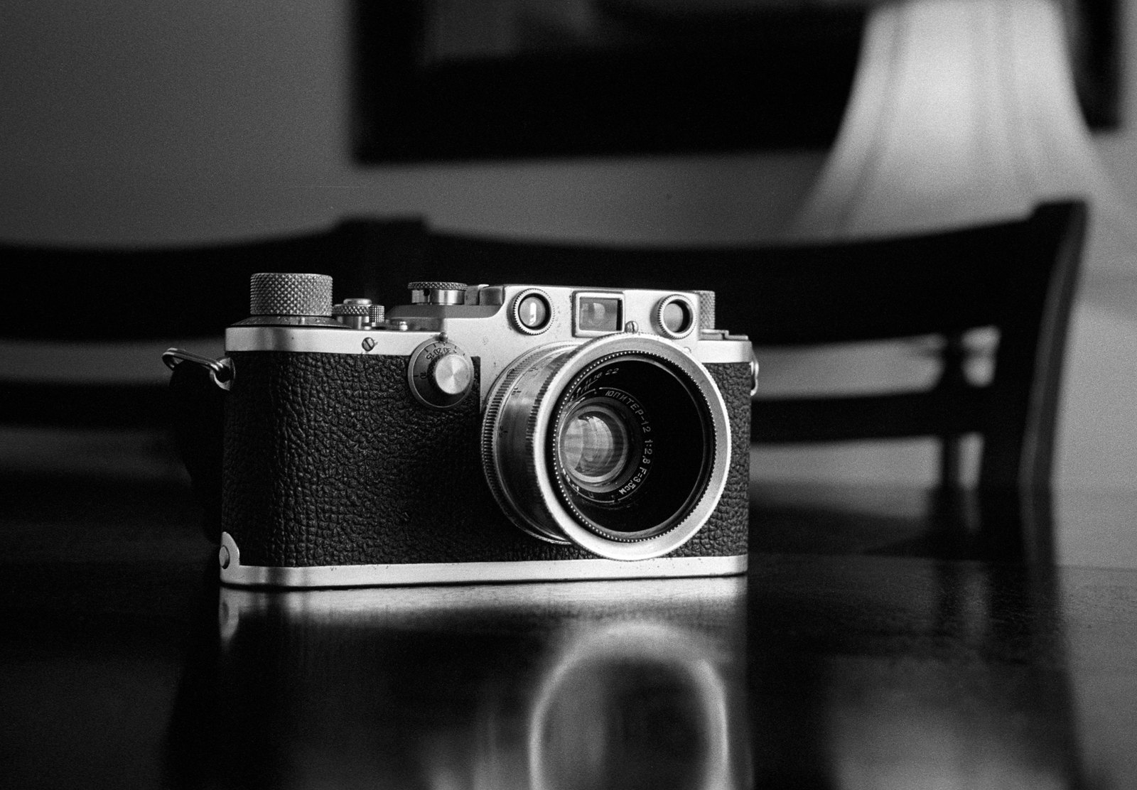

Both shots details:
Roll 20160316-01; Kodak Tri-X 400 @ EI 400; Developed in LegacyPro L-110 Dilution E (1:47); '38 Leica IIIb; '49 Leitz 50mm f/2.0 Summitar; Auto-Up; 1/8 sec - f/11;
