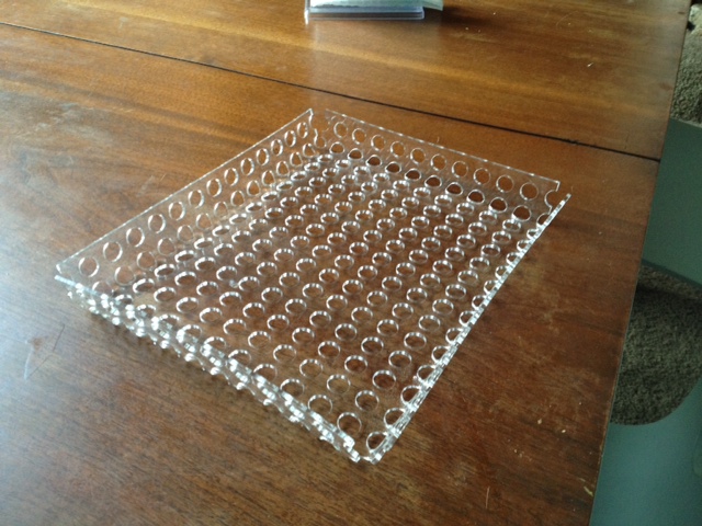

I went over to Sector 67 in Madison here today and (with a lot of great help from people there) put together a prototype in about an hour. One of the engineers there actually has an 8x10 enlarger (in storage) so he knew what I was talking about! Anyway, we decided to go with a piece of laser cut acrylic that I then shaped with a heat gun. If this design works out then I could do several at one time in the laser cutter and then bake them in an oven to shape/temper the slosher.
The beveled sides could be use to work out a stacking arrangement, but I think version 2 will have an cross-piece insert that drops into the middle to convert from 1 8x10 to 4 4x5, and also a slot for an insert that will stop the tray above from dropping too far if you want to stack them.
So, please take a look at the picture and let me know if you have any recommendations on the design. Smaller holes? Bigger holes? I'm going to try a few negatives and see how it works.
I could do polyethylene instead of acrylic, but it wouldn't be as pretty. The acrylic, however, will crack if dropped.
Time on the laser cutter was about $4.00 and the acrylic was $8. So I think we are looking at a price of about $25 shipped with a small donation to sector 67 for their time/facility included. Does that seem too expensive? Bigger holes would result in less laser-cutting time, and polyethylene might be cheaper if I need to get the cost lower.
Also, I'll post the svg so anyone with access to a laser cutter and materials can make their own!

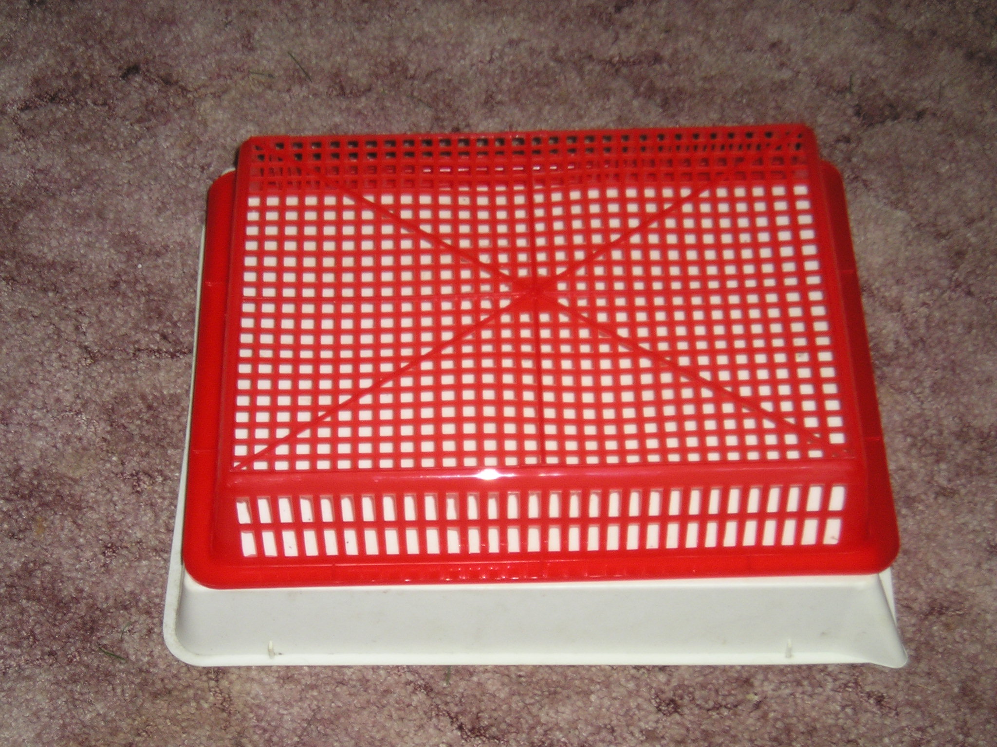

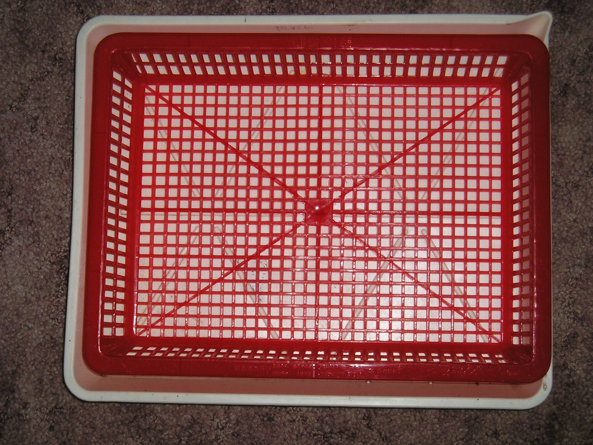

2004-01-01 00.00.00-2.jpg2004-01-01 00.00.00-1.jpg A few years ago, at a flea market, I saw these plastic baskets, which the vendor described as fruit baskets for berries. They certainly looked pretty big for berries, but I measured them at about 12 X 9 inches at the bottom, and bought the pile of them for $5.00. I ended up with 12 of them.
Whatever their original mission in life, they fit a sheet of 8 X 10 film or paper beautifully and, due to the slant of the sides, they nest with about 1/2 inch between. They also fit perfectly, with a bit, in an 11 X 14 tray.
I have a lifetime supply, but I have no idea of their source.:smile:
