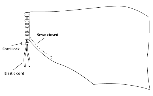

Ive been using this self designed, home-made for years and it works great and cost practically nothing.
It's made out of a light, slippery fabric that is easy to move around under. It very light tight, Black on one side Gray on the other. The elastic keeps the cloth securely on the camera and yet is easy to attach and remove.
It is sewn closed for several inches back from the GG which keeps reflected light from hitting it from below while allowing you plenty of access to loupe the glass
I haven't used in high winds but I think that a couple of small pony clips on the back corners would probably weight them sufficiently to keep it from flapping around.
The drawing is not to scale but shows shape and detail.
