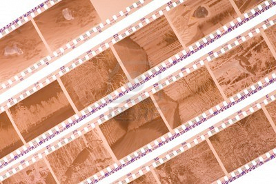

Kid,
You obviously didn't understood what I said.
You only had to pick up your Pentax DSLR or any digi device, a film strip with a white sheet behind and take a shot of it against a light source.
Something like this:
attachment.php
Your scans show some damage that can happen when film is inserted in the scanner or when putting film in or out of a development tank.
As you now said it was the first time you used a Peterson tank, I'm almost sure the white marks on the right corners of your "bad neg 02" are from removing wet film from the tank spiral.
But, I wanted to be sure and that's why I asked for a pic of the negatives.
