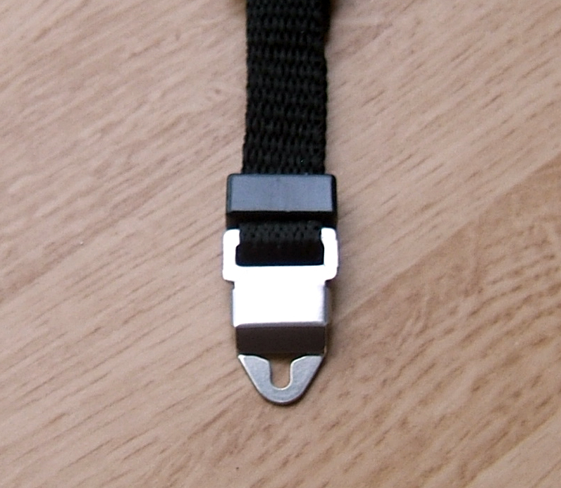

Any idea what this Op/Tech strap fits?

Does this look like an Op/Tech strap connector for a Hasselblad, or perhaps a Pentacon Six? The width of the small slit shown is 3mm wide, and on the back the wide part is 8mm wide. At different times I've owned both cameras (guess which one was better? LOL). Those cameras are long gone now and I would like to sell the strap, but I don't know exactly what I have.

That is the Super Pro A connector, which fits:
[TABLE="class: ProStrap, width: 390"]
[TH="bgcolor: #EDEDED"]Cameras[/TH]
[TH="bgcolor: #EDEDED"]Super Pro A[/TH]
[TH="bgcolor: #EDEDED"]Super Pro B[/TH]
Bronica (ETR and some ETRC)
[TD="align: center"]X[/TD]
[TD="align: center"] [/TD]
Canon EOS M (Must use supplied locks)
Hasselblad
Kiev
Mamiya (except M645 Super and M645 Pro)
Olympus IS1 and IS2
Pentax 6X7
Pentax 645
Pentax LX
Rollei
[/TABLE]

The strap is for the Hasselblad.

Thus type Super Pro B fits Pentacon Six?

Yes, thank you very much. Very handy chart!

According to this, yes, the Super Pro B will work on the Pentacon. I actually used the Super Pro A (the one shown in my photo above) by filing out the slot for the bigger post on the Pentacon. Must have sold those w/ the camera because I can't find them anywhere.
