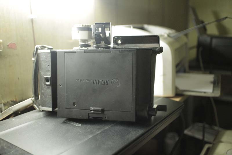

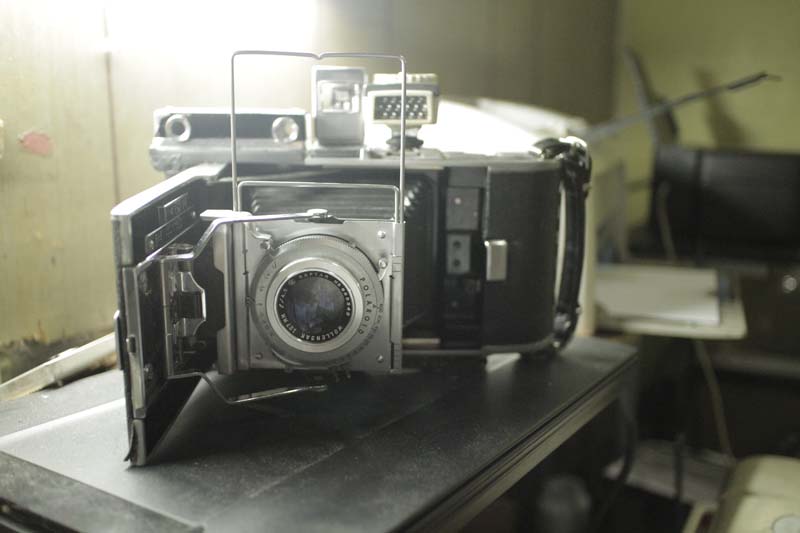

just finished shooting the camera today and it was a blast. I'll try to post a picture soon. I used a Bel Air back. I would also use a 3D printed adapter if I had access to a printer-that would make the whole job easier. The main problems with any instax conversion are (1) all available cameras or backs have plastic stubs that have to be ground down before you mount them to a camera, (2) the back has to be attached securely to the body without sacrificing the light tightness of the film chamber and (3)the film plane has to be moved back a few milimeters because of the way the film is located inside the instax cartridges.
After grinding the stubs, I made a spacer between the camera film gate and the back, attached the back with a combination of screws, magnets and adhesive. I also moved back the infinity stops to account for the change in the film plane.
With a 3d printer, you just have to make a sort of adapter that mates the flat face of the film gate with the flat part of the Bel Air back. Probably would need just a strong adhesive to attach both.
The finish is still rough but at least it's in perfect shooting condition.
