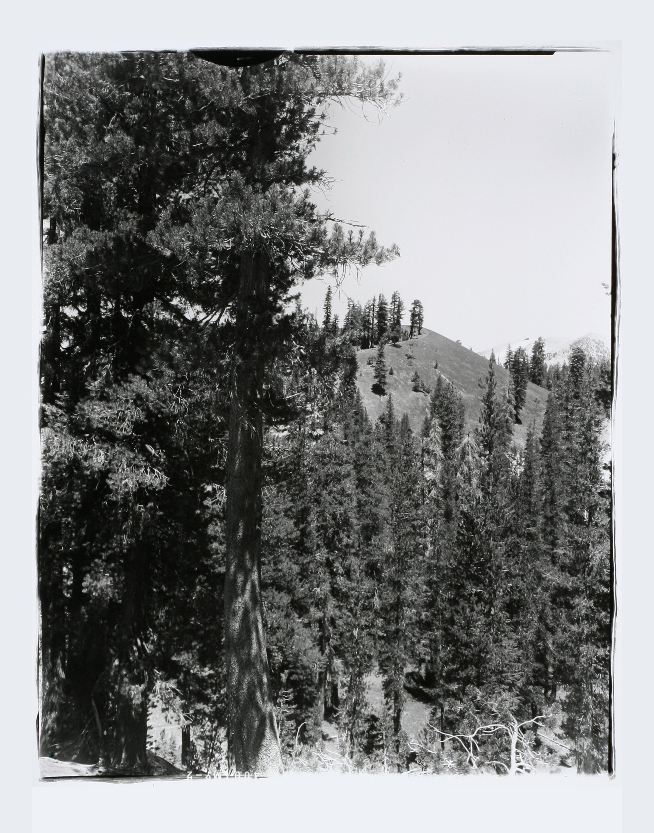

Here is an example, 400 speed film shot at 64, so I have plenty of shadow detail (there's a long story why I picked 64 - I usually shoot at 250 now). The lower-left trees were pitch black on a straight print. When I dodged them they came out looking natural.
