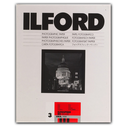

Ähm sorry you just need normal fixed grade with warm tones - yes?
(I never made lith - but now I understand)!
Yes beside Iford I mentioned there was a real big bunch of "Rollei Classic" warm tone and I remember a fix grade out of that series! It is discontinued but perhaps you Google about!
There was foma with a fix grade but cold (bluisch) toned!
Agfa is discontinued (like all papers from Agfa).....hm - is there a Ilford in warmtone remaining ?
this here isn't warmtone ! So your Mission imposible should be indeed completed!
