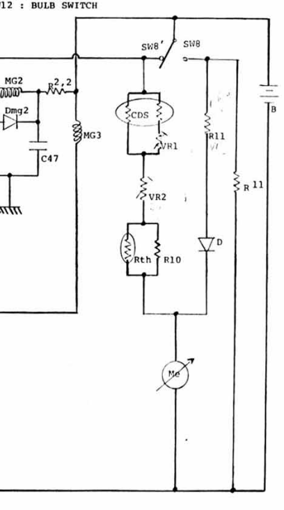

The shutter circuit is not the same as the meter circuit. They're separate. See here:
At the left (cropped) is the timing circuit. At the right (in sight), the metering circuit.
As you can see, it will depend on precise voltage from the battery. QED.

You did not get my point. With "it" I meant the camera circuit in general, not the meter circuit.
