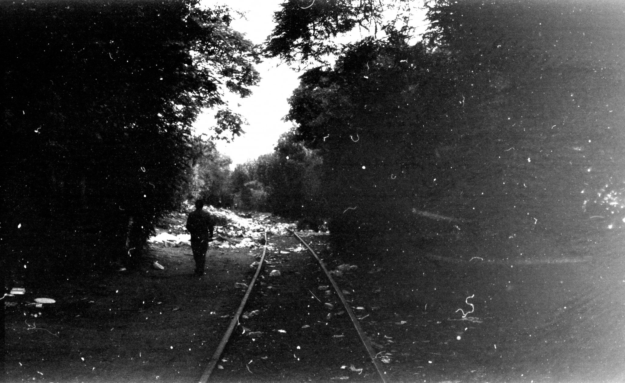

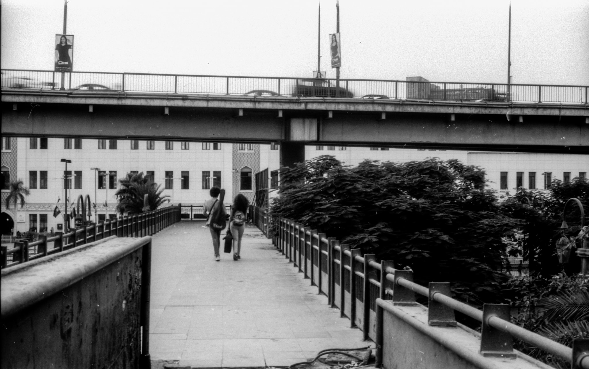

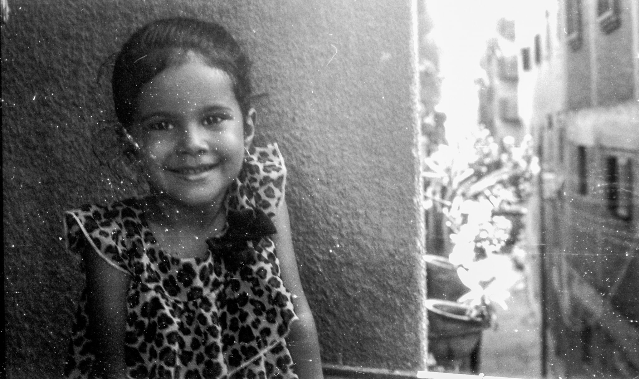

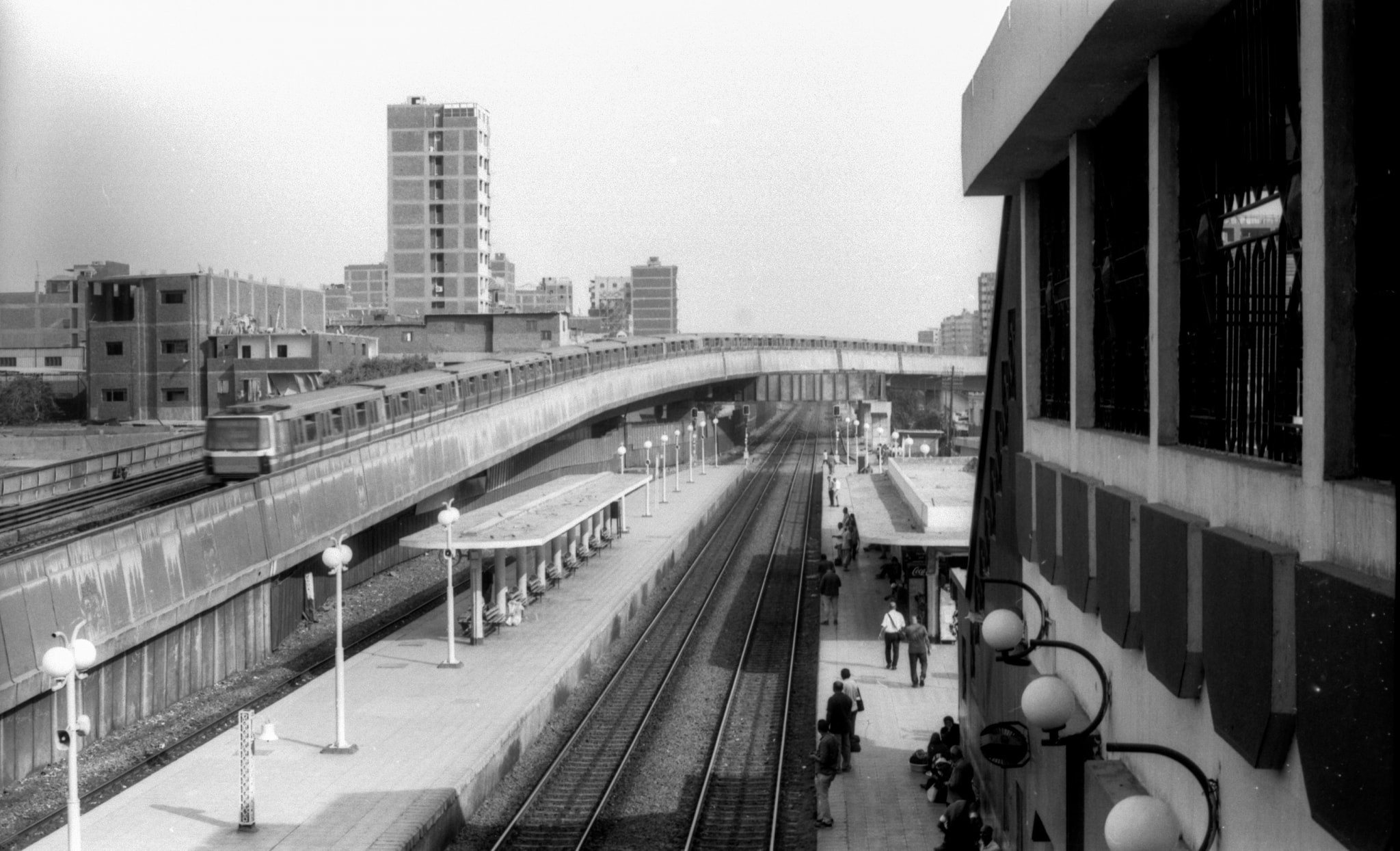

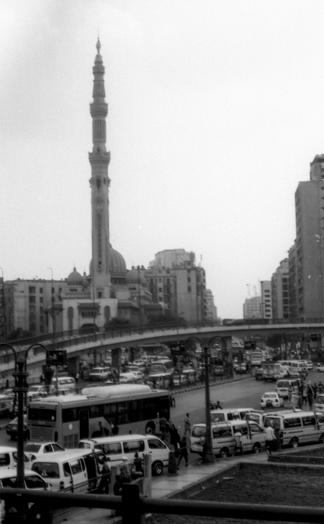

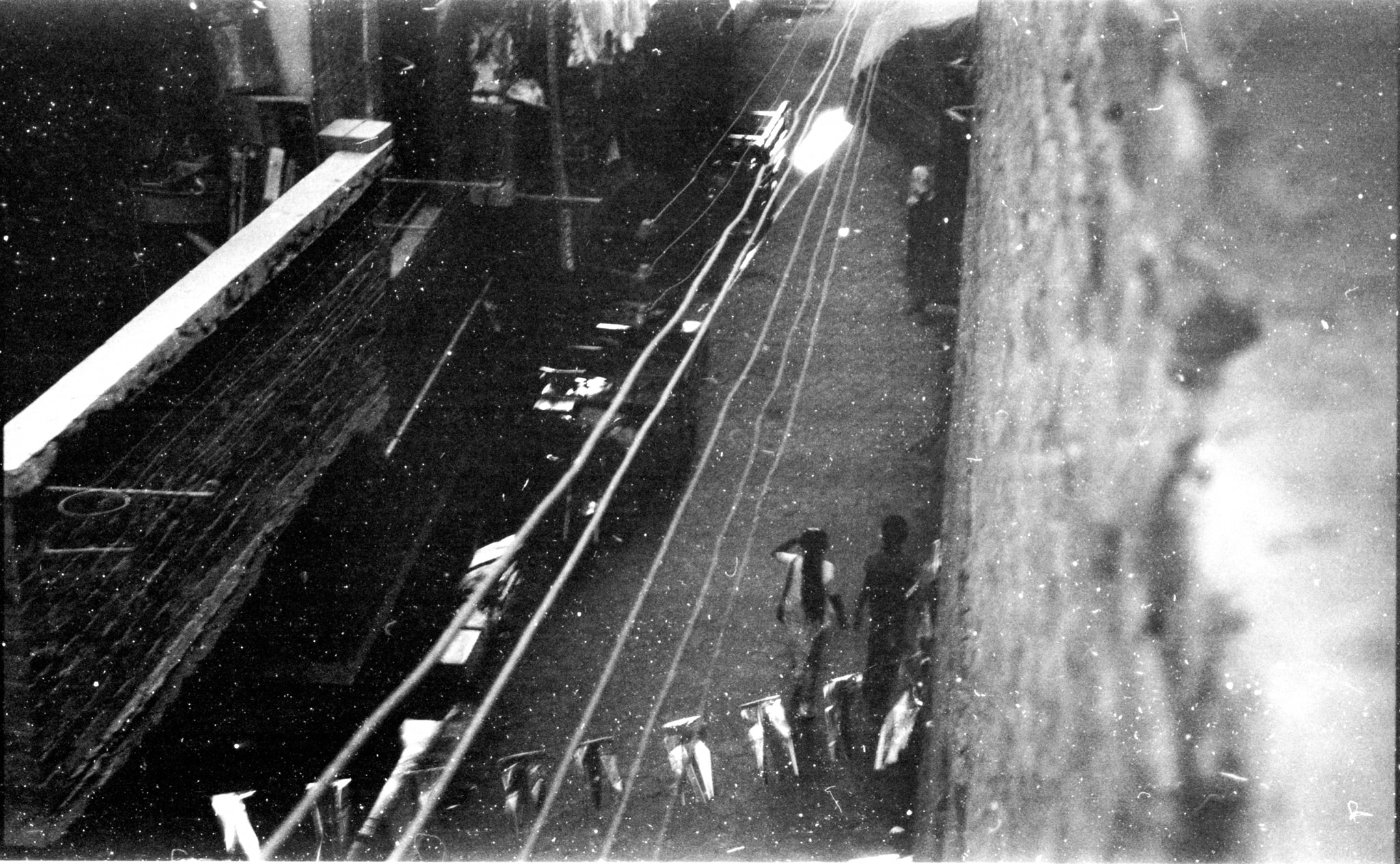

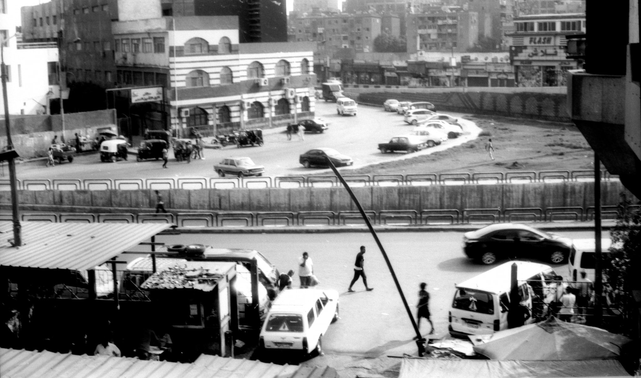

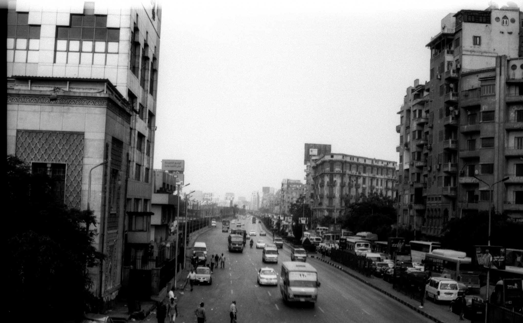

- This movie was filmed at ISO 12 and the lens aperture was 8 . the whole time
Canon EOS 500N
This film was developed using a developer (Kalogen) at a 1:50 dilution ratio for 13 minutes at 20°C.
- Is there any advice on this emulsion,
Are there any tips on how to get red and green .kind to be acceptable or something like that.
I thank you all in advance for your kindness,
God bless you

An ortho film will never record red well -- it's almost (if not completely) blind to light we'd call red. When introduced, a hundred years or so ago, orthochromatic films were a revolution because they'd record skin tones with a more natural look than the earlier blue-sensitive emulsions. Today, we're more accustomed to panchromatic films, and ortho is used for special effects (dark lips, for instance, in white-skinned portrait subjects). The main advantage it has is the ability to develop under red safelight, hence very easy developing by inspection (handy for wildly unpredictable exposure conditions). This also makes it handy for making interpositives and copy negatives from black and white materials.
Number one tip: avoid red filters. They'll give blank or nearly blank frames.

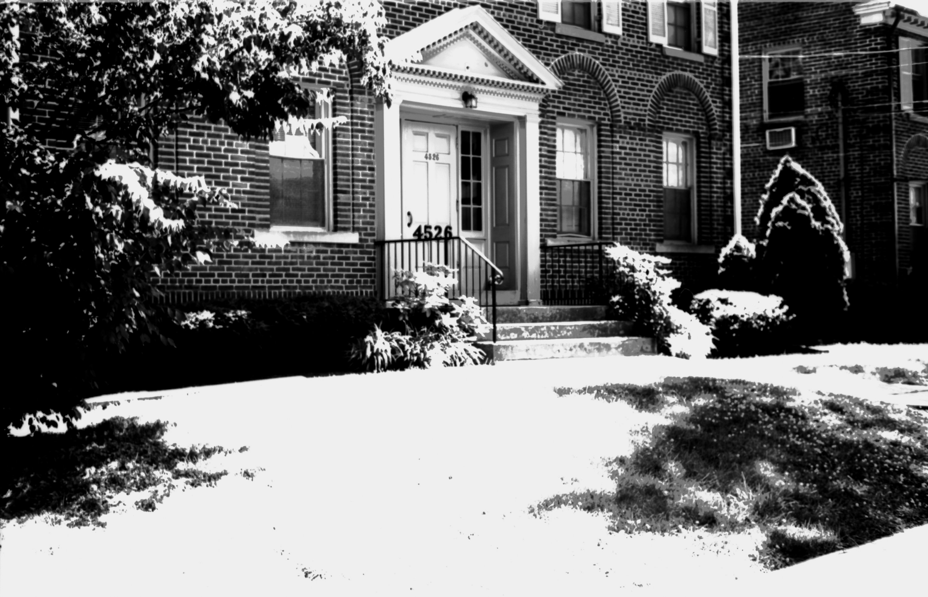

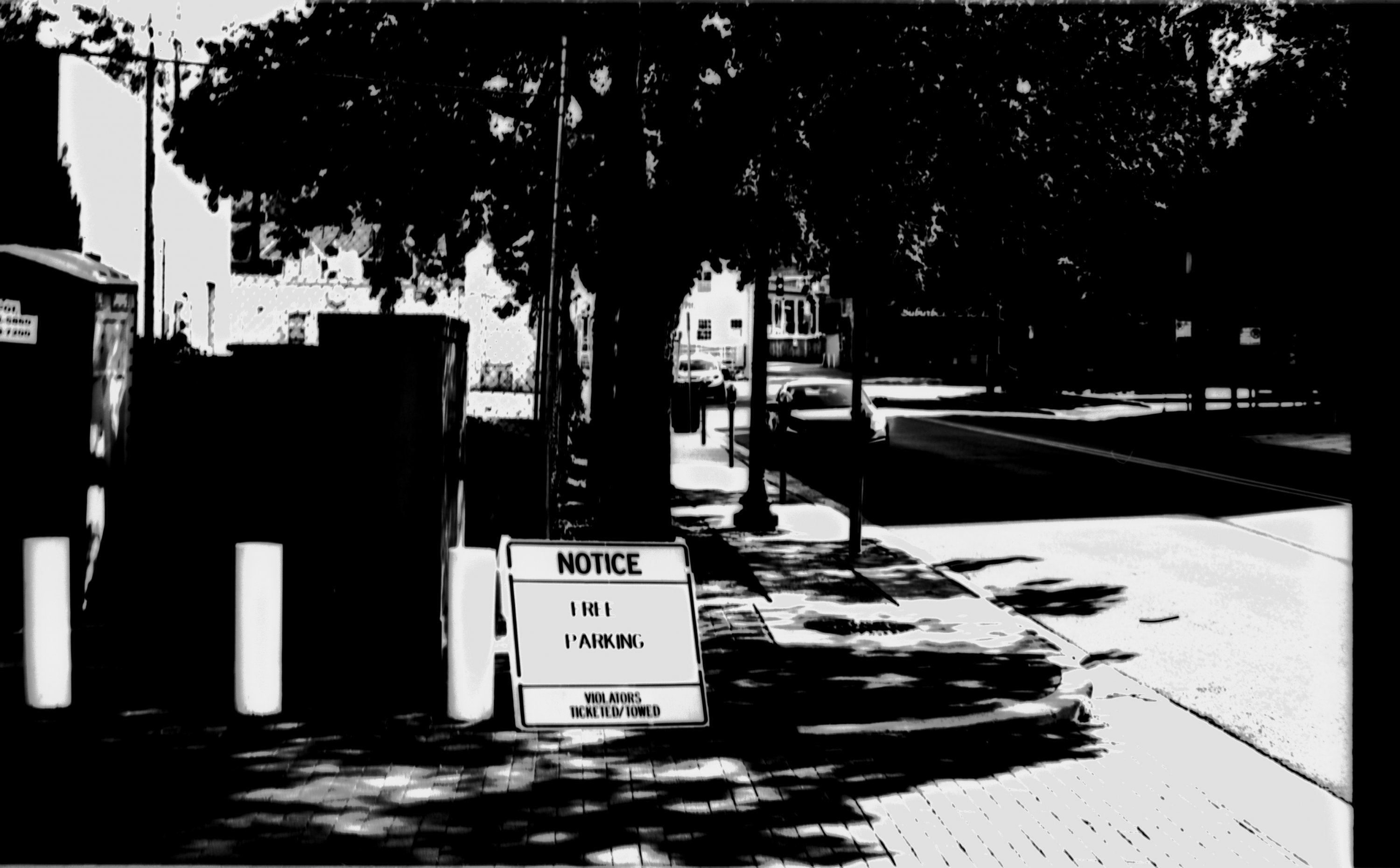

With Ortho films I find that subject selection is important. I tend to use it for a high contrast look. The skies will mostly be overexposed, reds will be black, and greens a bit stronger. Some people like it for landscapes. Also, the film you have sounds like Orwo TF12d which is sound recording film for movies. Not meant or balanced for pictorial use. I have attached a couple pictures I took with Kodak 2378 which is the Kodak equivalent to Orwo TF12d. I think Ortho films like are fun to shoot but I never expect a standard picture from them. I would set my expectations for what the film does and have fun.

But I had once read that maybe a yellow or orange or blue filter could be used, I don't remember, in order to try to make the film's sensitivity to red a little stronger so that it's a little semi-balanced,

A blue filter removes all red, yellow, and green -- you'll get effectively the same response you'd have with pre-ortho emulsions like wet plate collodion. A green, yellow, or orange removes most of the blue, giving effectively green-only sensitivity, which can be useful for certain effects in landscape photography (lightens foliage while darkening sky), but orange and red also remove much of the green, which reduces effective film speed without much if any gain.
I'd tend to use blue and green filters, if any, with ortho film. I'd avoid orange and red, and yellow is effectively the same as green on ortho film.
Does this mean that using a blue filter is the best of the bad choices?
It means that a blue filter will come closest to what you'd get with panchromatic film (because you're essentially eliminating all the sensitivity that makes these films different from pre-1880 emulsions). I can't say "best" because that depends very much on what you're after.
You can think of ortho film as having a built-in "minus-red" filter -- so any actual filter you use will be as if you installed it with a minus-red.

I wanted advice on trying to take pictures with this film so that we can get fairly balanced results that are close to (PAN) film, I don't want green or light brown eyes to be photographed as black. And I don't want my lips to get too dark.
