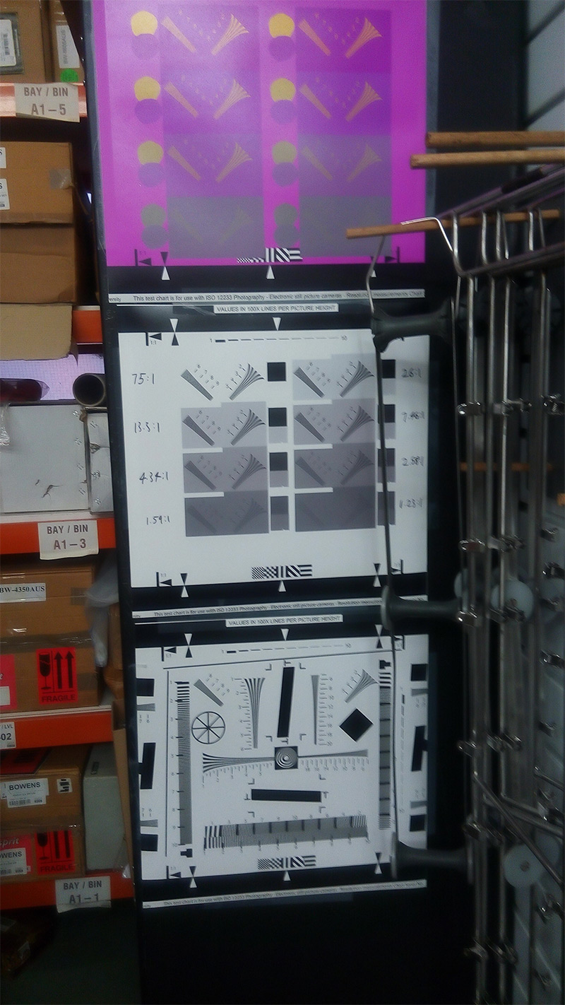

Second question, if I may. Where did you get your resolution target? It's a dandy.
Modified and printed my own from http://www.graphics.cornell.edu/~westin/misc/ISO_12233-reschart.pdf
It's vector so you can import any resolution into photoshop etc, and I set the black to full black.
Here's my modifications, made my own contrast based one, and colour/saturation based one

Dan, thanks for the reference. I have the Edmond Scientific metal on glass charts plus a set from my EK days. I'll have to give this a try.
