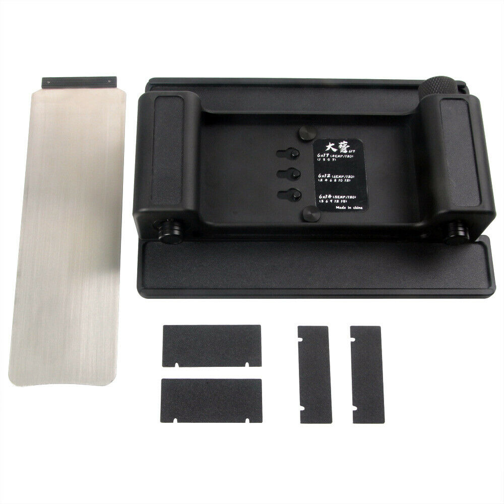

Hello everyone,
I hope the collective knowledge can help me out.
I bought a 6x17 adapter for my 5x7 Sinar P back. (similar to the one in the picture)
When i got it in the mail, i realised that my Sinar P 5x7 doesn't have a graflok back. Only my 4x5 is graflok...
Do you know which cameras have one, so i can play with my 6x17?
Field cameras would be nicer to carry around than my hefty Sinar P...
Worst case, do you know if there are any schematics so i can 3D print / manufacture a 5x7 graflok for my Sinar?
Thank you very much!
Claudiu.

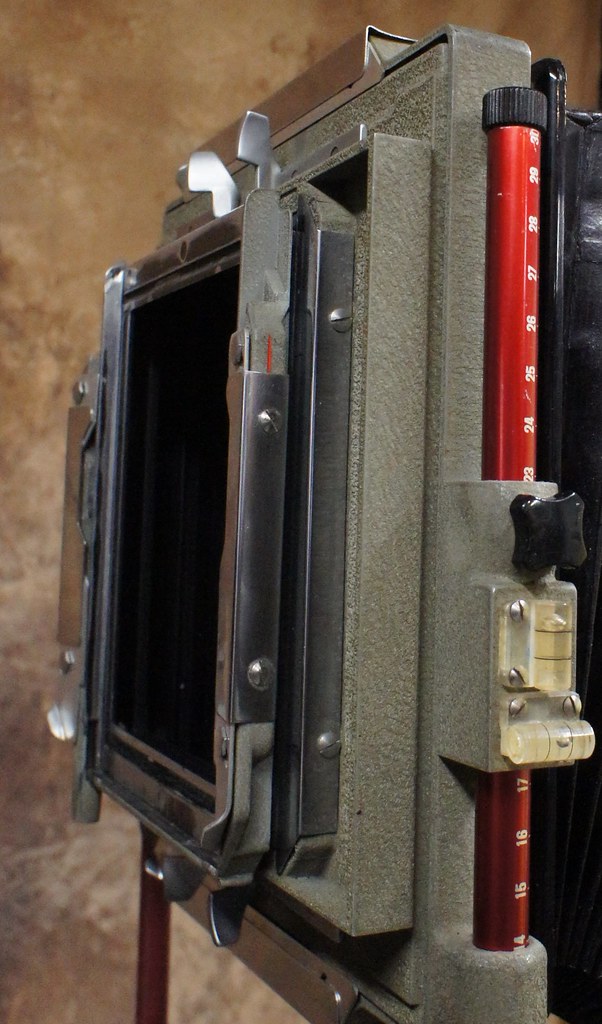

SONY DSC by Nokton48, on Flickr
I can use a 4x5 Graflock Back on my Old Normas by using the 5x7 to 4x5 Reducing Back. I'm sure they made a more modern version for the "P" also.
You could attach your 6x7 back to the 5x7 Reducing Back (just use the frame) with a bit of metalworking

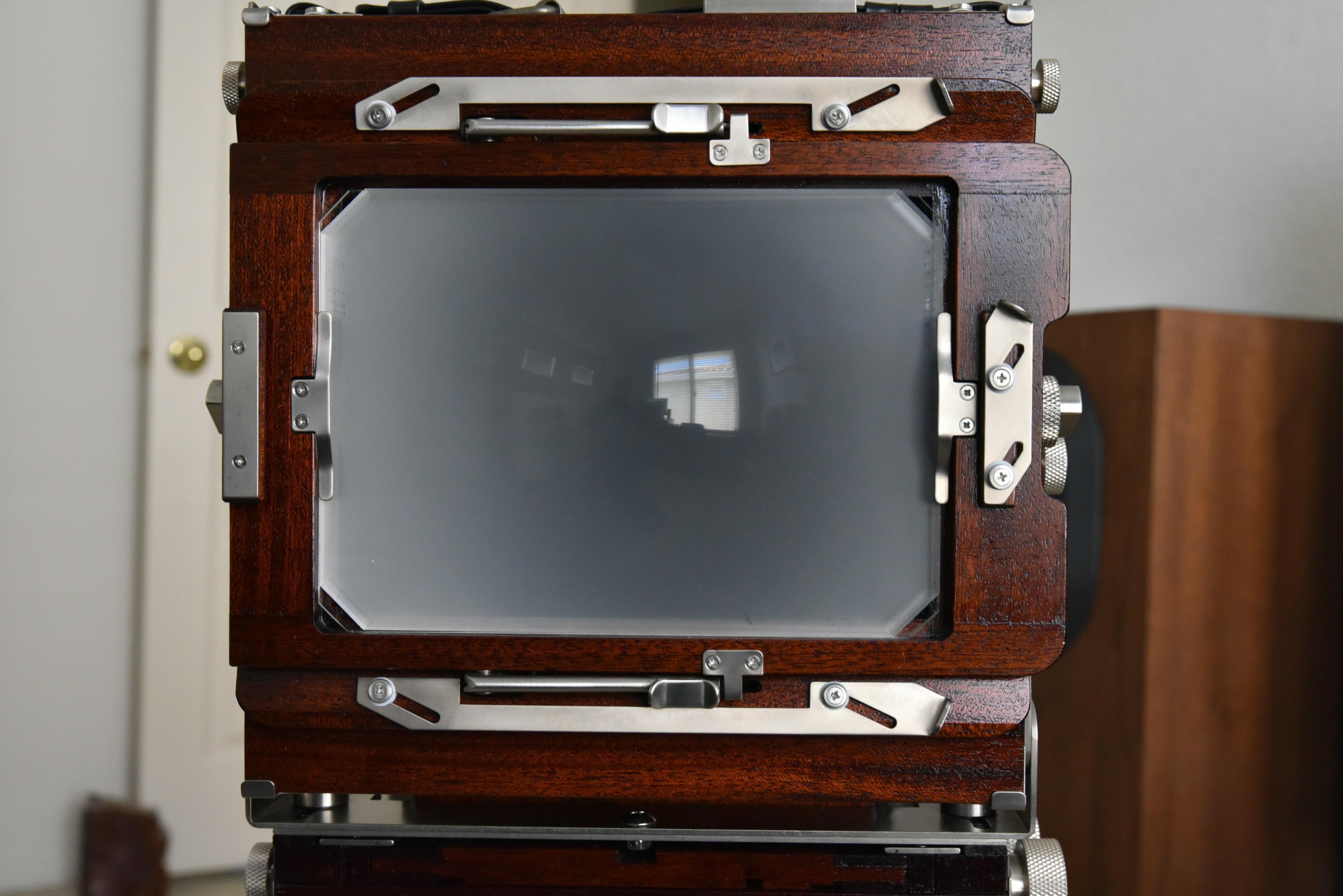

The Walker Titan XL 5x7 has the little wings to hold your 6x17 roll film holder....and Mike makes excellent cameras. The description explicitly states that the back was designed to accommodate the Canham 6x17 back. See the link below...
http://walkercameras.com/XL5x7.html
Can't you just switch out your 5x7 back for the 4x5 reducing back, just like Nokton posted? Norma version, P, F... they're all interchangeable. It takes less than half a minute to switch them. No need to go scouting around for a whole new system.
The OP has and wants to use a 6x17 roll film back and therefore needs a 5x7.
Makes no difference. You just carry along a Sinar 5X7 to 4x5 reducing back too. No big deal. Just one more accessory. They already had this figured out more than half a century ago. If a 6x7, 6x9, or 6X12 roll film image is in mind, rather than full 4x5 sheet film, you just use the appropriate roll film holder with an appropriate 4x5 retainer, intended for Graflok fit. Going back and forth between formats is easy.

The Shen Hao HZX57-IIA or one of their other 5x7 field cameras might also have the little slider thingies. I notice from their (really awful) website that they sell a 6x17 roll film holder "for 5x7 cameras".
Shen Hao's really awful website shows all three 5x7 models have sliders that look like they provide something resembling graflok function.
The 5x7 back for the Chamonix H-1 has a removable ground glass and sliders to retain another back—presumably a 6x17. The dimensions of the recess in the back are 150mm x 195mm.
