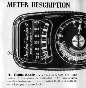

No matter… conversion of units isn’t exactly a black art. :smile:
But I’m pretty sure that Weston III, at least, reads in Cd/sqFt. Ironically… the manual doesn’t state what the units are. Nor does the Weston IV manual.
the Weston V manual has a procedure any table for conversion between units. (Page 23).
update…. The Weston Master II manual specifies, on page 1, “candles per square foot”.

sigh.
In 1941, AA would have been using a Master II... wouldn't you agree? I cited the manual.
Weston was quite consistent in this regard... even with their truncation of the numbers!

The scales on the Weston Master II actually read in foot candles per square foot (a measure of luminance), not foot candles (a measure of light source intensity). There is a conversion utility built into the dial which allows you to take incident readings and convert the foot candles per square foot readings into foot candles. The Ollinger description mis-speaks, because foot candles makes no sense in a reflected light meter.

If there is a conversion on the dial I'm not aware of it. Would love to learn something new about these old meters, though. (I still use my Weston IIIs on a regular basis.) I know in the Master V manual there is a conversion table, which was not in the prior versions.
That is correct but AA in his book often called the unit Foot Candle which is the incorrect term.
That illustration of the manual is convincing, candles/square foot. Information I previously used was provided in http://www.jollinger.com/photo/meters/other/weston-article.html
" On the Universal the ranges are Low: 2 to 50, High: 25 to 1,600 foot candles." appears to have gotten units wrong.
This article identifies the confusion and inconsistency. https://www.westonmeters.info/light-units
"Weston light meters, including the luminance as well as exposure meters, are not consistent in the units that appear at the end of the needle pointer when it moves in response to the light. Once you attempt to compare one meter model with another it gets confusing. Indeed, even within one model - such as the S85 - the units can differ. So what do there different units spread across the scale amount to?
"I have made some attempt here to understand and explain them (with the help of Wikipedia). I hope I've got it right. If any reader of this page can contribute to or correct the information, I would appreciate it. - So here goes:
"Although not actually mentioned on the majority of Weston exposure meters, the unit in most common use is candles per square foot, or Candles/Ftsq. This is NOT the same as foot-candles although the simple relationship between the two terms means that a Weston meter can be used to convert between them. Early Weston light meters call this 'Light Values'. On the Master series, just the term 'Light' is most commonly used."
Yet an illustration of two luminance meters shows very clearly Footcandles on the dialface of models 703 and S85.
Apologies for the earlier contradiction, Brian. All prior posts claiming foot-candles have noted retraction.
But given that these were not narrow angle spotmeters, how did AA get a reading of 250 c/ft2 ?!

No problem. None at all. I noticed that it is incorrect on that site (jollinger) and correct in another paragraph.
