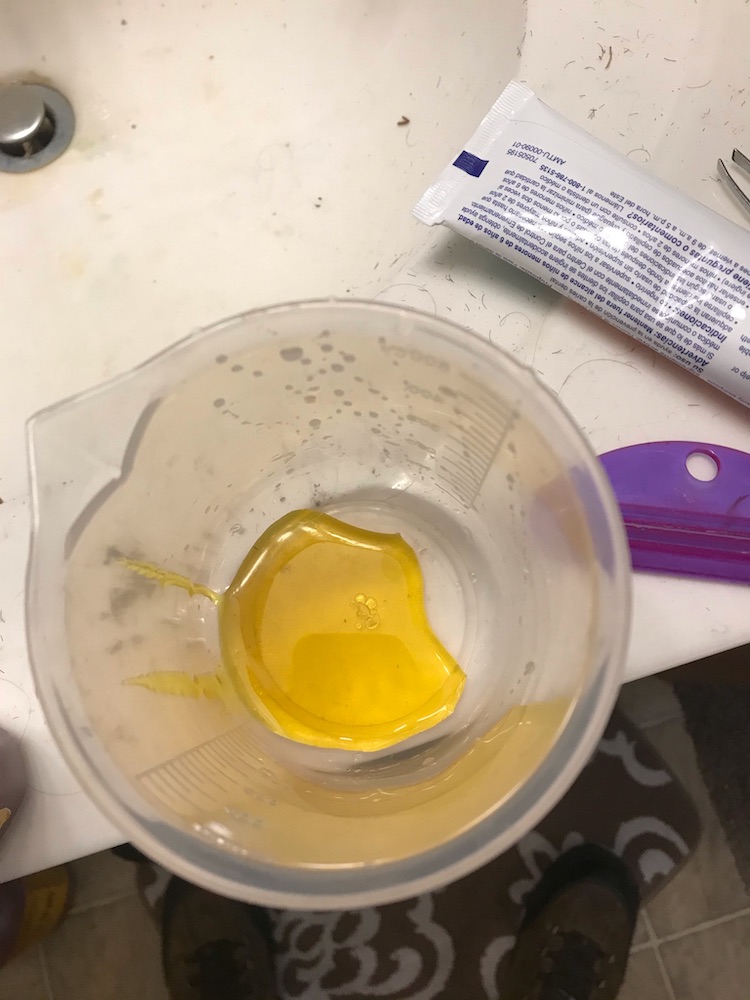

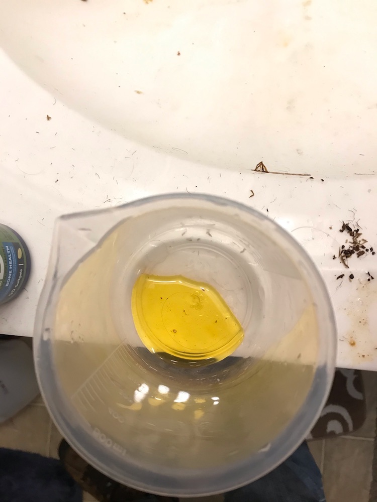

They're kind of a light yellow, like corn syrup. but holding the bottles up to the light they're a bit amber colored, though the circular one is certainly lighter. no dates on either.

here they both are.
the circular one has debris in it too.

Those look fine -- like I said, near the color of corn oil. Yellower than corn syrup (my recollection is regular Karo is almost water clear).
The debris shouldn't cause trouble; if there's enough to notice after mixing you could pour the working solution through a filter or fine screen (might not be a bad idea to just get in the habit with that bottle of syrup).
