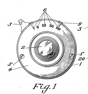

Yours looks like this, which is one of two variations of the shutters in the base patent filed in like 1916 iirc

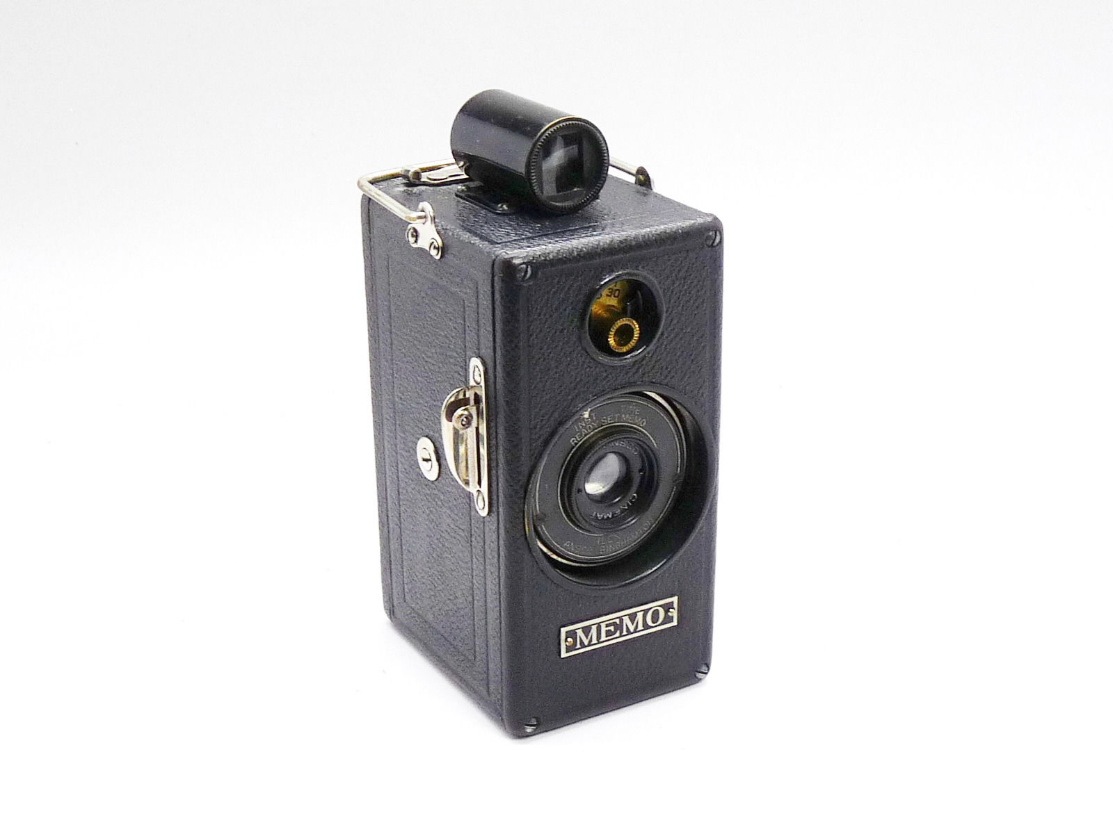

The standard issue memo shutter looks like this.
The writing under the shutter speeds changes depending on what lens you get, my standard model 1927 series II serial 4xxx memo has Ansco Memo written there, but my later memo with a focusing B&L antistigmat lens has "Deltax No0" written there instead. Unfortunately, the focusing memo works only on bulb.

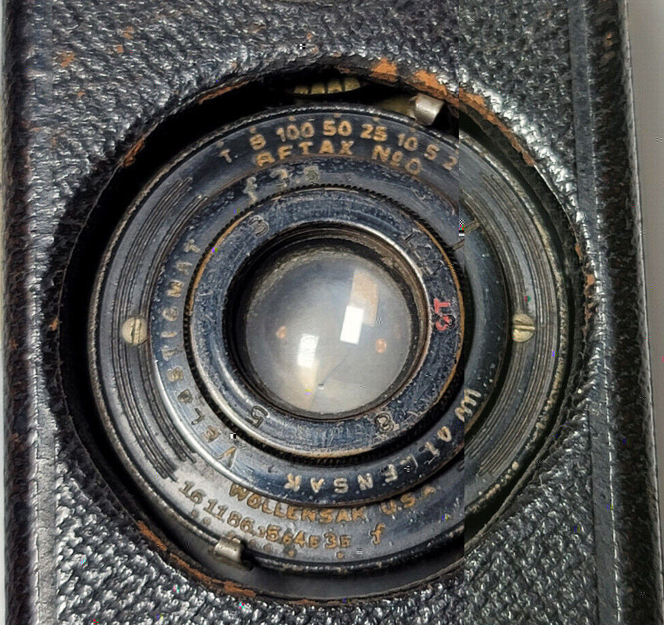

This is probably the most expensive model Memo, because it is F3.5. it also has Betax No.0 written there instead of Ansco Memo.
