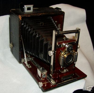

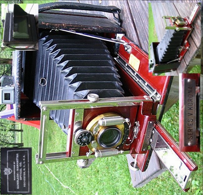

After playing with it and examining it, this camera is a real Frankenstein camera. The lens is at infinity focus when the front standard is almost off the back side of the focus bed rails and the pointer is no where near the hand-made focus scale. It suggests that a longer focal length lens was on this camera in the past. The current lens is about a 5 inch Wollensak (with Anthony Scovil and Ansco stamped on it) in a pneumatic shutter and the handmade focus scale suggests at least a 6 or 7 inch lens was on this camera at one time.
A neat feature is the back that automatically extends to the rear about 1/2 inch to allow slight tilts but no swings on the back.
The Graflex viewfinder appears to have no relation to the current lens what so ever, but it does appear to have the proper 3 1/4 x 4 1/4 mask inserted.
The bed has an amazing potential to extend, but the bellows stops short of going out the last bit of the rail, as seen in the photos.
I am beginning to suspect that 3 or 4 cameras were cobbled together to make this camera.
Anyway, its a nice looking camera and it will make a good display unit if I can't find film holders and get it operational.
Frank

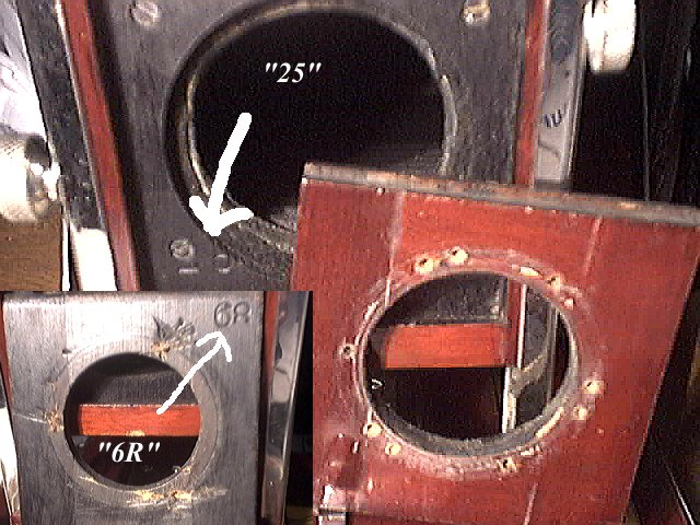

Doh. OK there you go -- push UP. See pix (again sorry for crappy web cam). Looks like this camera has had a LOT of various lenses in its life. The board inside the standard has what appears to be a "25" stamped on it but the lens board has a "6R", or now I am thinking, a "68" stamped on it and lots of gouges and tears from mounting and unmounting lenses.
You could knock an eagle out of the sky with that Wollensak lens and pneumatic shutter! It is quite substantial...
