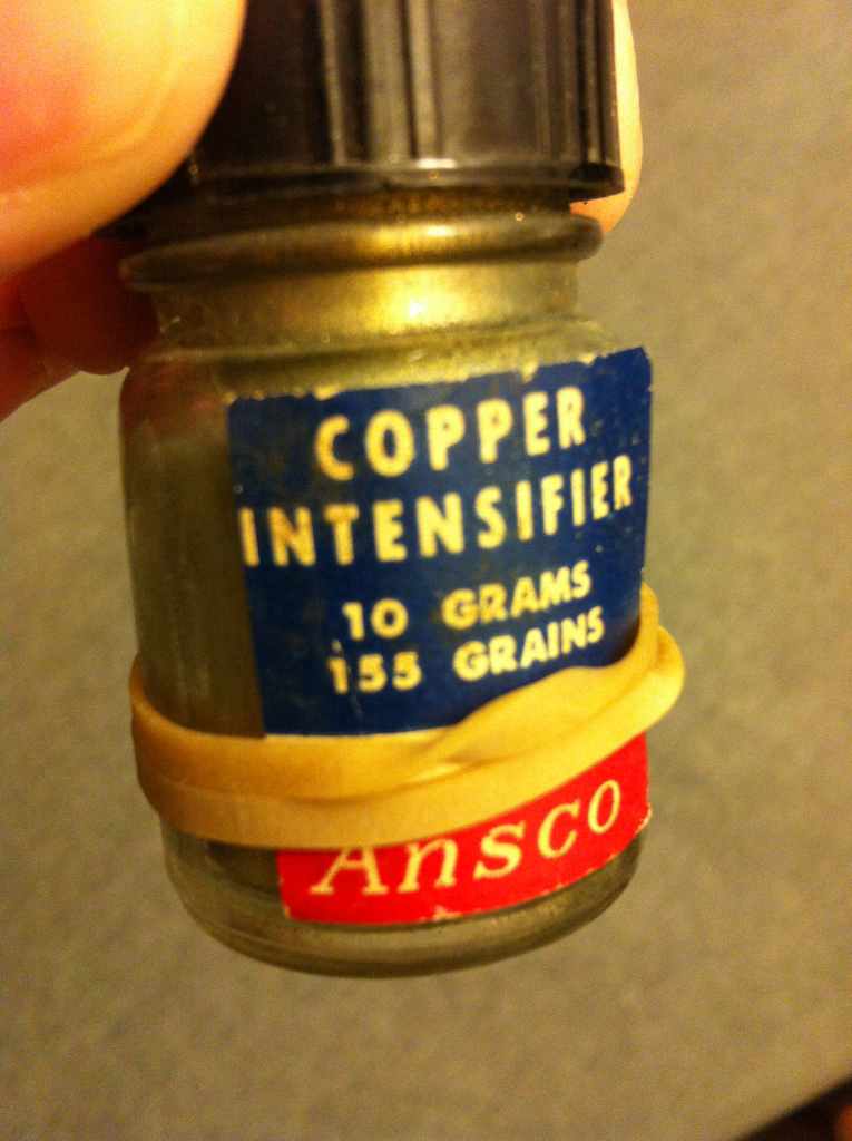

Hey guys.
A neighbor who passed away left me this bottle...
Is it any good?
I know (sort of) what it does but what kinds of processing dilutions and instructions are there? I can't find anything clear by google.
Thanks!
~Stone

It probably works similarly to chromium intensifier. Do a search on that. Not sure how well it would hold up after a lot of years, but worth a shot on a reject, thin, negative (if you want to see if it works). If I recall correctly, you'll need to bleach it first, and redevelop in a paper developer (Dektol works). More difficult on negatives that used a hardening fixer. Others with more recent experience (or better memories) may be of more help.

Copper toner is a very popular and effective way of getting brown to red-brown tones. Your bottle is small, so it probably doesn't make much, maybe 500 ml (read the instructions on the bottle). The components of copper toners are long lived - copper sulfate, citrate, potassium ferricyanide, maybe ammonium carbonate, maybe something else - so the old bottle may still be good. Copper toner is a direct toner, somewhat related to the iron blue toners. The image is copper ferrocyanide (I think), which is long lasting but not indefinitely stable.

I'm getting a lot of mixed messages.
To respond, the bottle doesn't have any instructions, as you can see the label is only held on by the elastic band and it's just the label, there are no instructions on the back.
It seems this can be used on both film and paper? but then staining is mentioned in the comments, is that referring to just with paper? as staining a negative would just cause it to have "fogging" issues no?
Unstable seems to be mentioned a lot as well, does this mean it's sort of no good to use because I'll have some image failure after a brief time and have blank negatives if I use it?
Is it used mostly with already developed films that need intensification, or with adding it to the development step to give some effect, or should I just wait until I do my own printing and use it for that purpose?
That article sort of was beyond me, it wasn't very clear to me in that I don't mix my own chems so I don't know what the other components mentioned are for or even where to obtain them and the article sort of lost me in describing the color, are they talking about the color of the solution or the film staining or what?
Plates are also mentioned, so is this for wet plate work?
Sorry it's just a little bit confusing for me, as I said I don't mix my own chems, I buy store bought stuff like Rodinal, and I don't do wet plate nor my own printing YET so should I just save it for that time and then re-visit this? Or is there some advantage to normal B&W negatives?
Thanks guys!
